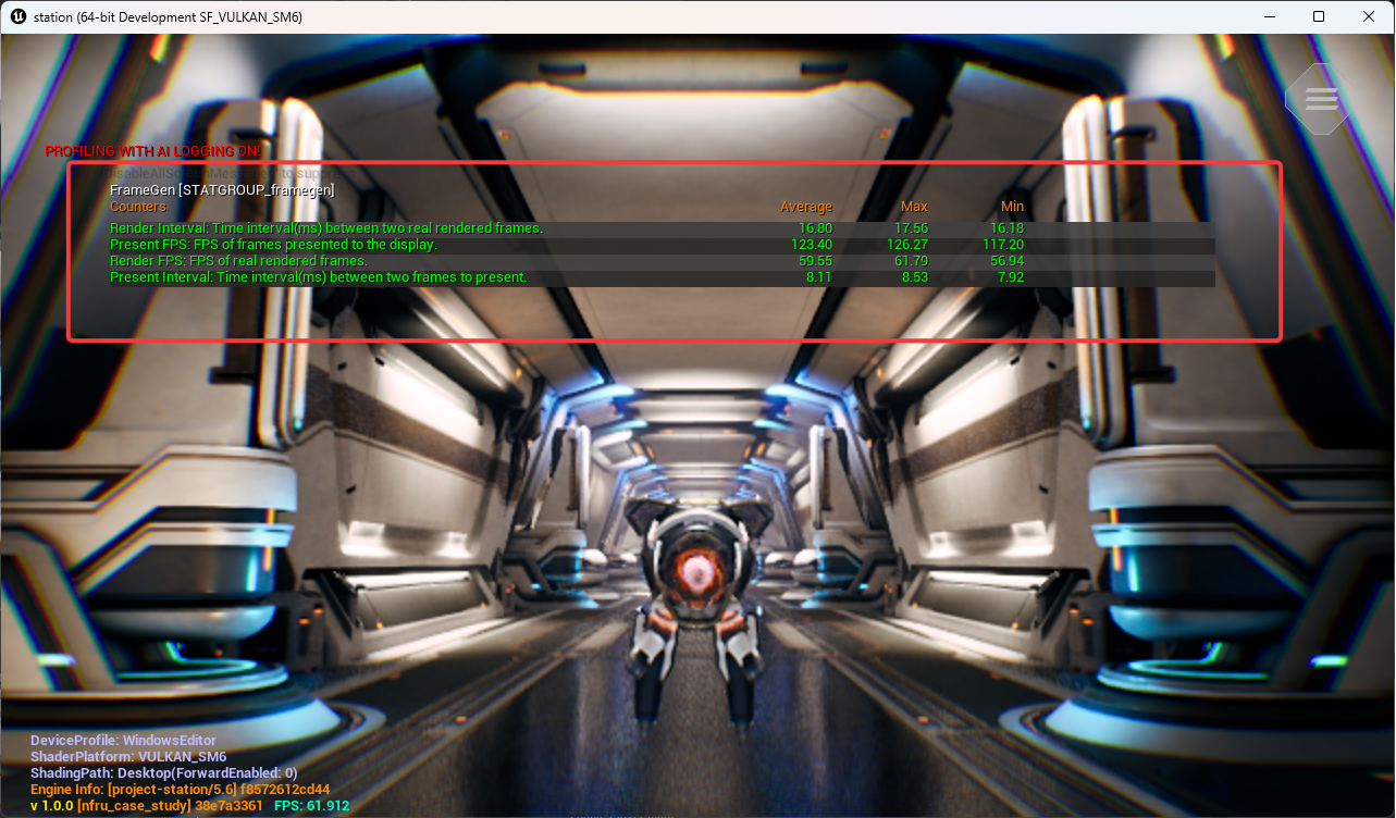

To monitor NFRU performance in real-time, use the console command:
stat framegen
This command displays four key counters that provide insights into NFRU operation:
Image Alt Text:Unreal stat framegen overlay showing render FPS, present FPS, render interval, and present interval for NFRU performance analysis
There are two FPS values to distinguish:
MetricMeaning
Render FPSReal frames produced by the engine
Present FPSFrames shown to the display, including generated frames
Render IntervalTime between real rendered frames
Present IntervalTime between displayed frames
Consider the following example values:
Render FPS       = 30 FPS
Render interval  = 33.3 ms
Present FPS      = 60 FPS
Present interval = 16.6 ms
With one generated frame between two real frames, the display can receive frames twice as often.

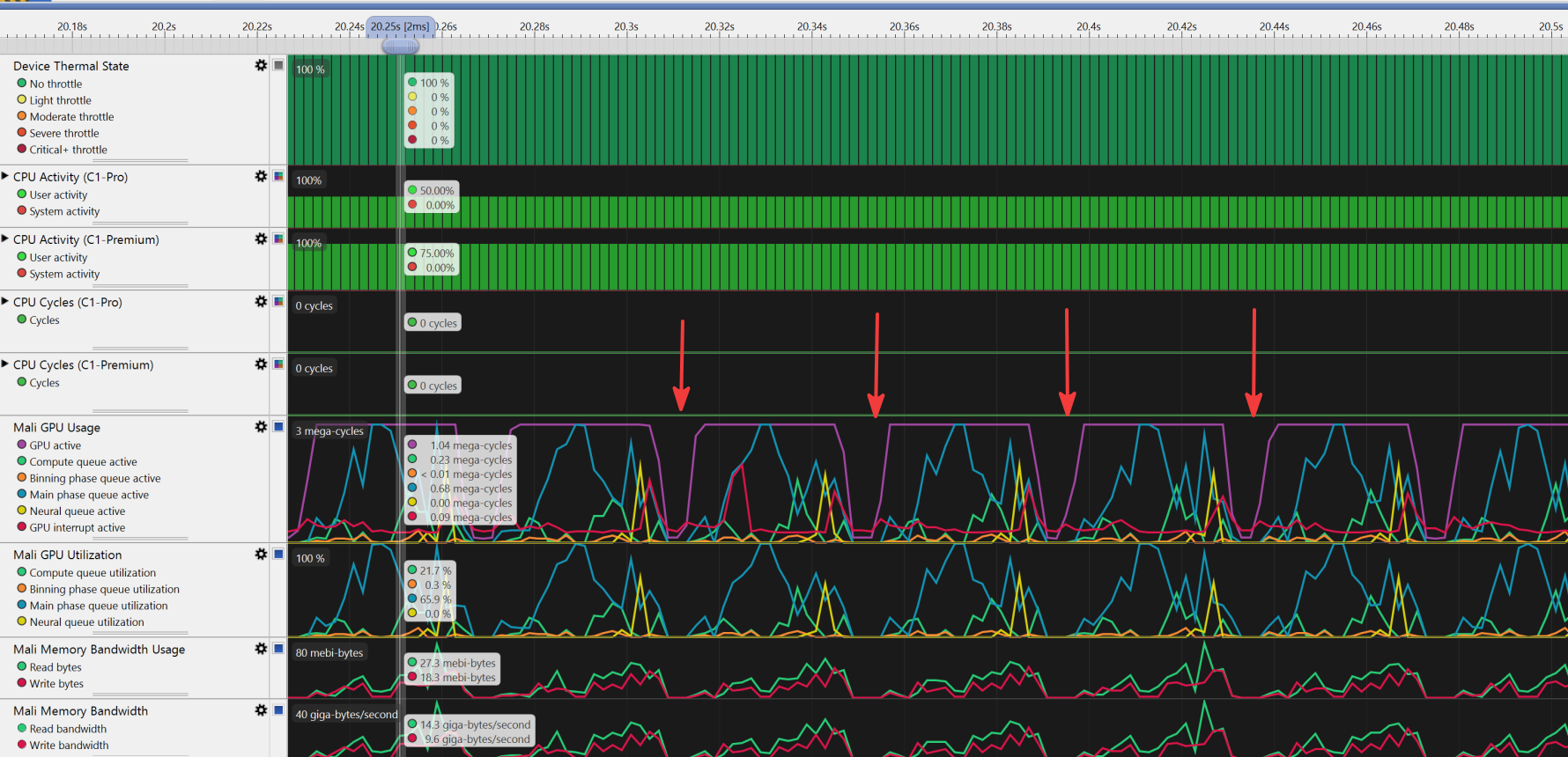

Frame pacing behavior and GPU idle time
In Streamline captures, frame-pacing waits often appear as gaps between GPU workloads. These gaps can happen when real rendered frames are produced unevenly. The pacing system waits before submitting or presenting the next real or generated frame to keep the output aligned with the target cadence.
During that wait, the GPU might be idle:
Image Alt Text:Streamline capture showing GPU idle gaps caused by frame-pacing waits, which can limit present FPS despite available capacity
These idle gaps are important to identify because they can indicate that presentation timing, rather than pure render cost, is limiting the observed FPS uplift:
  • GPU idle time: The GPU has no queued work while the pacing system waits for the next frame timing slot.
  • Lower measured throughput: Present FPS might be limited by pacing or display timing even when the GPU has spare capacity.
  • Uneven workload distribution: Bursts of rendering work followed by idle gaps can make frame delivery harder to interpret in profiling captures.
  • Power behavior changes: Idle periods might reduce instantaneous GPU activity, while bursts can still create short load spikes.
Proper frame pacing keeps presentation intervals stable, but it can intentionally introduce waiting. For profiling, distinguish between idle time caused by pacing and idle time caused by missing render work or synchronization problems.

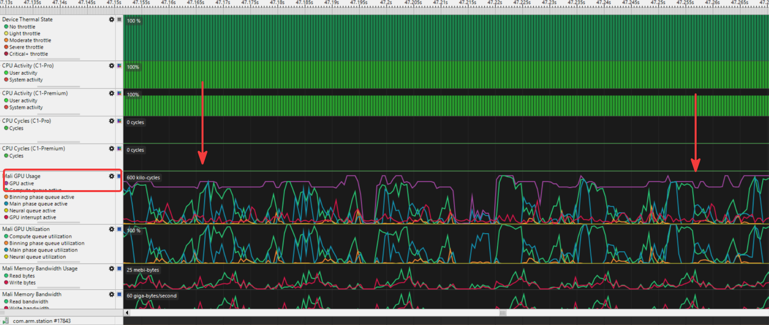

Remove common pacing limits for profiling
When you want to measure the maximum present FPS that NFRU can reach, disable the pacing systems that might cap or smooth presentation timing. Use this setup for profiling and investigation only. For normal gameplay testing, frame pacing is still important because it keeps presentation intervals stable and reduces visible stutter.
The capture shows a frame-pacing issue where a large idle gap appears before the next submitted frame. Removing pacing caps can help you check whether the workload can produce higher present FPS when the platform isn’t intentionally delaying presentation.
Image Alt Text:Streamline capture showing a frame-pacing gap with GPU idle time before the next submitted frame, highlighting why pacing caps can limit measured present FPSFrame-pacing gap before the next submitted frame
