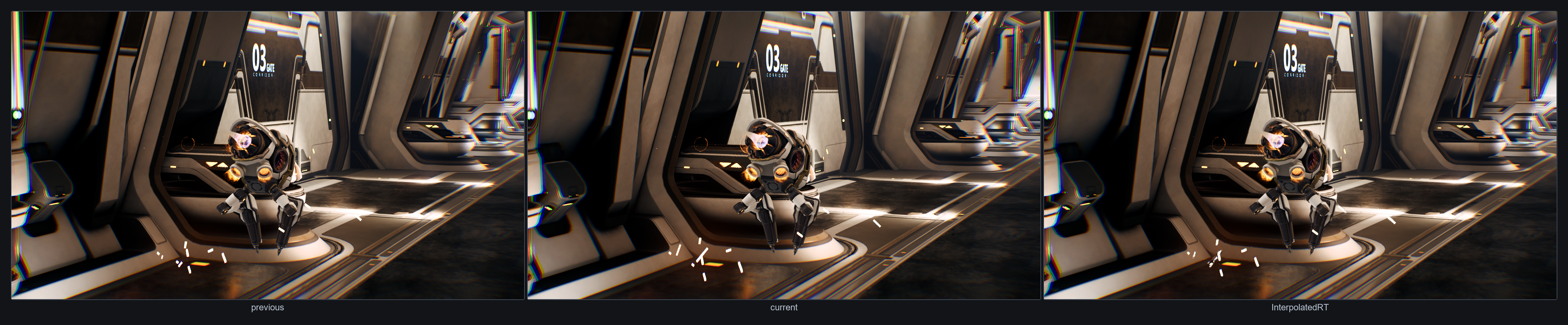

Compare the previous frame, current frame, and InterpolatedRT to find whether the generated frame preserves the particle shape and position.
Particle comparison across previous, current, and interpolated frames

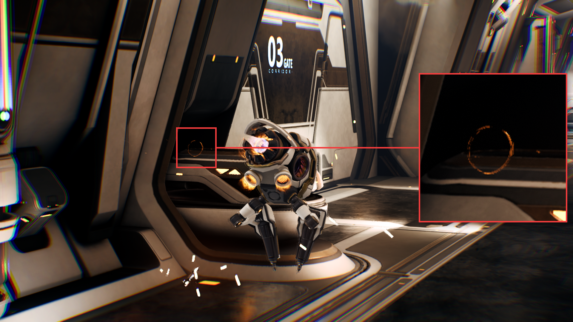

- Blur or smear: The particle color is warped using an estimated motion that doesn’t match the actual particle movement, especially for smoke, sparks, fire, or trails.
- Disappear or flicker: Particles that fade in or out, spawn, die, or change opacity between real frames might not have a stable match, so the generated frame might reduce or drop them.

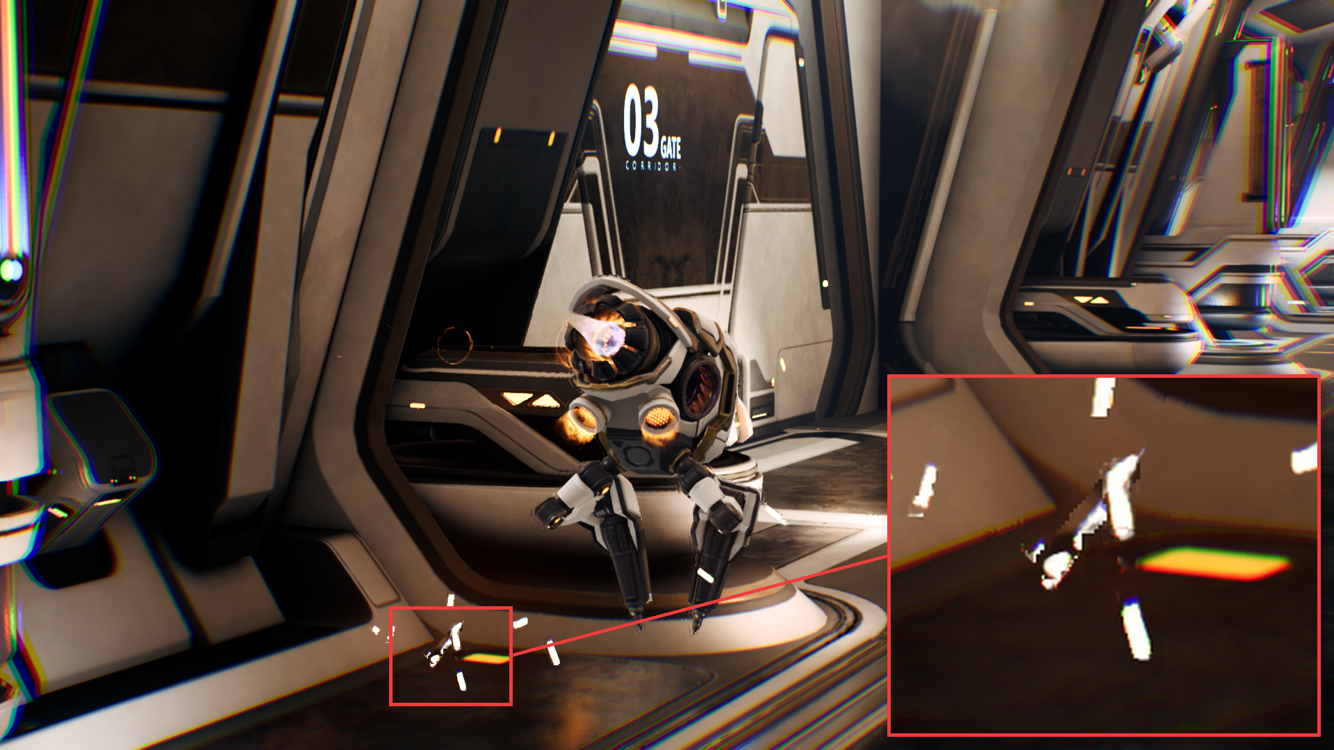

- Distortion: Optical flow might interpret changing shape, additive brightness, or overlapping particles as motion, producing stretched, bent, or duplicated particle regions.
The highlighted blur area shows a particle ring that loses definition in the generated frame. Look for soft edges, smeared color, or a shape that no longer matches either source frame.
Blur artifact in alpha-blended particles
The distortion callout shows particles that bend or stretch after interpolation. This usually means the generated frame is using an unreliable motion estimate for small, bright, fast-changing particle elements.
Distortion artifact in particles

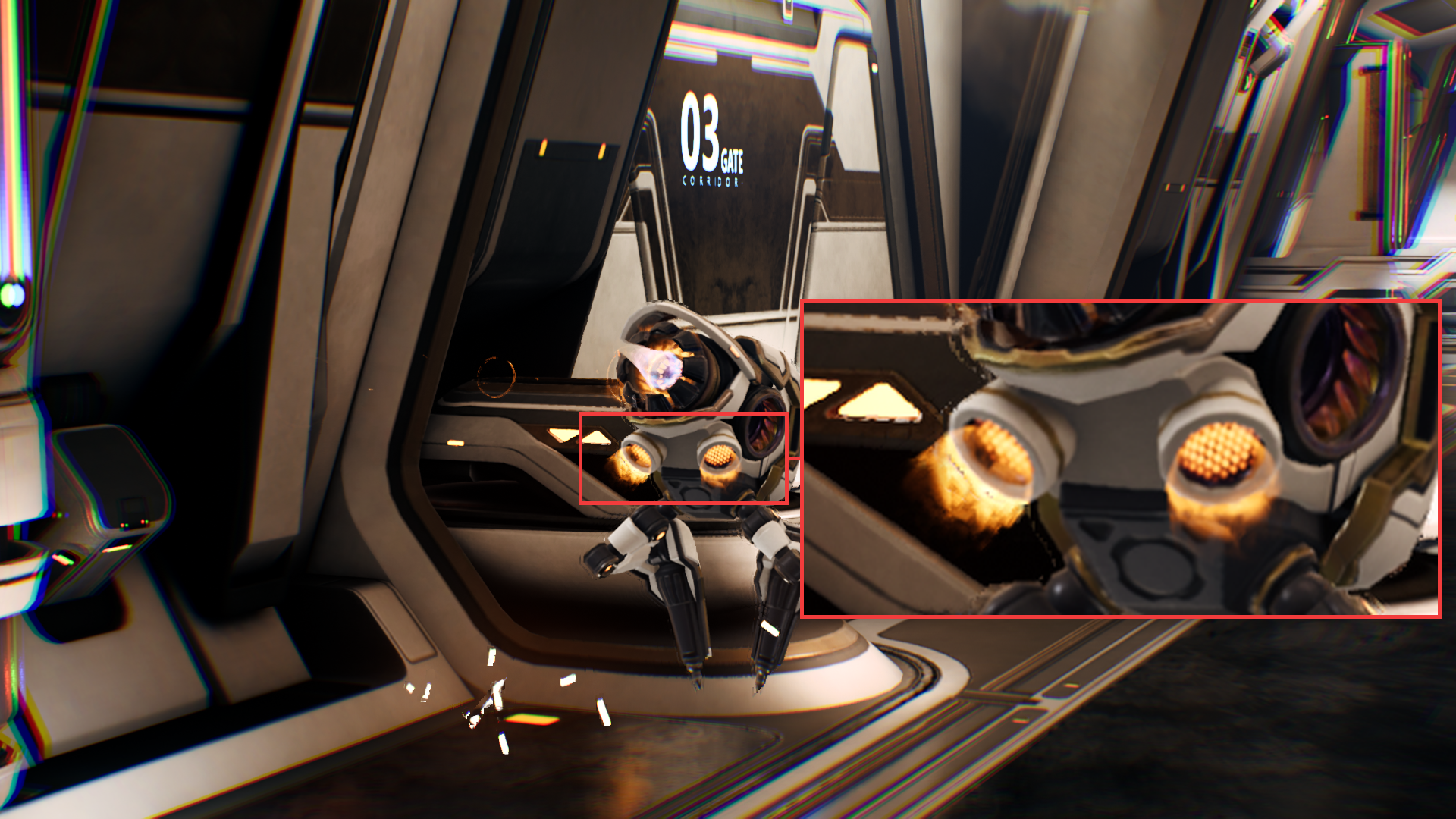

Some particle effects, such as fire, sparks, and smoke, already have random shapes from frame to frame. In those cases, the generated frame can look natural even if it doesn’t match a physically exact intermediate shape. The result is usually acceptable when the particle keeps the expected color, brightness, and approximate location during playback.
The highlighted thruster fire shows a generated particle result that still reads naturally because the effect is noisy, soft-edged, and expected to change shape quickly.
Natural-looking generated fire particles
