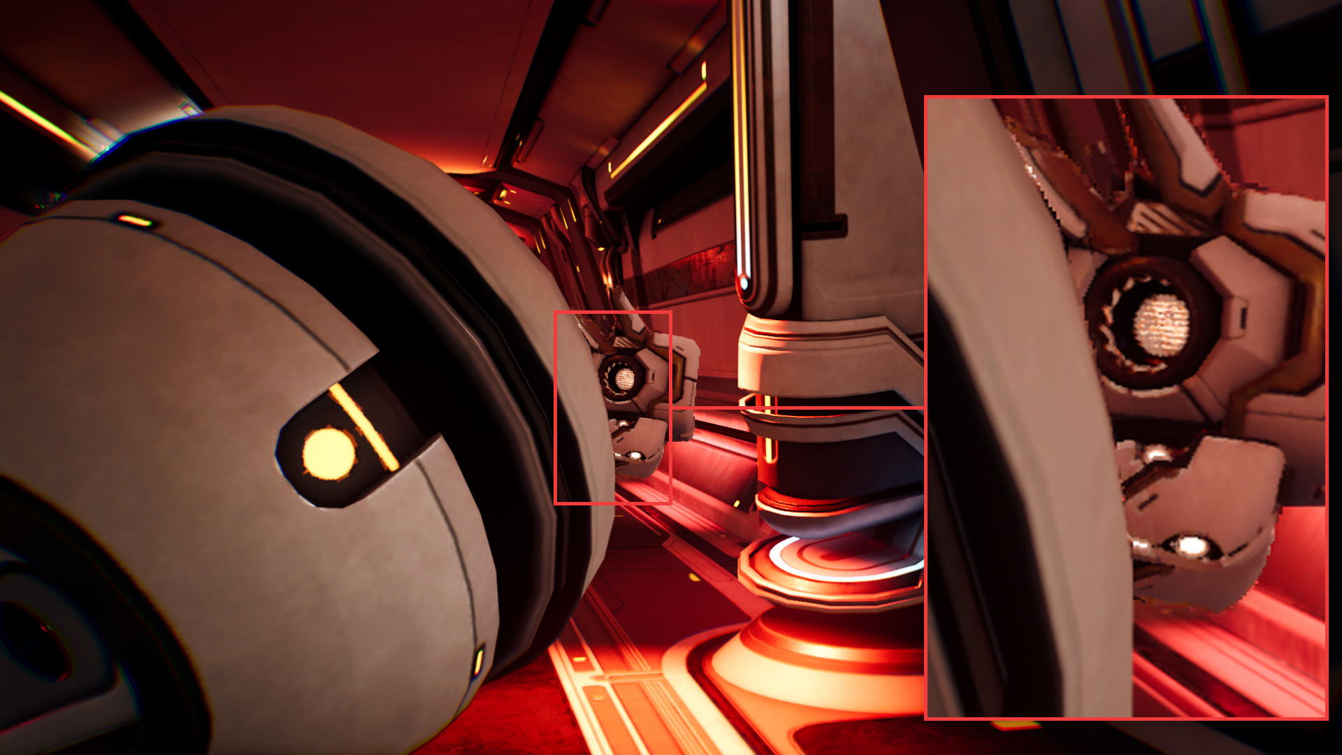

Analyze occlusion-in artifacts

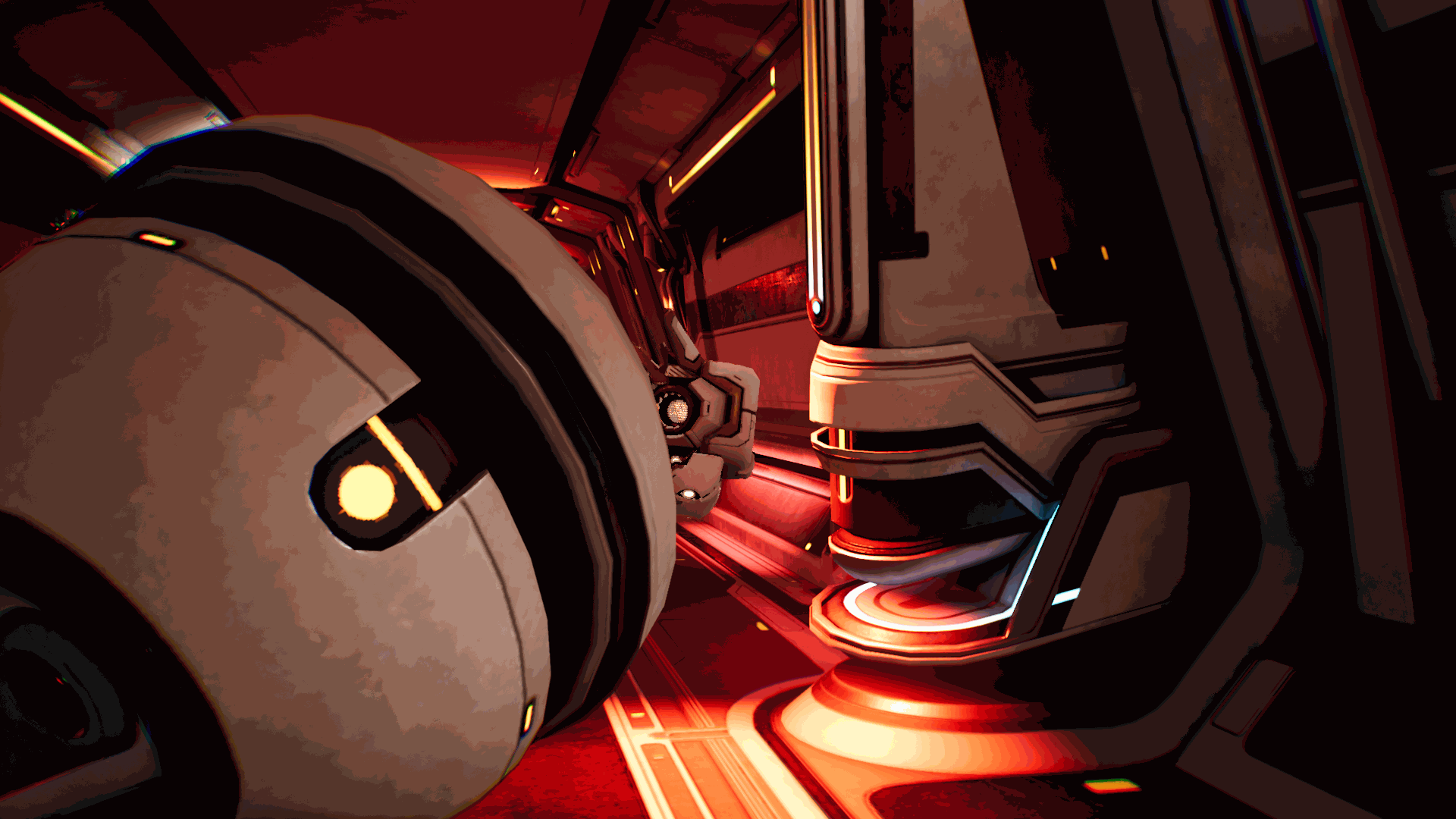

The occlusion-in generation sequence shows how the previous and current interpolation sources combine into InterpolatedRT as the foreground object covers the background.
Occlusion-in interpolation sequence

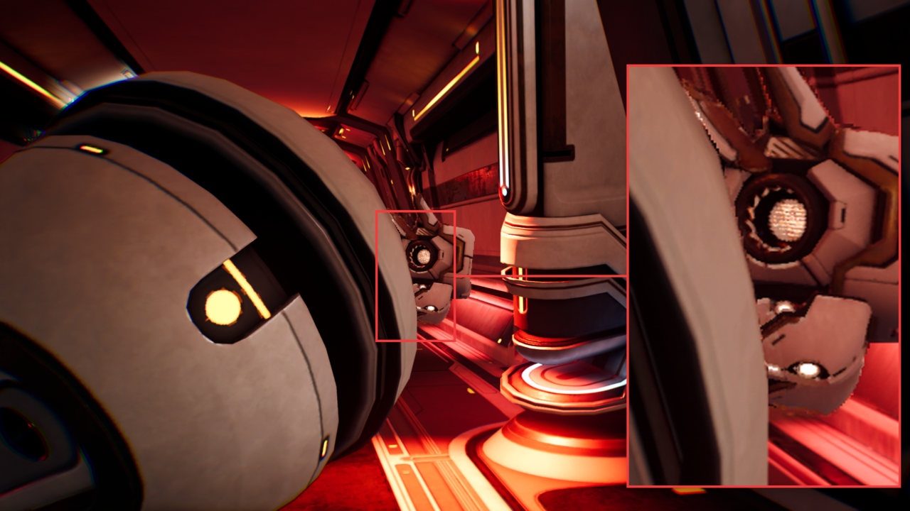

The marked close-up highlights a small boundary artifact in the generated frame. The main occluded area remains stable, while the visible issue is limited to slight blending and softness along the foreground edge.
Marked occlusion-in artifact

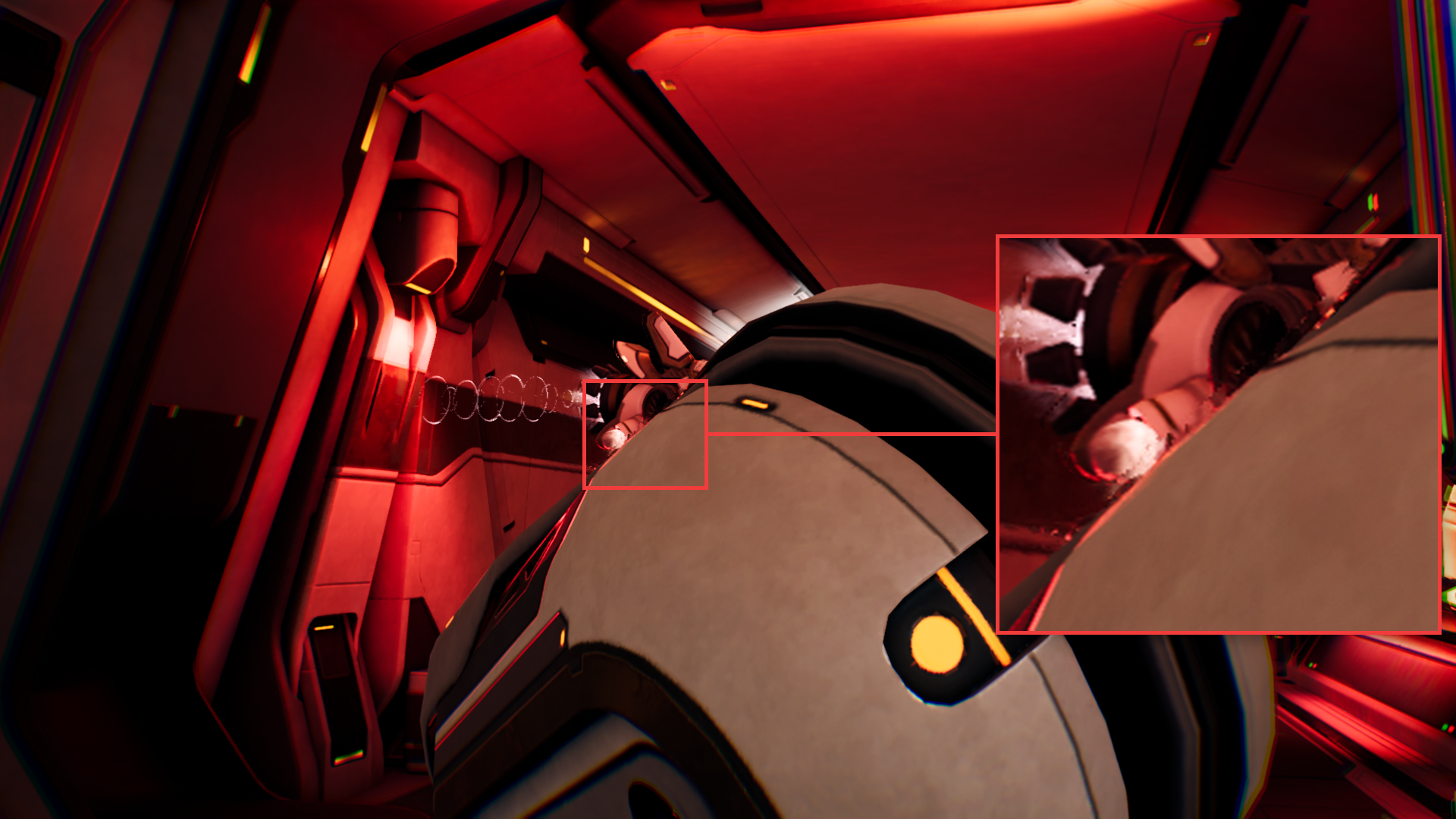

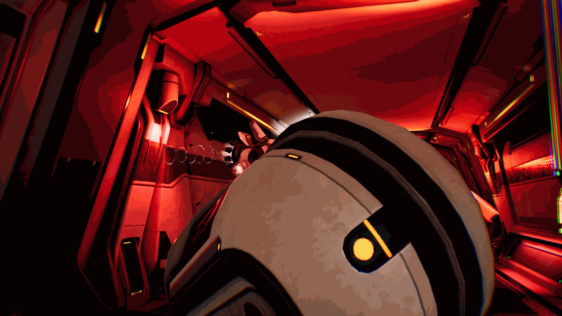

Analyze occlusion-out artifacts
In an occlusion-out case, newly revealed background might be missing from one of the source frames. NFRU uses the available color, depth, motion, and optical-flow information to reconstruct the revealed region. In the example, the revealed area is mostly clean. The remaining artifact appears as a small amount of blur or distortion near the moving edge.
The occlusion-out generation sequence shows how the interpolated frame handles background pixels that become visible as the foreground object moves away.
Occlusion-out interpolation sequence
The marked close-up shows mild softness at the boundary. The background reconstruction is generally clean, with minor smearing limited to the edge where the foreground object uncovers the background.
Marked occlusion-out artifact
