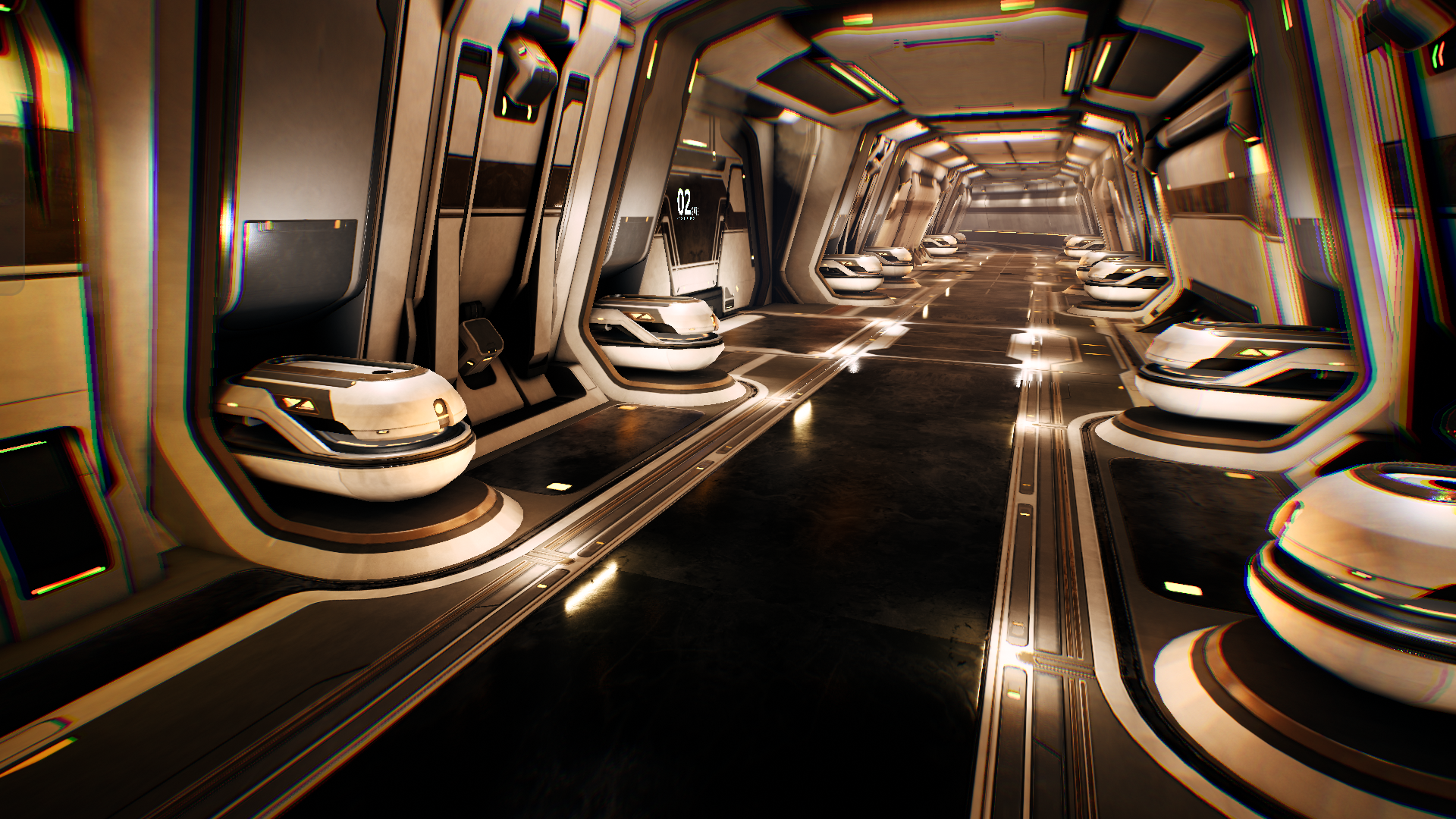

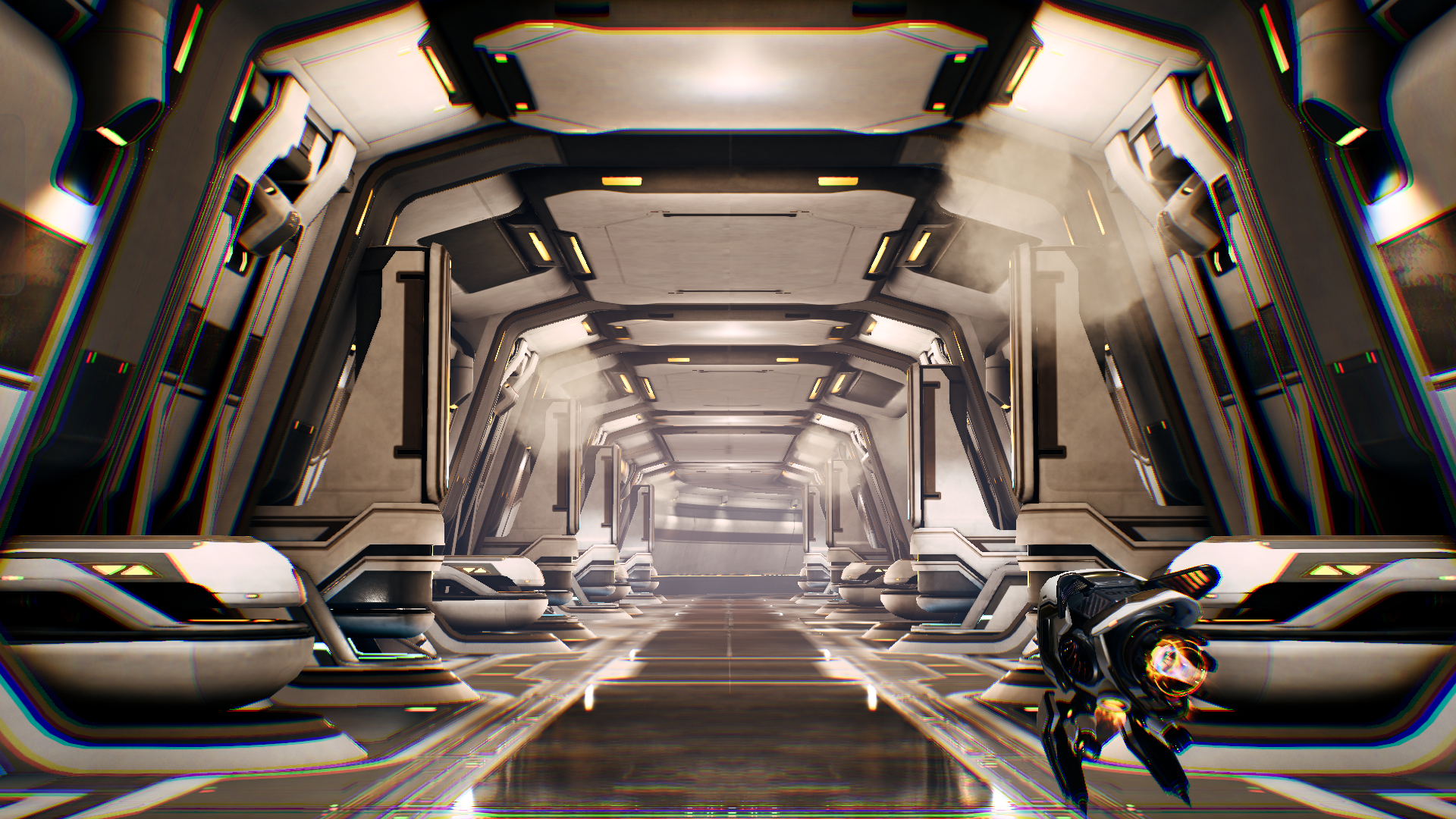

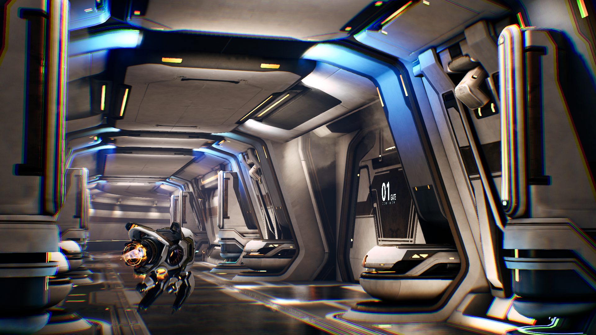

Reference cut 02 | Reference cut 03 | Reference cut 04 |

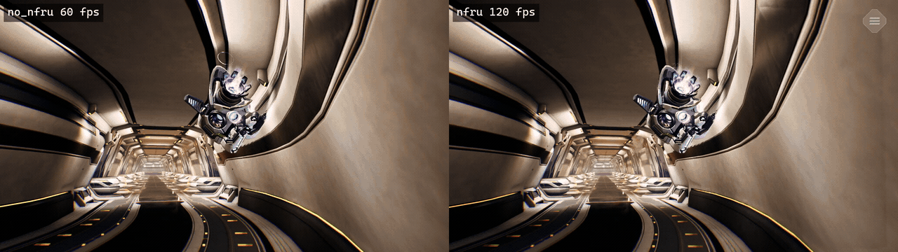

The following animated comparison shows the same Moku scene with NFRU disabled and enabled:
Use the comparison to observe how NFRU inserts generated intermediate frames to increase the perceived frame rate, making motion appear smoother while preserving visual detail. The most demanding cases — visibility changes, alpha-blended particles, and dramatic lighting transitions — can produce localized differences where the correct intermediate image is difficult to infer.
