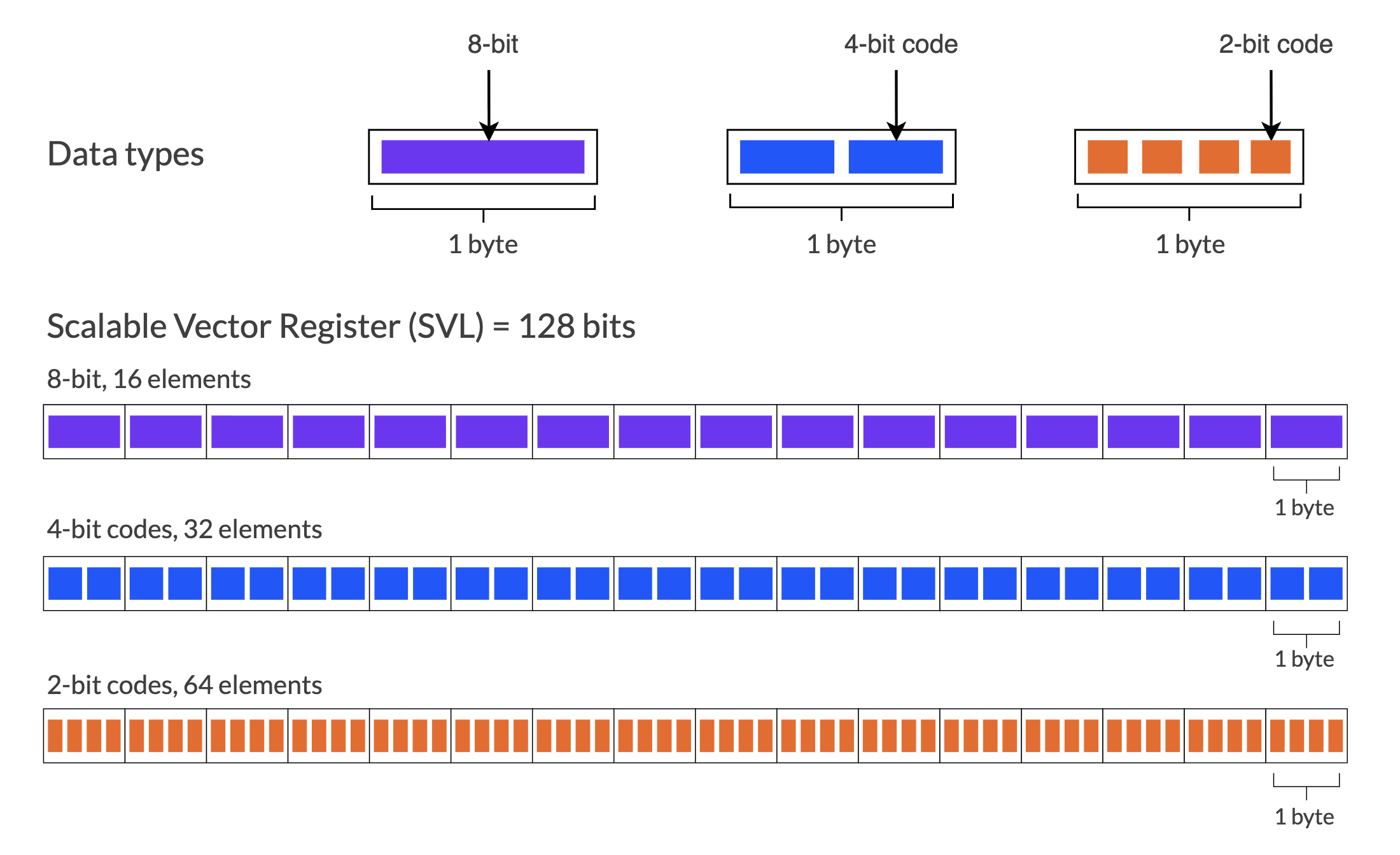

How sub-byte weights are stored
LLM inference on mobile and edge devices is often limited by memory capacity and bandwidth. During inference, model weights must be transferred from memory to the CPU, contributing to latency and energy use.
Quantization reduces this traffic by storing weights in lower-precision formats. Weight-only quantization maps each 32-bit floating-point (fp32) weight to a compact logical code and stores shared metadata, such as a scale or zero point, for each block.
int4 or int2. Depending on the quantization format, a 4-bit or 2-bit code might represent a signed integer, an unsigned integer, or an index into a codebook.Physical packing is the storage layout that places several low-bit codes into each byte. If you ignore the metadata, four 2-bit codes or two 4-bit codes can be stored in one byte.
Packing low-bit weight codes into a scalable vector register
This approach trades reconstruction accuracy for lower memory use. Its value also depends on decoding the packed codes efficiently. LUTI achieves that by expanding low-bit codes directly into arithmetic-ready vector values.

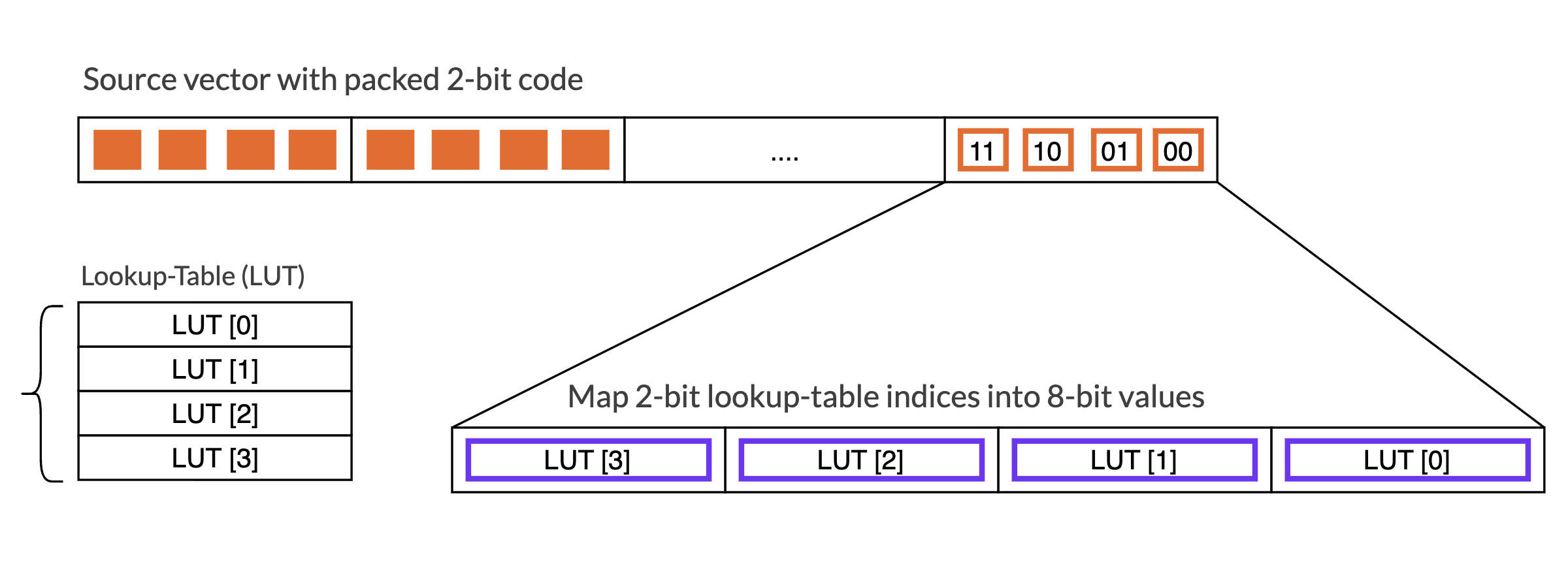

Understand the LUTI operation
Matrix multiplication kernels don’t usually operate on packed 2-bit or 4-bit codes. Before arithmetic, the codes needs to be decoded into values that the computation can consume.
Conceptually, the operation is:
index = get_lut_index(packed_code);
expanded_value = lookup_table[index];
Armv9-A LUTIs perform lookup-table operations that map low-bit indices to expanded values. LUTI2 and LUTI4 operate on 2-bit and 4-bit indices respectively.
- LUTI2 uses each 2-bit index to select one of four lookup-table values.
- LUTI4 uses each 4-bit index to select one of 16 lookup-table values.
The lookup table defines the expanded value that’s associated with each code according to the quantization scheme.
Lookup table for 2-bit codes
For example, a 2-bit lookup table might contain:
| Packed code | Lookup table index | Expanded value |
0b00 | lut[0] | -2 |
0b01 | lut[1] | -1 |
0b10 | lut[2] | 0 |
0b11 | lut[3] | 1 |
From packed 2-bit codes to 8-bit values
The key benefit of LUTI is that the matrix multiplication kernel can load weights in their compact form. A source vector of packed weights therefore carries more values per memory load than a vector containing already expanded 8-bit, 16-bit, or 32-bit values.
For 2-bit codes, LUTI uses the packed indices in a source vector to select lookup-table entries and writes the resulting values to destination vector registers.
The following diagram shows how 2-bit codes expand into 8-bit values:
LUTI maps packed 2-bit codes to lookup-table indices and writes the selected 8-bit values to a destination vector
