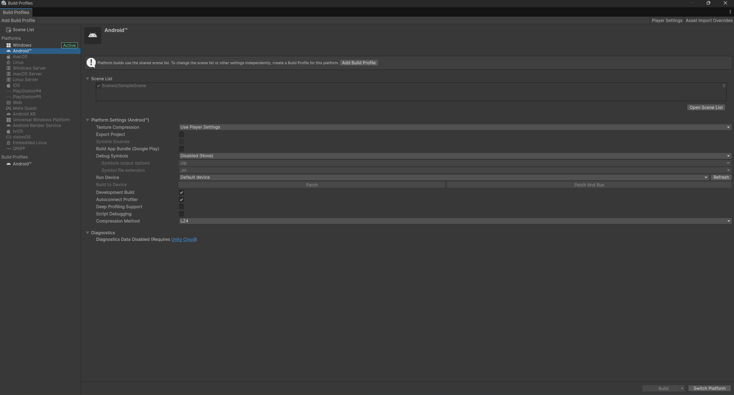

1. Select *File->Build Settings*. You will see the Build Settings window as before.
2. To activate profiling, you will enable the *Development Build* and *Autoconnect Profiler* options.
![Image Alt Text:Enable profiling options](https://learn.arm.com/learning-paths/mobile-graphics-and-gaming/get-started-with-unity-on-android/images/build-profiles-android.png)
*Figure 1. Build Profiles window*
3. You should already have the Android platform selected, so connect your device and click on *Build and Run*.
