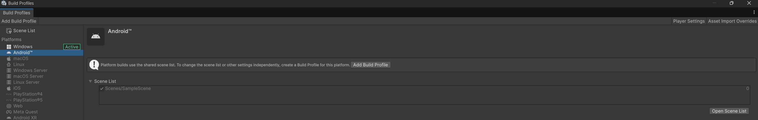

  2. Select File->Build Profile to show the Build Profile window:
    Image Alt Text:Build Profiles windowFigure 1. Build Profiles window
  3. In your project the platform labeled Active will be your machine’s operating systems (Windows, Mac or Linux). Since you are developing an Android app you must rebuild for Android.
  4. Select Android on the left and then click on Switch Platform at the bottom of the build profiles screen. This will take a few moments as it re-builds the assets for the Android mode (this step can take longer the first time it is done for any project).
    Image Alt Text:List of scenesFigure 2. Scene list
  5. In the screenshot, you can see that the SampleScene is already included in the build and preselected as the first scene to load. This list shows all the scenes that will be packaged into the final build. The top scene in the list is the one Unity will load first when the game starts. If your project contains multiple scenes, this is where you would select which ones to include and set your startup scene.
