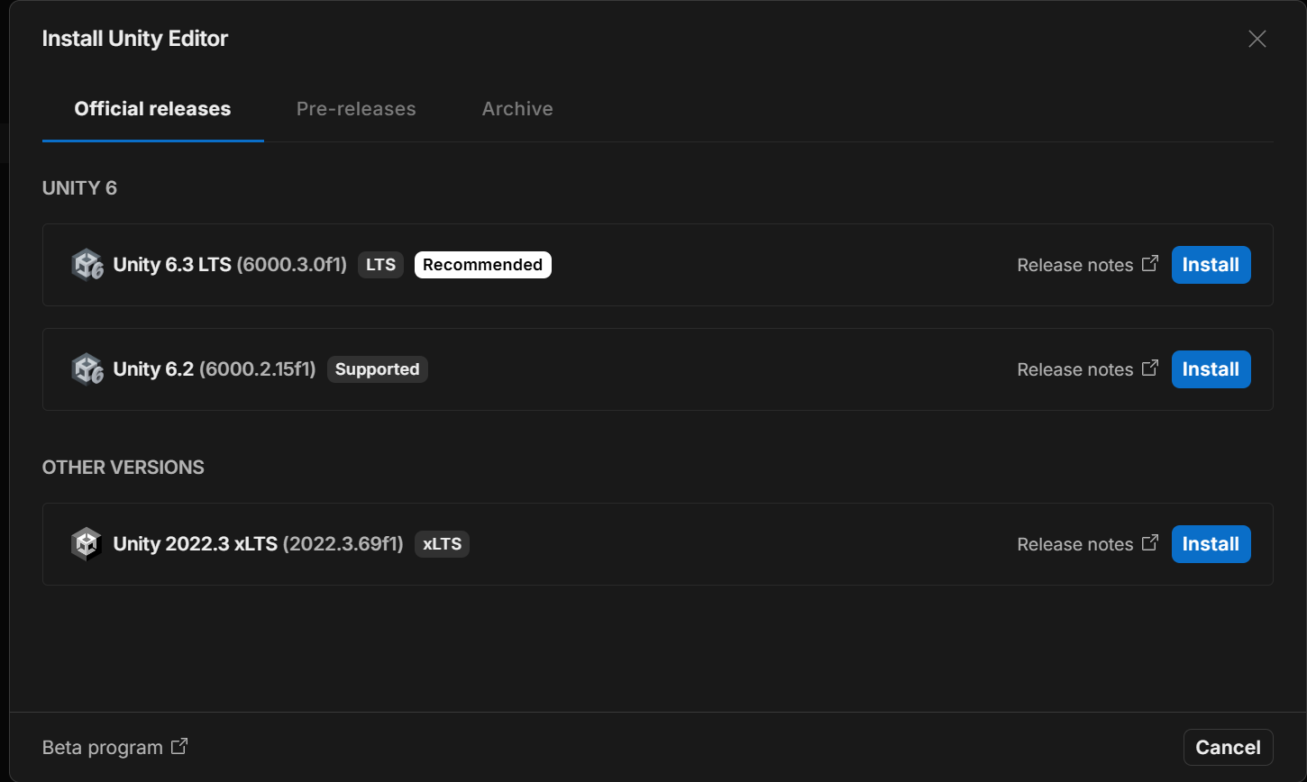

  • Go ahead and install the suggested editor. If you don’t see the above screen, you can always install a version of Unity manually. Click on the Installs tab on the left to see the list of installed editors (which will likely be empty):
Image Alt Text:Empty installs windowsFigure 2. Unity Hub installation list (empty)
  • Click on the recommended version. On the next screen you will add the Android module:
Image Alt Text:Recommended editor versionFigure 3. Install recommended LTS version

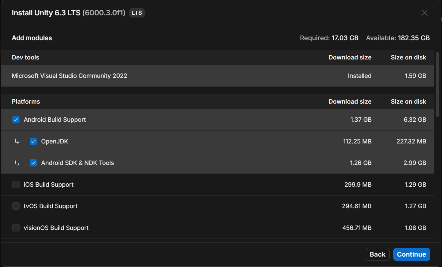

You should see a list of optional features to install with your editor. You can install Android build support now. In the list, click on “Android Build Support”.
Image Alt Text:Install Android Build Support moduleFigure 4. Add Android Build Support module
You now have Unity and Android support. If you forgot to tick Android Build Support or you already had a version of Unity without it, follow the next section to download Android support separately.

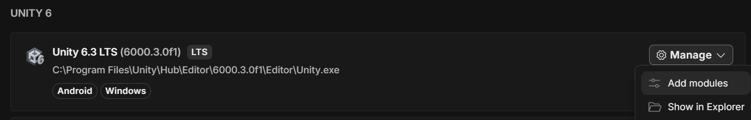

Follow these steps if you already have a version of Unity and just need to add the Android build support. Unity Hub lets you install modules on top of existing installations. Each editor version you install can have different modules installed on top.
  • Click on the Installs tab on the left to see your list of editor installations. Then click on the cog button and select Add Modules:
Image Alt Text:Add Modules optionFigure 5. Select Add Modules on the editor for which you wish to add Android support
  • You will be presented with the module list. Select Android Build Support and any other modules you wish to install. Then click Continue.
  • Once you have installed Android Build Support, you have everything you need for this Learning Path.

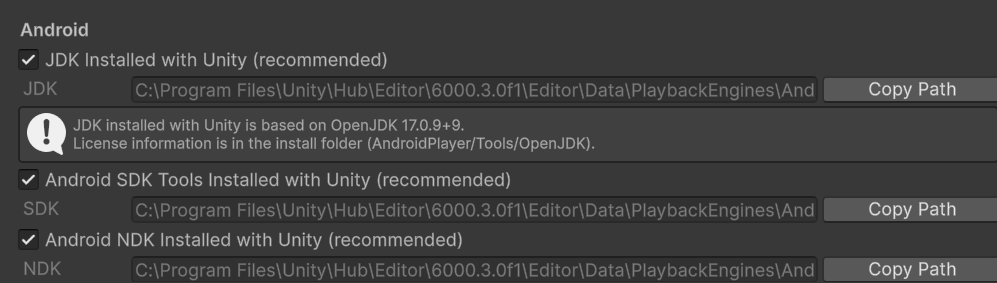

Android SDK and NDK
Android Build Support installs and manages the Android SDK and Android NDK for you. If you ever need to access the SDK or NDK directly, you can find them in the External Tools tab of Unity Editor Preferences (menu option Edit->Preferences).
Image Alt Text:Android settings in preferencesFigure 6. Android settings in Preferences
