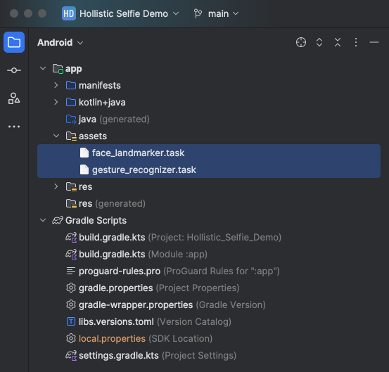

  1. Now you should see both model asset bundles in your assets directory, as shown below:
Image Alt Text:model asset bundles
