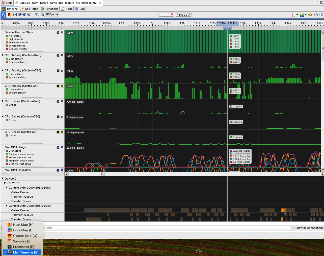

Switch to **Mali Timeline** view as shown below:
![Figure 13: Mali Timeline Streamline](https://learn.arm.com/learning-paths/mobile-graphics-and-gaming/android_webgpu_dawn/images/streamline-mali-timeline.png)
*Figure 13: Mali Timeline Streamline*

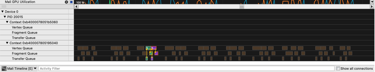

You might have to zoom into the data up to the maximum (**500 us**), as you are rendering a simple 3D object.
You can analyze two consecutive frames as shown below:
![Figure 14: Two Consecutive Frames](https://learn.arm.com/learning-paths/mobile-graphics-and-gaming/android_webgpu_dawn/images/streamline-mali-analysis.png)
*Figure 14: Two Consecutive Frames*
Arm has worked with the Dawn team to optimize data uploading to GPU buffers for Mali GPUs.
Arm has implemented a **Fast Path** mechanism where the Vertex Queue starts processing in parallel while an earlier Fragment Queue is simultaneously being processed.
As you can see from the above picture, there is some overlap between the Fragment Queue of the first frame, and the Vertex Queue of the consecutive frame.
This demonstrates that the application is hitting the **Fast Path** that Arm has implemented to optimize performance of Dawn for Mali GPUs.
The overlap is small as the application is rendering the same simple 3D object under a different orientation. You can extend the application to render complex objects with multiple *Uniform Buffers*. This demonstrates the overlap in more detail.
