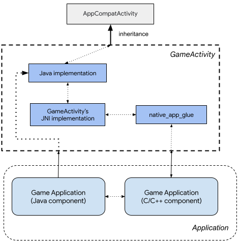

GameActivity is a Jetpack library designed to assist Android games in processing app cycle commands, input events, and text input in the application’s C/C++ code.
GameActivity is a direct descendant of NativeActivity and shares a similar architecture:
Image Alt Text:Game Activity Architecture Figure 5: Game Activity Architecture
With GameActivity, you can focus on game development and avoid spending excessive amounts of time dealing with the Java Native Interface (JNI) code.
GameActivity performs the following functions:
  • It interacts with the Android framework through the Java-side component.
  • It passes app cycle commands, input events, and input text to the native side.
  • It renders into a SurfaceView, making it easier for games to interact with other UI components.
