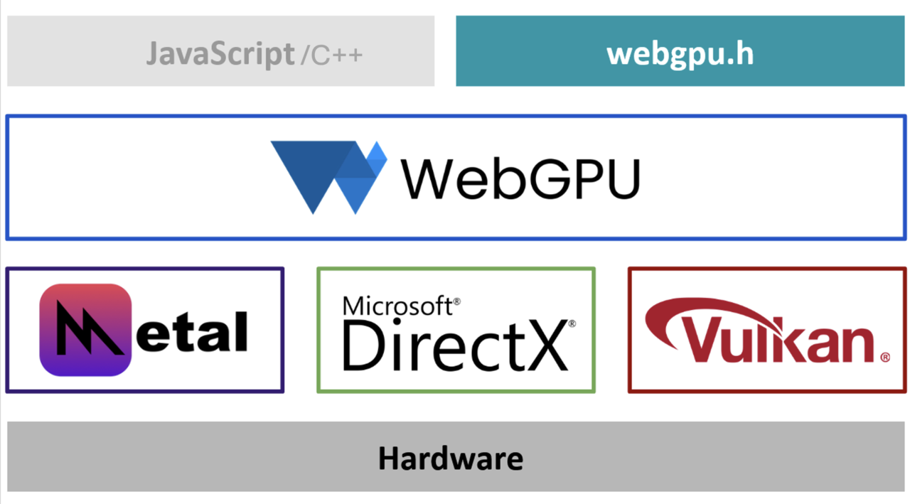

WebGPU is a render hardware interface built on top of various backend APIs such as Vulkan, DirectX, and Metal, though this is OS-dependent.
WebGPU is available through web browsers using the webgpu.h header file.
The high-level view of WebGPU is shown below in Figure 1:
![Figure 1: WebGPU High-Level View](https://learn.arm.com/learning-paths/mobile-graphics-and-gaming/android_webgpu_dawn/images/webgpu_highlevel.webp)
