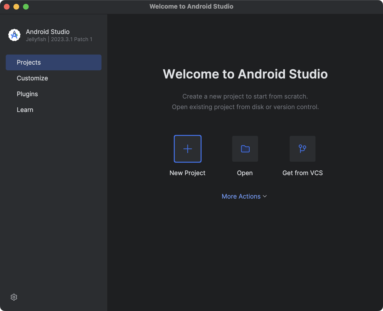

  1. Open Android Studio on your development machine and then click the + New Project icon:
Image Alt Text:img1

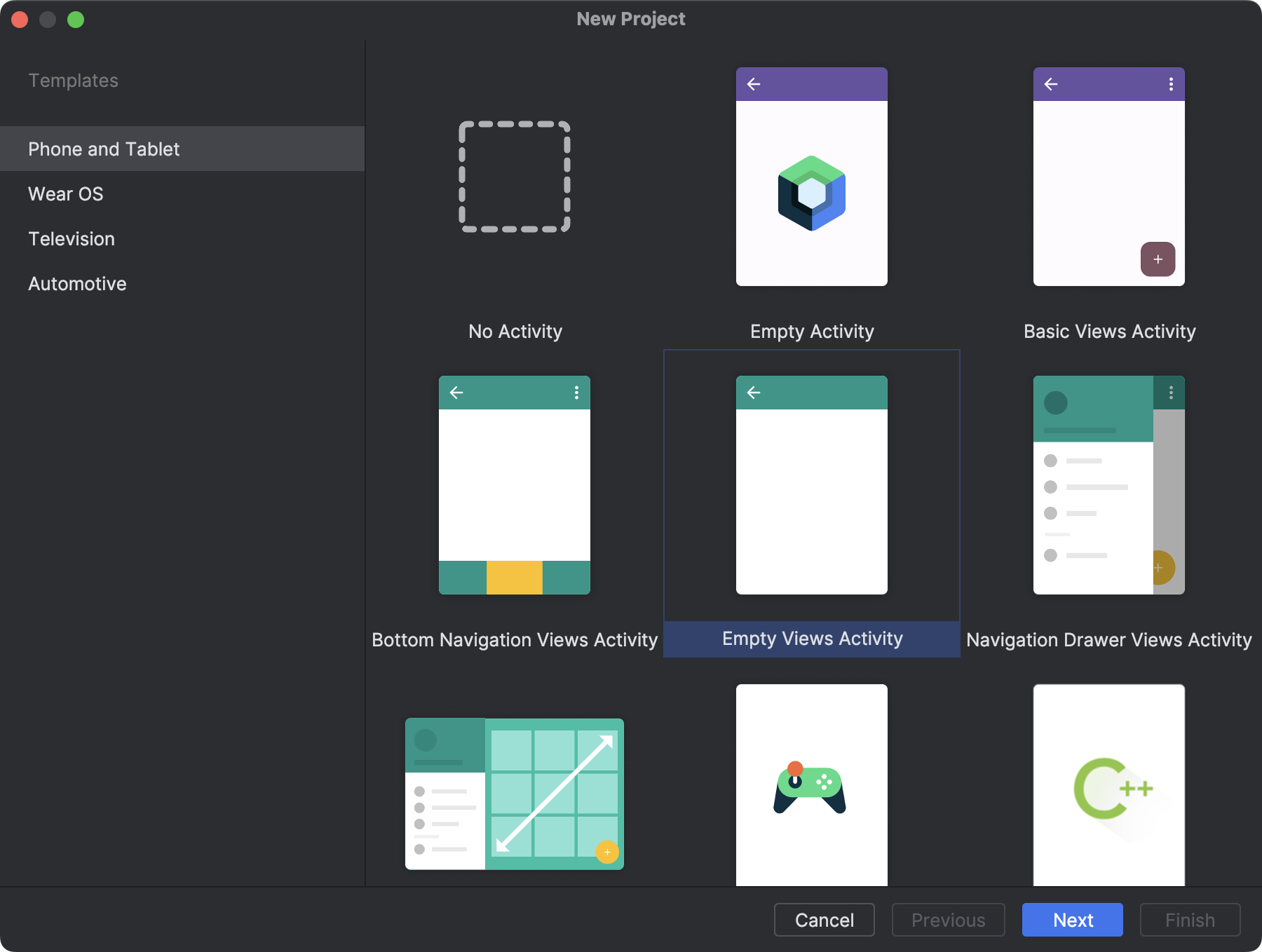

  1. In the New Project window, select Empty Views Activity:
Image Alt Text:img2

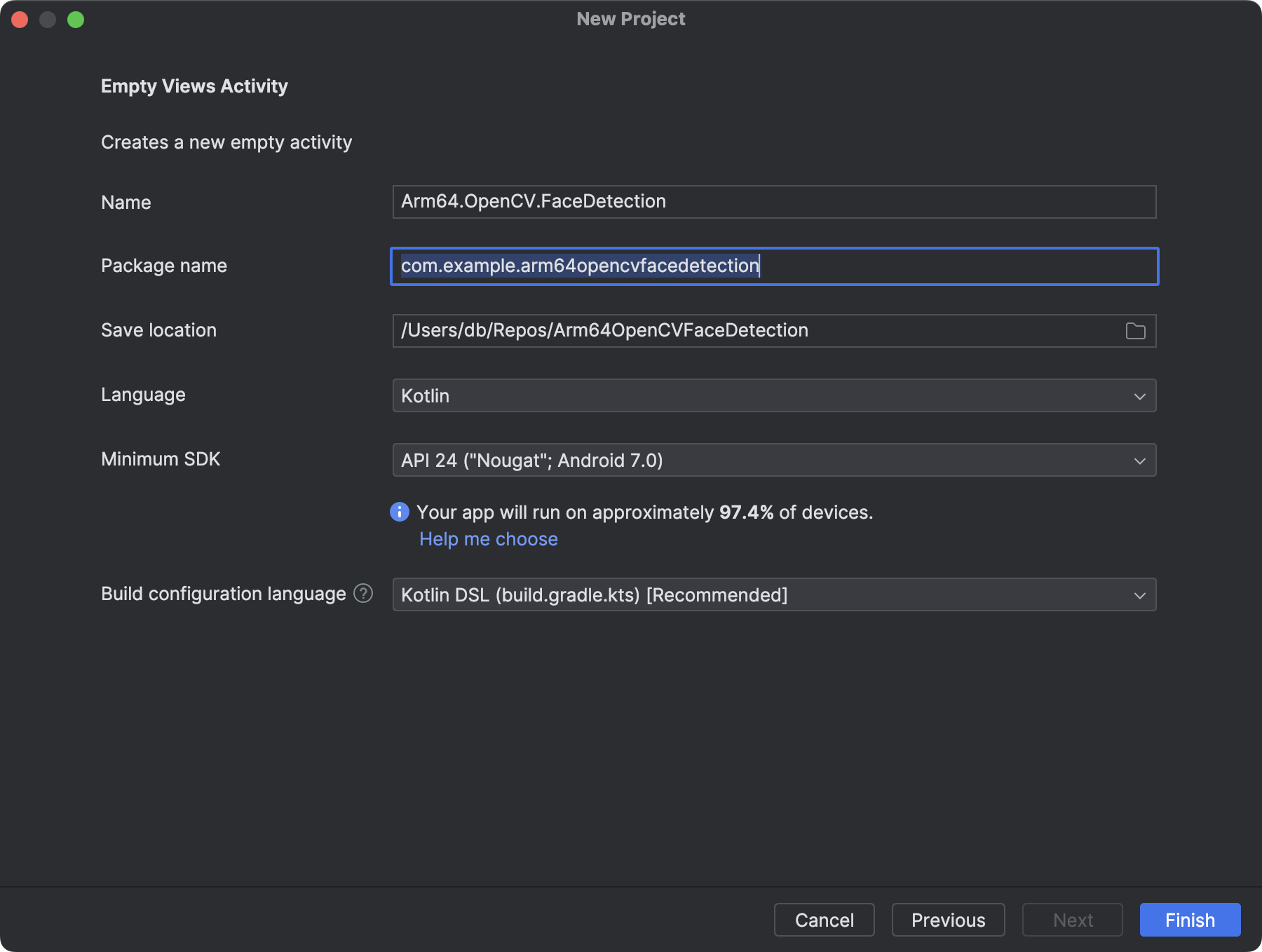

  1. Configure the project as follows (see figure below):
  • Name: Arm64.OpenCV.FaceDetection.
  • Package name: com.example.arm64opencvfacedetection.
  • Save location: select location.
  • Language: Kotlin.
  • Minimum SDK: API 24.
  • Build configuration language: Kotlin DSL.
Image Alt Text:img3
  1. Click the Finish button.

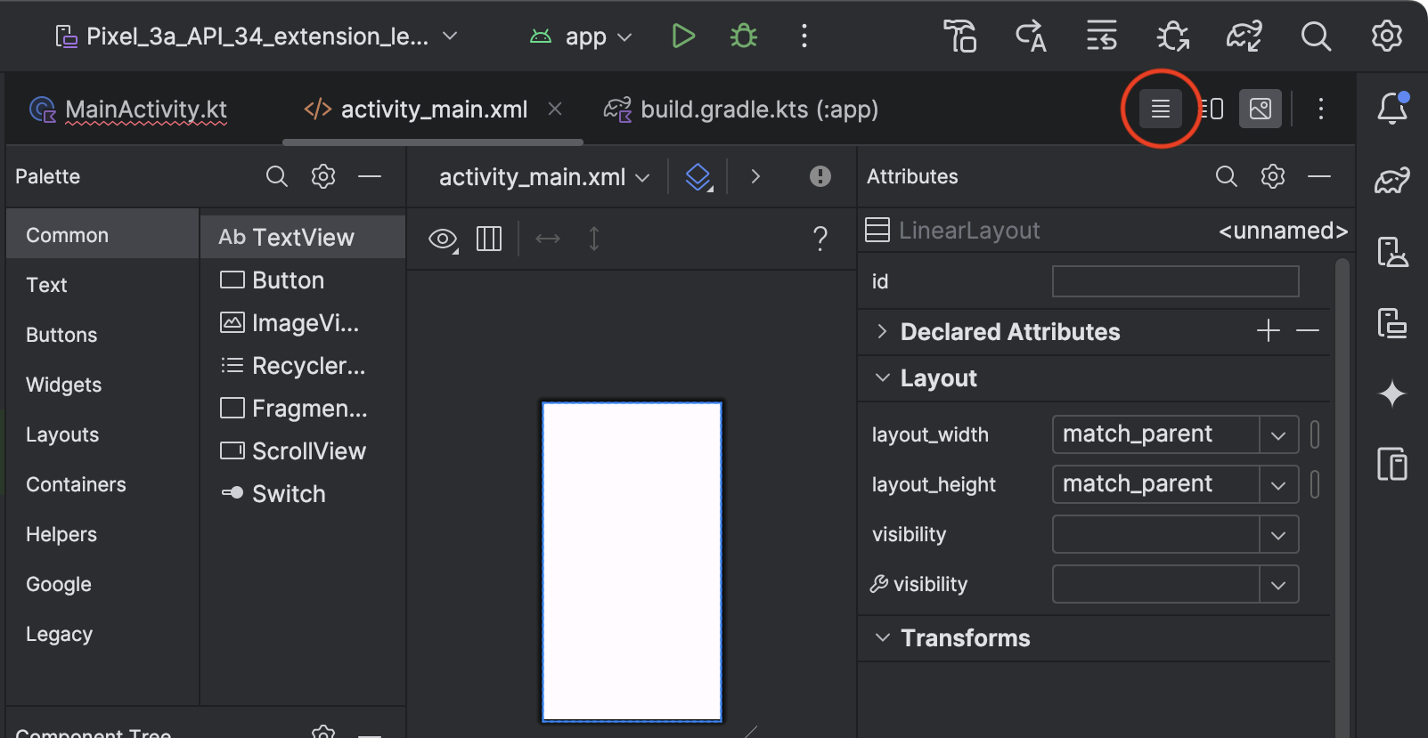

  1. Under the Project in the left window, double-click app/res/layout/activity_main.xml. This opens the view designer.
  2. Click the highlighted icon in the top right corner to switch to the XML view.
Image Alt Text:img4
  1. Modify the activity_main.xml as shown below:

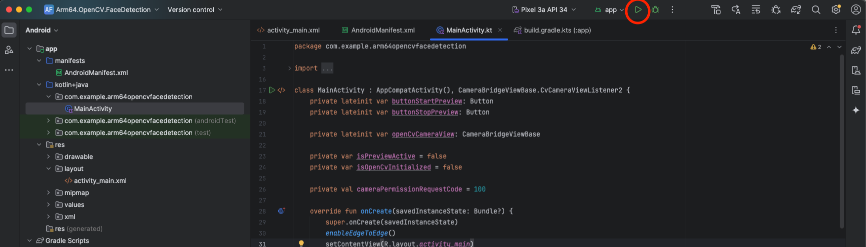

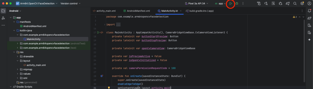

You have just prepared the application to stream camera frames. You can now launch the application in the emulator. To do so, click the green ‘run’ button as shown here:
Image Alt Text:click run
The application should start, and you should see the app running in an emulator. It will ask you for camera permissions.
