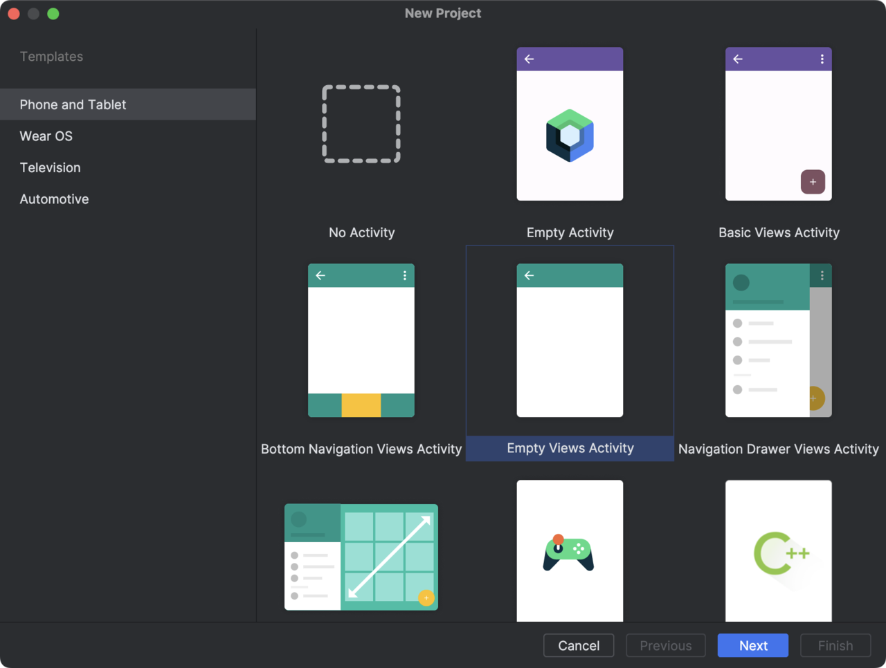

1. Open Android Studio on your development machine and then click the **+ New Project** icon:
   ![](https://learn.arm.com/learning-paths/mobile-graphics-and-gaming/android_opencv_camera/figures/01.png)
2. In the New Project window, select **Empty Views Activity**:
   ![](https://learn.arm.com/learning-paths/mobile-graphics-and-gaming/android_opencv_camera/figures/02.webp)

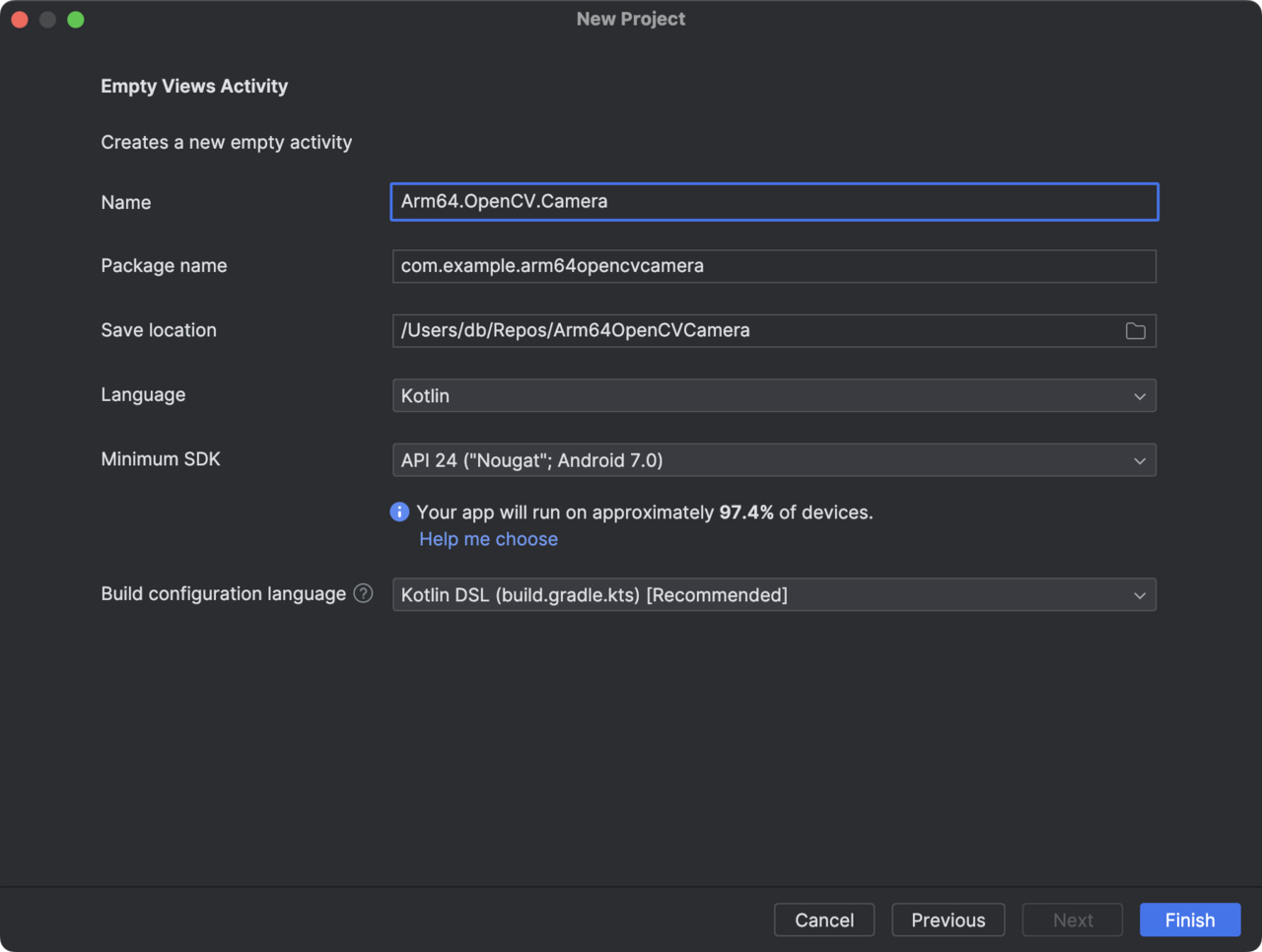

3. Configure the project as follows (see figure below):
   - Name: **Arm64.OpenCV.Camera**.
   - Package name: **com.example.arm64opencvcamera**.
   - Save location: *Select relevant file location*.
   - Language: **Kotlin**.
   - Minimum SDK: **API 24**.
   - Build configuration language: **Kotlin DSL**.
   ![](https://learn.arm.com/learning-paths/mobile-graphics-and-gaming/android_opencv_camera/figures/03.webp)

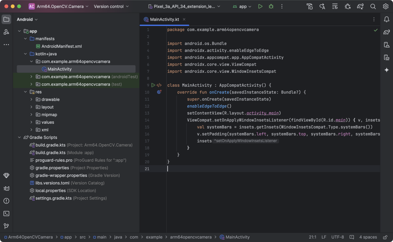

4. Click the **Finish** button.
The project will be ready in a few moments, and Android Studio should appear as shown below:
![](https://learn.arm.com/learning-paths/mobile-graphics-and-gaming/android_opencv_camera/figures/04.webp)

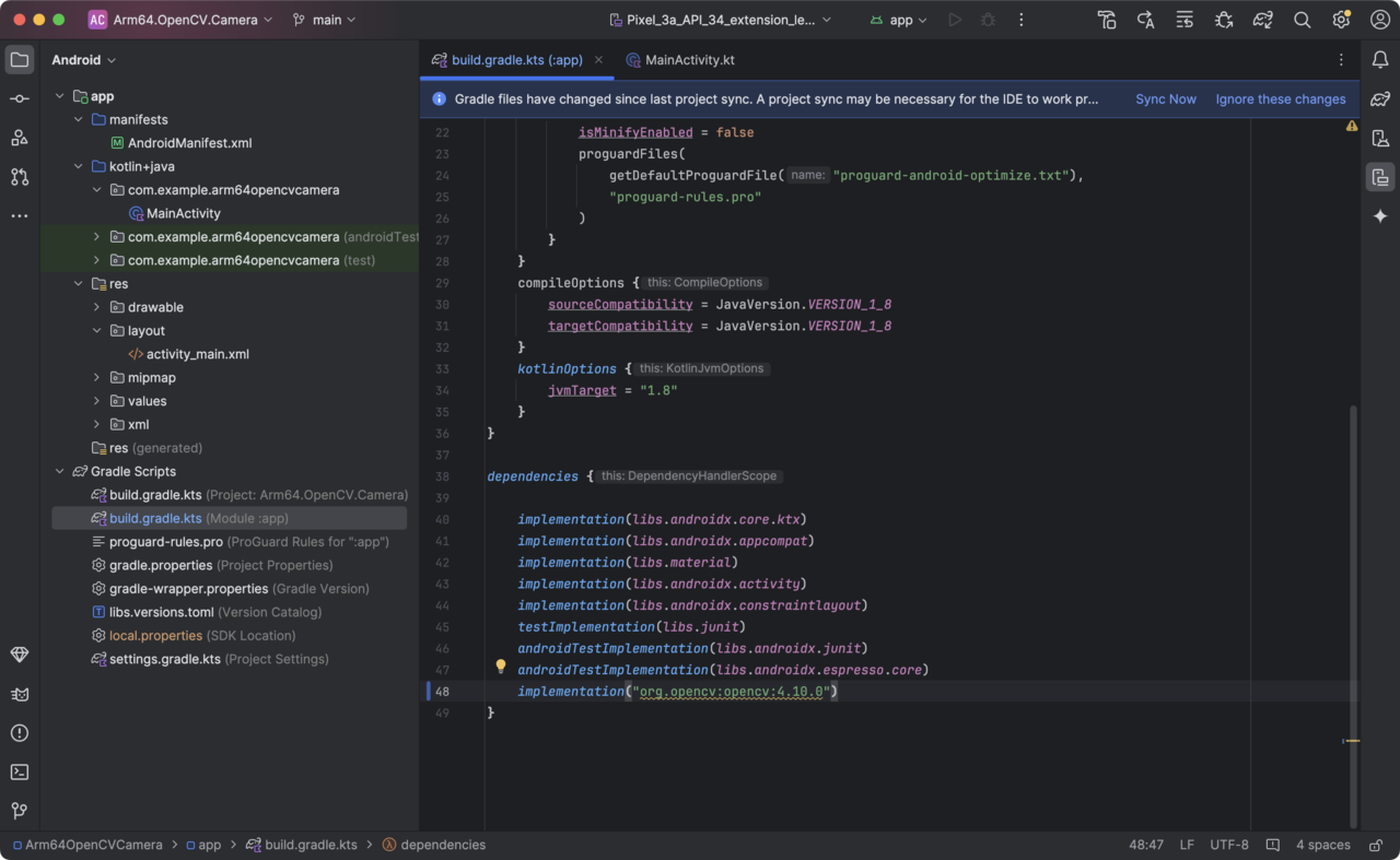

To add OpenCV for Arm64, open the *build.gradle.ts (Module: app)*, and add the following line under the dependencies:
implementation("org.opencv:opencv:4.10.0")
Then, click the **Sync Now** link in the top pane that appears:
![](https://learn.arm.com/learning-paths/mobile-graphics-and-gaming/android_opencv_camera/figures/05.webp)
From here on, you can use OpenCV in your application.

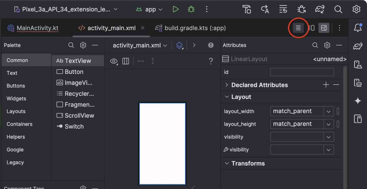

1. Under the Project (left window) double-click `app/res/layout/activity_main.xml`. This opens the view designer.
2. Click the highlighted icon in the top-right corner to switch to the XML view.
   ![](https://learn.arm.com/learning-paths/mobile-graphics-and-gaming/android_opencv_camera/figures/06.webp)

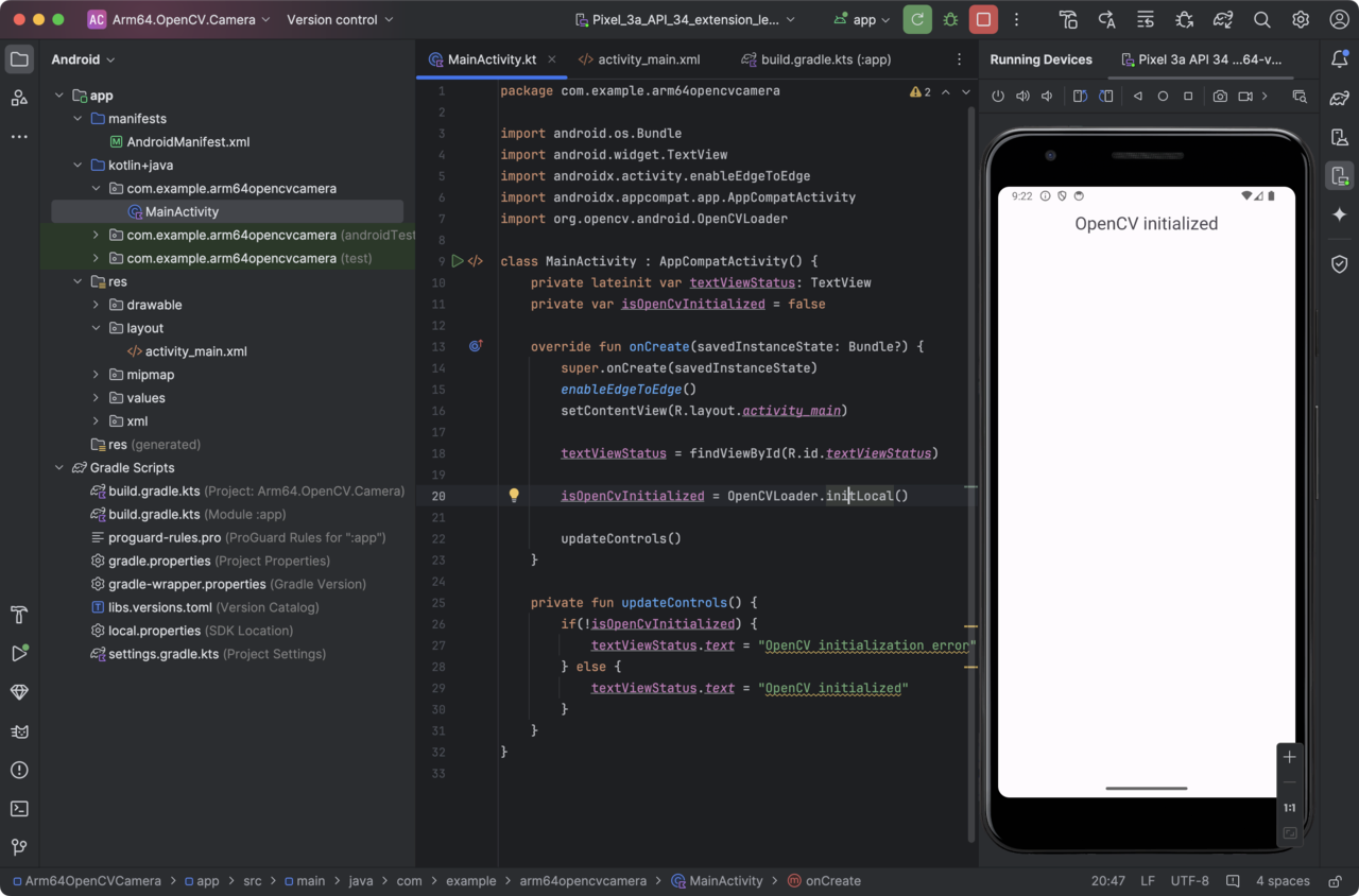

## Launch the application
You can now launch the application in the simulator. To do so, use the top menu, where you click Run -> Run ‘app’. The application should start, and you should see the “OpenCV initialized” text as shown below:
![](https://learn.arm.com/learning-paths/mobile-graphics-and-gaming/android_opencv_camera/figures/07.webp)
