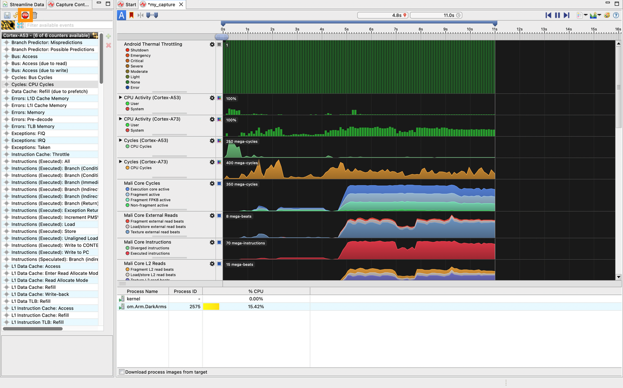

## Capture data
1. Select **Start capture** to start capturing profile data from the device. Enter a name and location for the capture file.
2. The application starts automatically on the device. Interact with the application as desired for the profiling run you want to do.
3. When you’ve collected enough data, select **Stop capture**.
   ![Screenshot of Streamline during a capture with the Stop capture button highlighted and performance charts updating in the Timeline view](https://learn.arm.com/learning-paths/mobile-graphics-and-gaming/ams/images/stop_capture.webp)
   Streamline stops capturing data, removes the daemon, and processes the captured data.
## Analyze the results
The charts in the **Timeline** view show the performance counter activity captured from the device. Hover over the charts to see the values at that point in time. Use the Calipers to focus on particular windows of activity.
For instructions to use the features in the **Timeline** view, see the [Streamline User Guide](https://developer.arm.com/documentation/101816/latest/Analyze-your-capture).
To understand how to interpret the capture from different points of view, see [Android performance triage with Streamline](https://developer.arm.com/documentation/102540/latest/).
