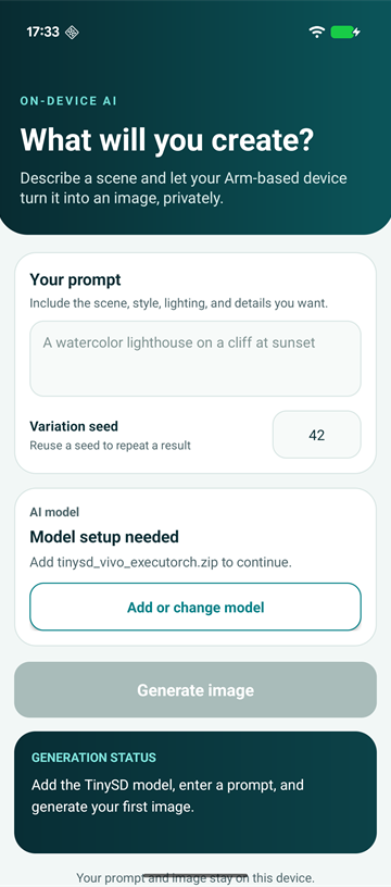

TinySD Studio opens without a model. Generate image remains unavailable until you import the model package. Installing with adb install -r preserves a model package imported previously.
Image Alt Text:TinySD Studio first-launch screen with the prompt and seed controls, a Model setup needed message, and Generate image unavailable because no model package has been imported.TinySD Studio before a model package is imported
