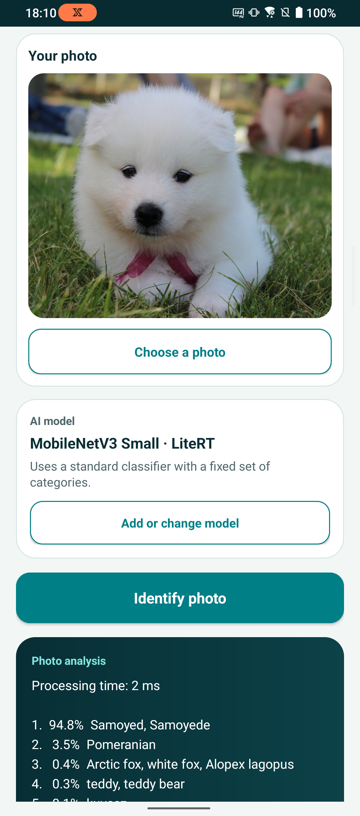

To classify a photo:
  1. In Photo Insight, select LiteRT Quick Identify.
  2. Select Add or change model, open Downloads, and choose mobilenet_v3_small_android_litert_optimized.tflite.
  3. Select Choose photo and choose a JPEG or PNG image from the phone.
  4. Select Identify photo.
The application displays the five highest-scoring ImageNet labels and the processing time. The available labels are fixed when the model is trained, so a result can be more specific or less natural than the description you would use.
Image Alt Text:Photo Insight LiteRT Quick Identify result for a white Samoyed puppy using MobileNetV3 Small. The result panel shows a 2 millisecond processing time and ranks Samoyed first at 94.8 percent.Samoyed classification with MobileNetV3 Small and LiteRT
The timing shown was recorded on one Arm-based phone and is an example rather than a benchmark. Measure latency on your target phone before making deployment choices.

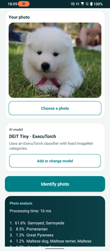

To run the model:
  1. In Photo Insight, select ExecuTorch Quick Identify.
  2. Select Add or change model and choose deit_raspberry_executorch_optimized.pte from Downloads.
  3. Select Choose photo and choose the same image used for LiteRT.
The adapter loads the model’s forward method, applies its registered preprocessing profile, and displays the processing time and five highest-scoring ImageNet labels.
Image Alt Text:Photo Insight ExecuTorch Quick Identify result for a white Samoyed puppy using DEiT Tiny. The result panel shows a 16 millisecond processing time and ranks Samoyed first at 61.6 percent, followed by Pomeranian and Great Pyrenees.Samoyed classification with DEiT Tiny and ExecuTorch
The timing is illustrative. Differences between these results include both the model and runtime, so they aren’t a controlled LiteRT-versus-ExecuTorch benchmark.

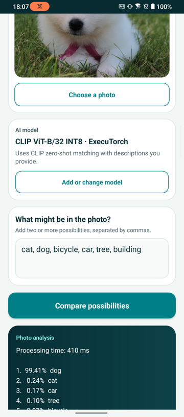

To compare custom descriptions:
  1. In Photo Insight, select ExecuTorch CLIP Custom Match.
  2. Select Add or change model and choose clip-vit-base-patch32-int8-executorch.pte from Downloads.
  3. Select Choose photo and choose the same image used for the classifiers.
  4. Enter two or more comma-separated descriptions, such as a dog, a cat, a bicycle.
  5. Select Compare possibilities.
The application ranks only the descriptions that you enter. Change the descriptions and run the same image again to see how the candidate set affects the result.
Image Alt Text:Photo Insight ExecuTorch CLIP Custom Match result for the same white Samoyed puppy. The result panel shows a 410 millisecond processing time and ranks dog first with a 99.41 percent relative score.Custom image-text matching with CLIP and ExecuTorch
