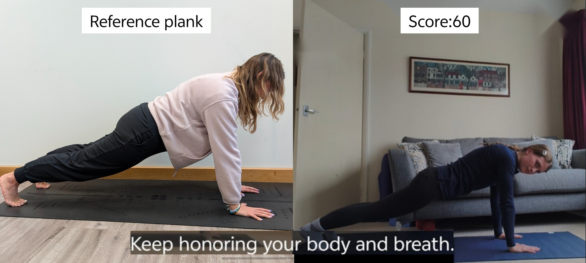

You’ll build an on-device AI fitness tutor app for Android called AI Plank Tutor.
The app watches a learner hold a plank and compares their body position with a stored instructor reference. It asks a local LLM for one short correction, and speaks the correction using Android text-to-speech.
This project is based on [AI Yoga Tutor](https://developer.arm.com/community/arm-community-blogs/b/ai-blog/posts/ai-yoga-tutor). You’ll use the same core pipeline, but the project narrows the app to one static pose. By building an app focused on one pose, you can focus on how a pipeline that includes Android camera, pose detector, local LLM, and speech output fits together.
![AI Plank Tutor comparing a reference pose with the learner's live plank](https://learn.arm.com/learning-paths/mobile-graphics-and-gaming/ai-plank-tutor/screenshot.jpg)
*AI Plank Tutor comparing a reference pose with the learner's live plank*
The finished app has two main visual areas:
- An instructor plank image on the left.
- A live front-camera preview on the right.
The app overlays a pose score and a short caption that matches the spoken coaching feedback.
