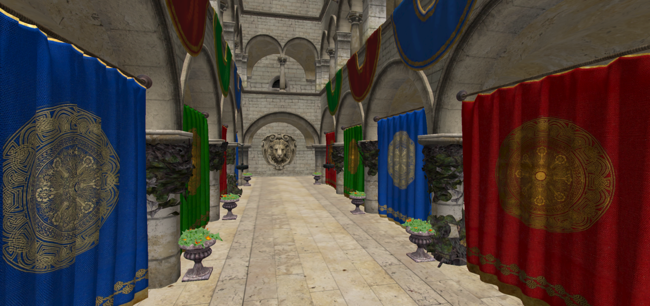

Fixed-rate compression is lossy but, despite this, AFRC achieves high quality results even with the highest compression ratios, preserving detail in edges and high-frequency areas. So much so that, to the naked eye, the compressed and uncompressed images look the same side-by-side, so that it can be called ‘visually lossless’:
| Uncompressed | AFRC 2BPC (bits per component) |
| ![Uncompressed Sponza scene](https://learn.arm.com/learning-paths/mobile-graphics-and-gaming/afrc/images/sponza_default.webp) | ![Sponza scene with AFRC 2BPC compression](https://learn.arm.com/learning-paths/mobile-graphics-and-gaming/afrc/images/sponza_afrc.webp) |
