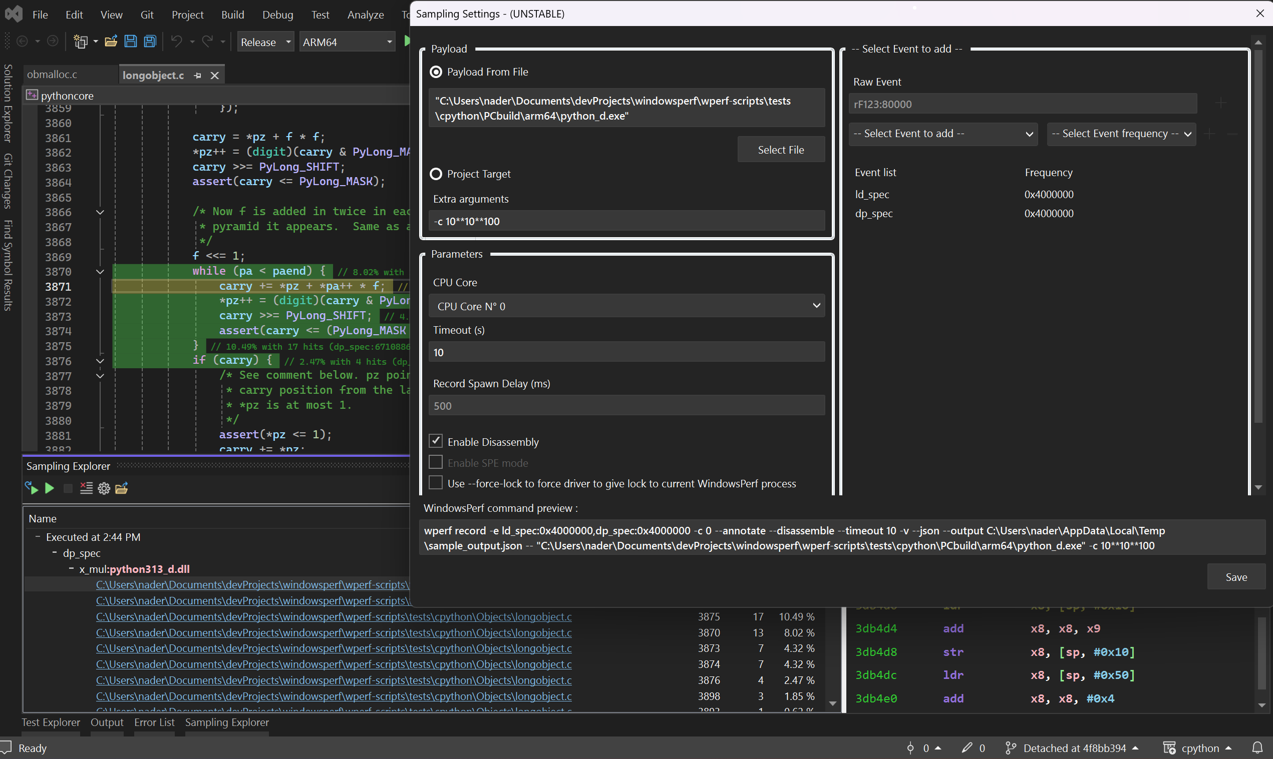

How do I configure the sampling preferences?
From the Sampling Explorer window, find and click on the Configure the sampling command icon, it looks like a gear. This action will open the Sampling Settings dialog.
Fill in the required fields listed below:
- File payload: file to profile
- CPU core selection: cores to sample
- Event choice: available events
- Desired frequency: sampling frequency
Fill in these fields with the information you want to sample.
As you configure the settings, the dialog provides a real-time preview of the WindowsPerf command that will be executed in the WindowsPerf Command Preview box.
When you are satisfied with your configurations, click Save.

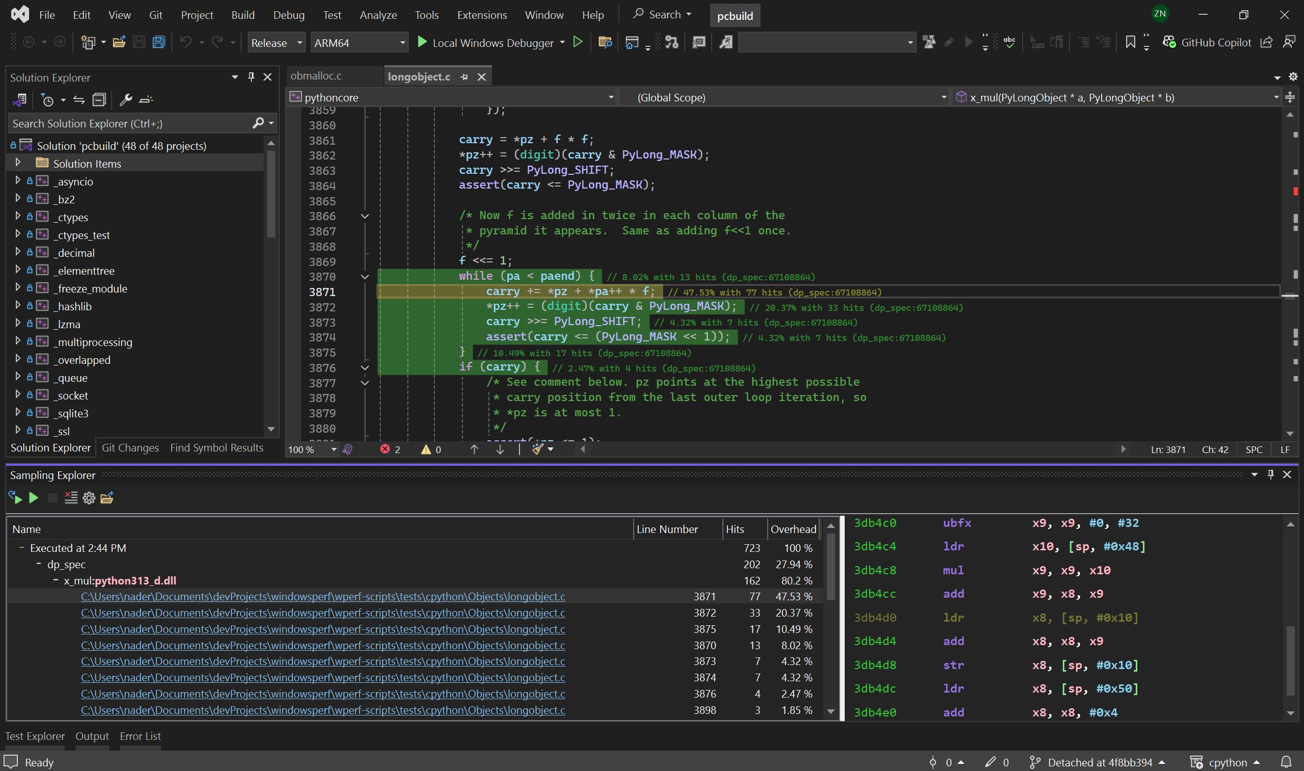

How do I view the sampling results?
When the sampling stops, you notice the window divides into two sections: a tree view and a detailed analysis section.
Navigate through the tree view by clicking on the nodes. This reveals functions triggered, selected events, line numbers in the source code, and the responsible source files.
Any accessible source file appears as a clickable hyperlink. Selecting it will directly open the file within the Visual Studio IDE.
