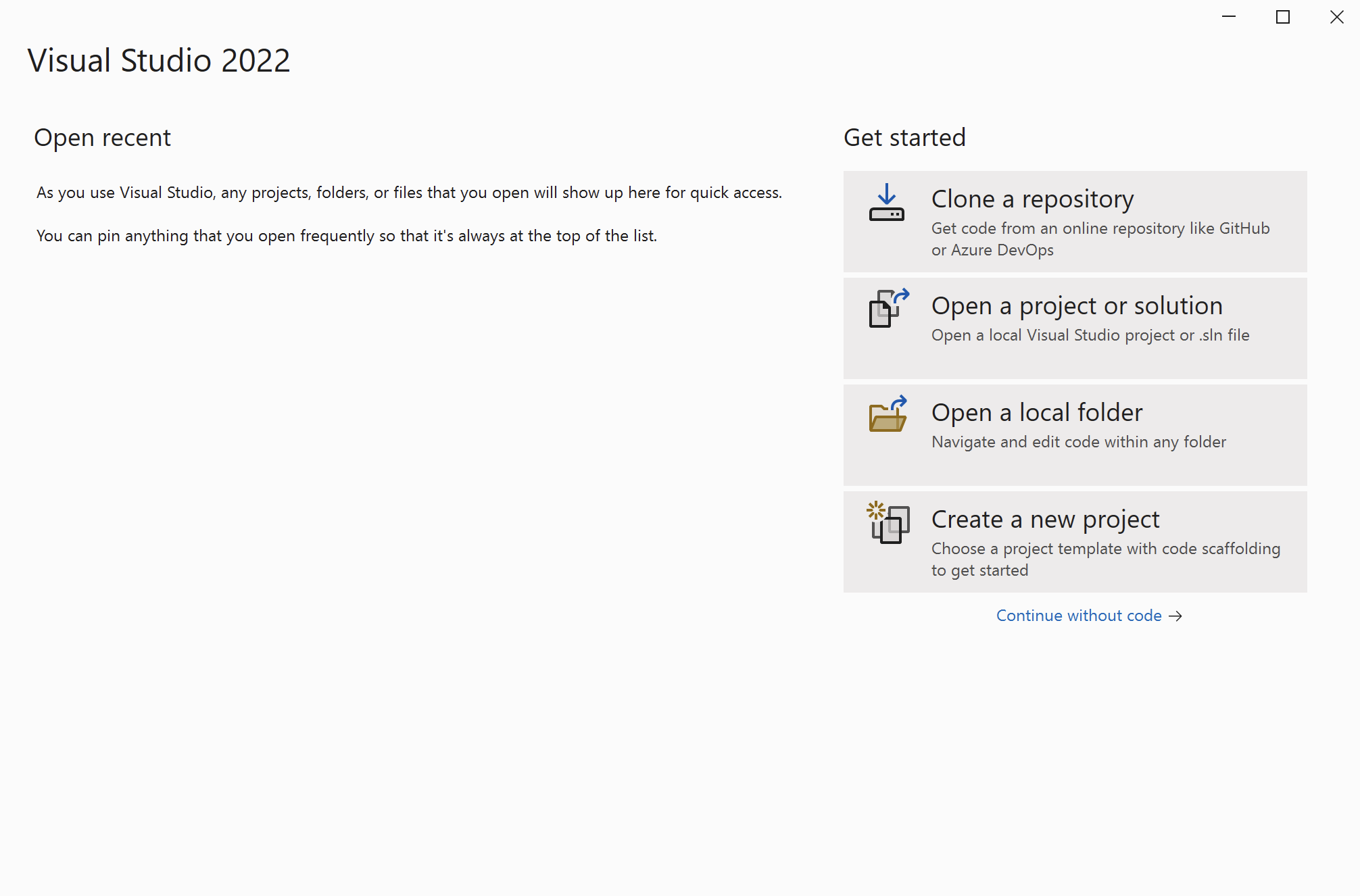

Open Visual Studio and click ‘Create a new project’.
Image Alt Text:fig1

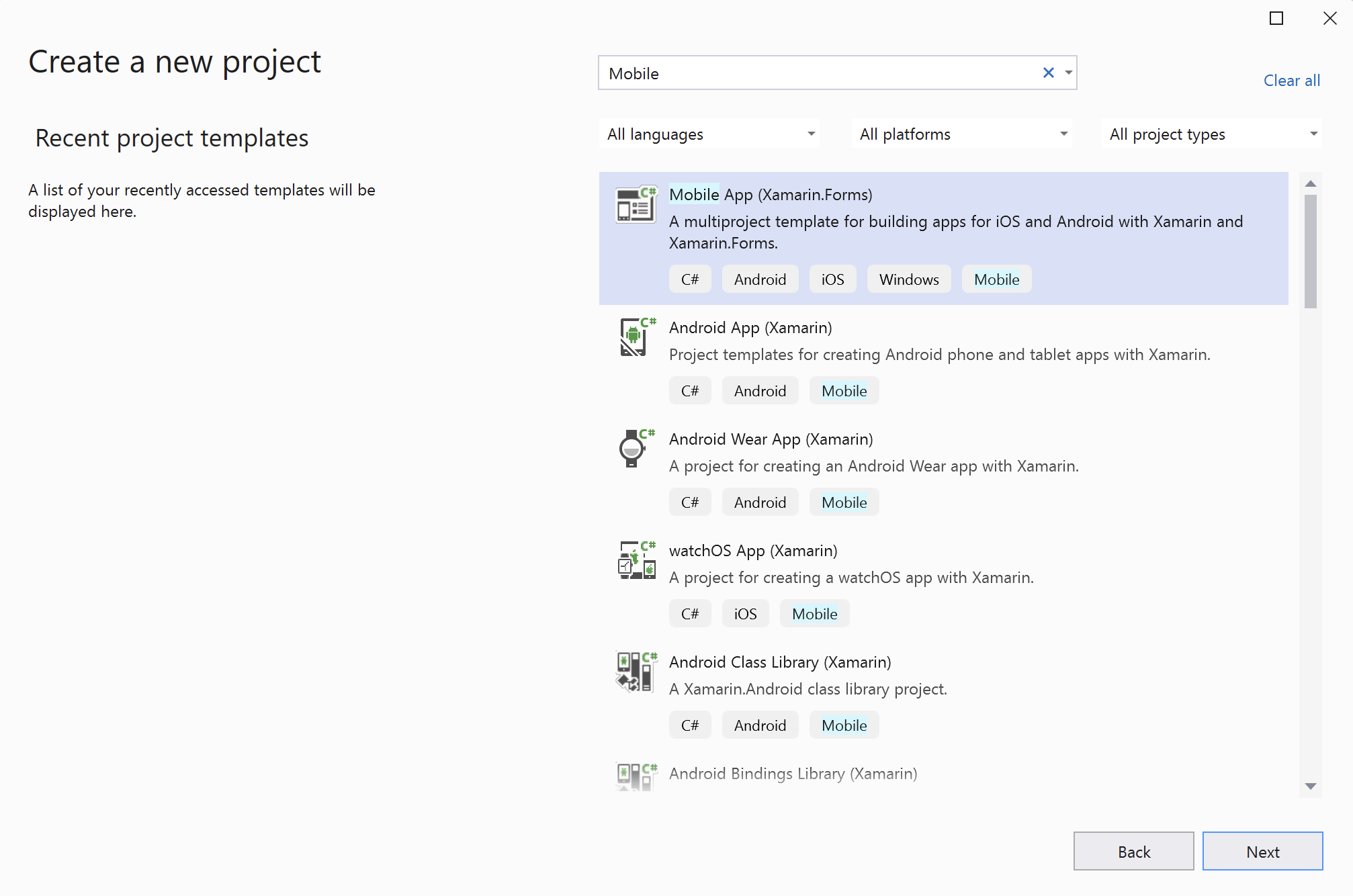

In the next window, search for the ‘Mobile App (Xamarin.Forms)’ template.
Image Alt Text:fig2

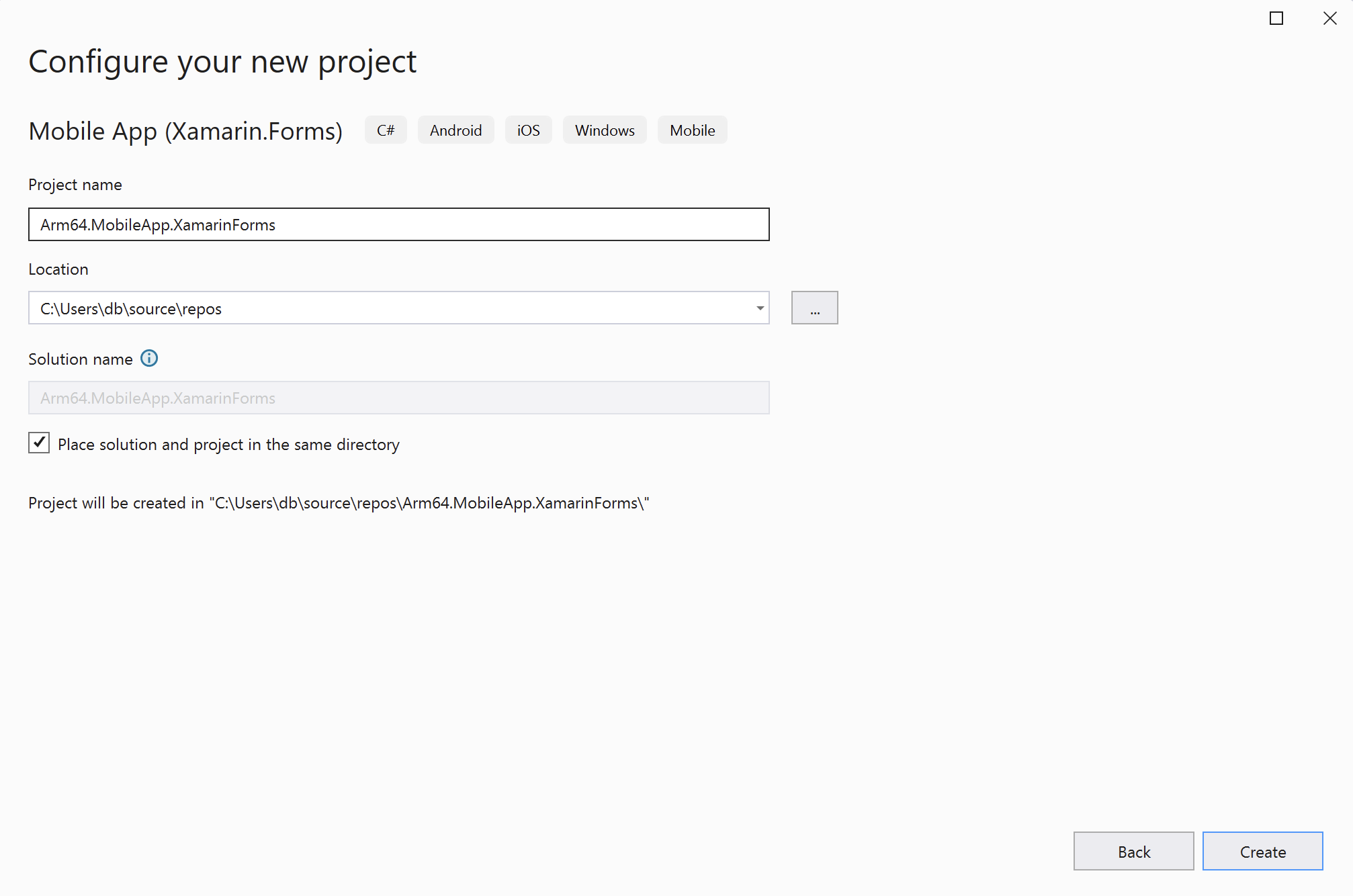

This will open the ‘Configure your new project’ view, in which you should configure the project as follows (refer to the figure below):
  1. Project name: Arm64.MobileApp.XamarinForms
  2. Location: Select the project location on your drive (example: C:\Users\db\source\repos)
  3. Check the option Place solution and project in the same directory
  4. Click the Create button
Image Alt Text:fig3

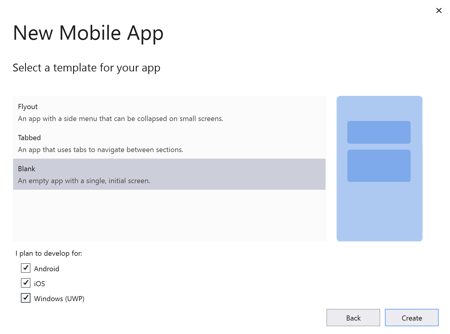

In the last step, ‘New Mobile App’, choose the Blank option in the ‘Select a template for your app’ list. Then, check the Android, iOS and Windows (UWP) boxes under the ‘I plan to develop for:’. Finally, click the Create button.
Image Alt Text:fig4

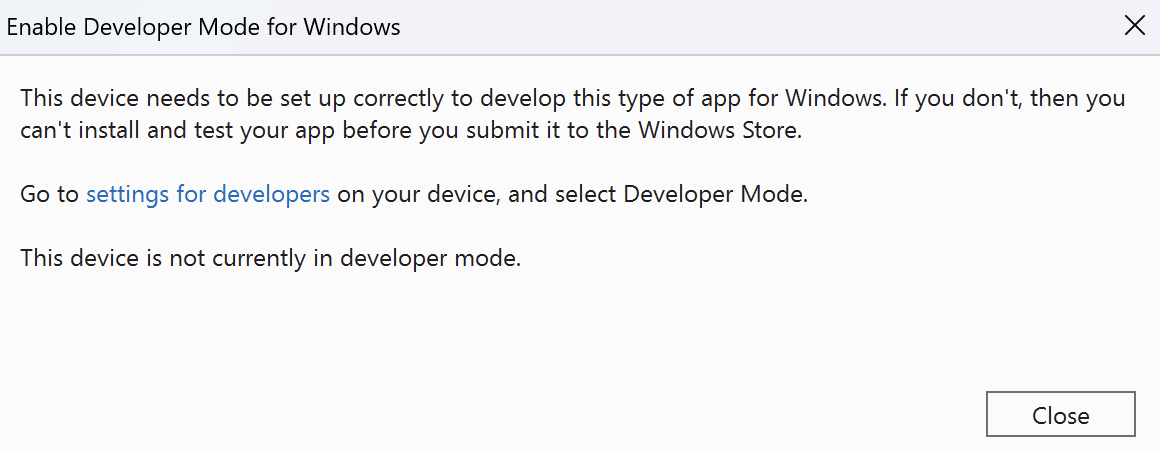

The project creation process may take a few moments. During this process, you might be prompted to enable Developer Mode for Windows. If so, follow the instructions shown to enable Developer Mode:
Image Alt Text:fig5

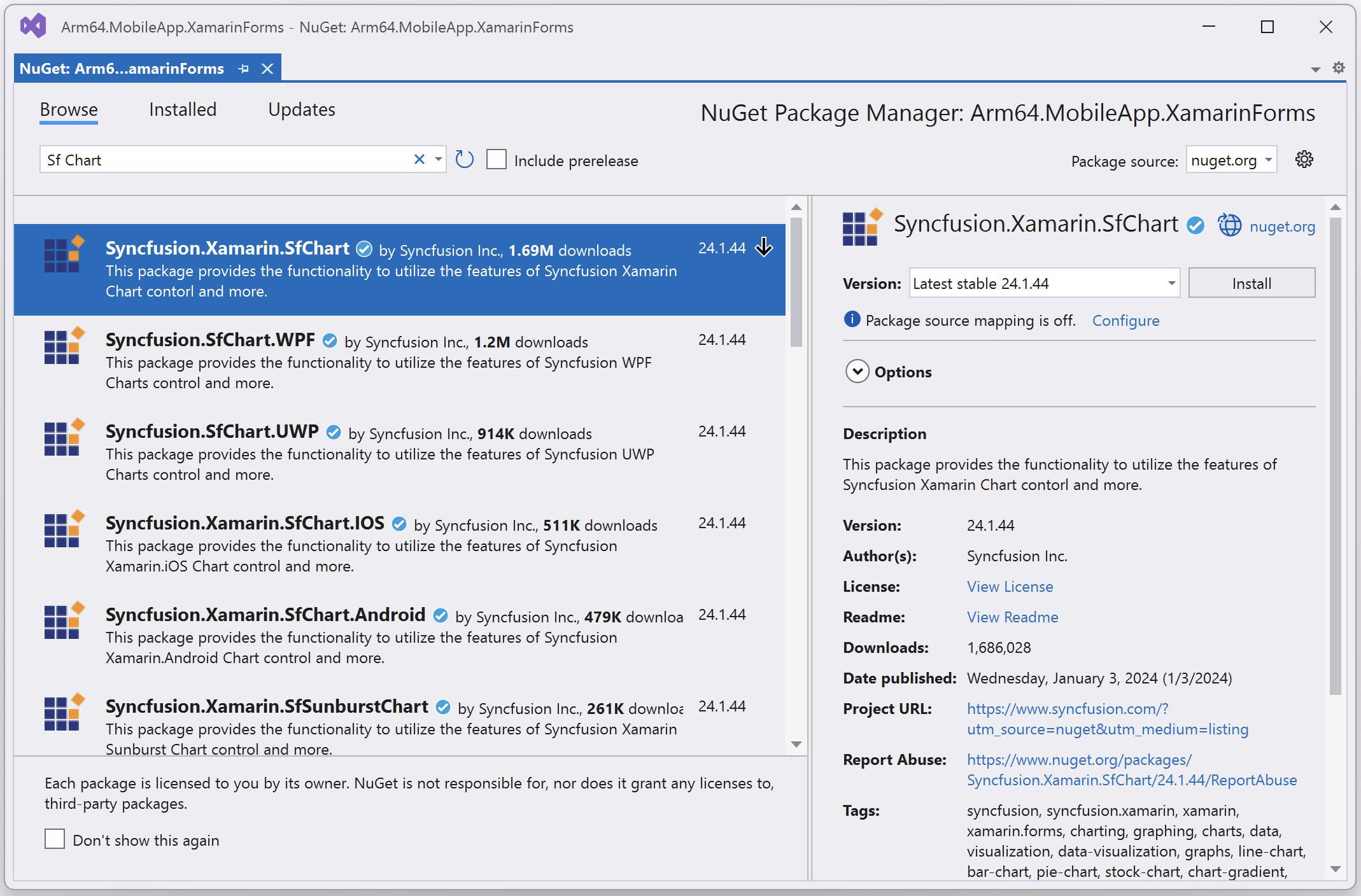

  3. In the NuGet Package Manager, search for ‘Sf chart.’ Then select ‘Syncfusion.SfChart.WPF’ from the results and click the ‘Install’ button. Refer to the figure below for guidance:
Image Alt Text:fig7

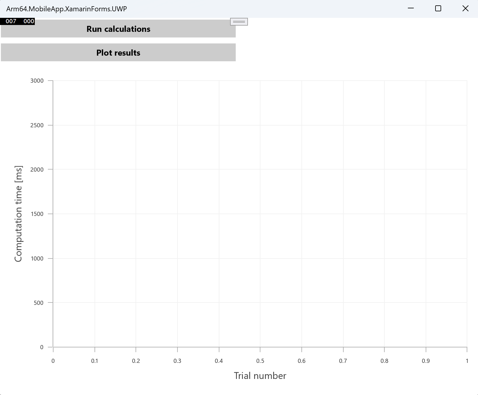

The complete XAML declaration results in the following view:
Image Alt Text:fig8
