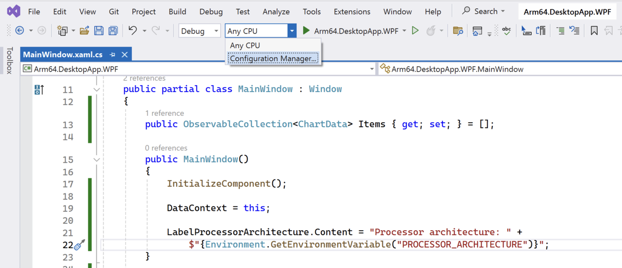

  1. Click the Any CPU drop-down menu and select Configuration Manager…:
Image Alt Text:fig8

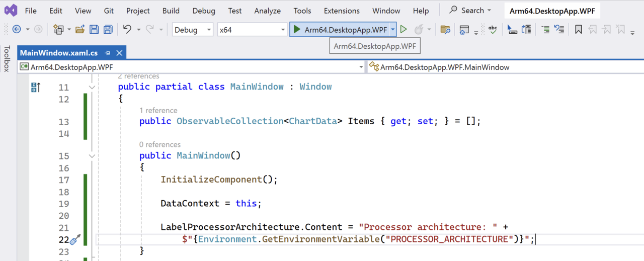

To build and run the application, select the solution platform (for example, x86_64) and then click the Arm64.Desktop.WPF button:
Image Alt Text:fig11
