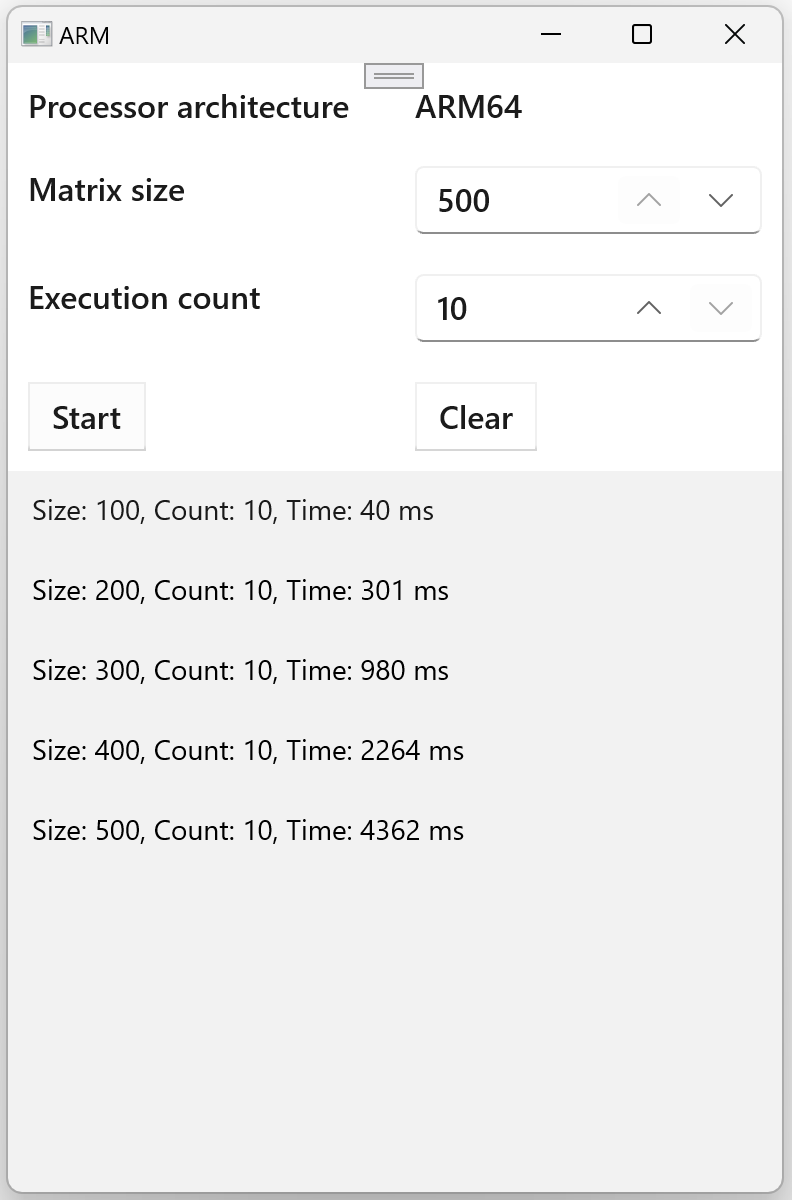

Next, launch the application for the ARM64 platform. Execute matrix multiplication for the same matrix sizes as above and note the computation times:
Upon comparing the execution times, it is seen that ARM64, on average, provides almost a 50% performance improvement over x64.
