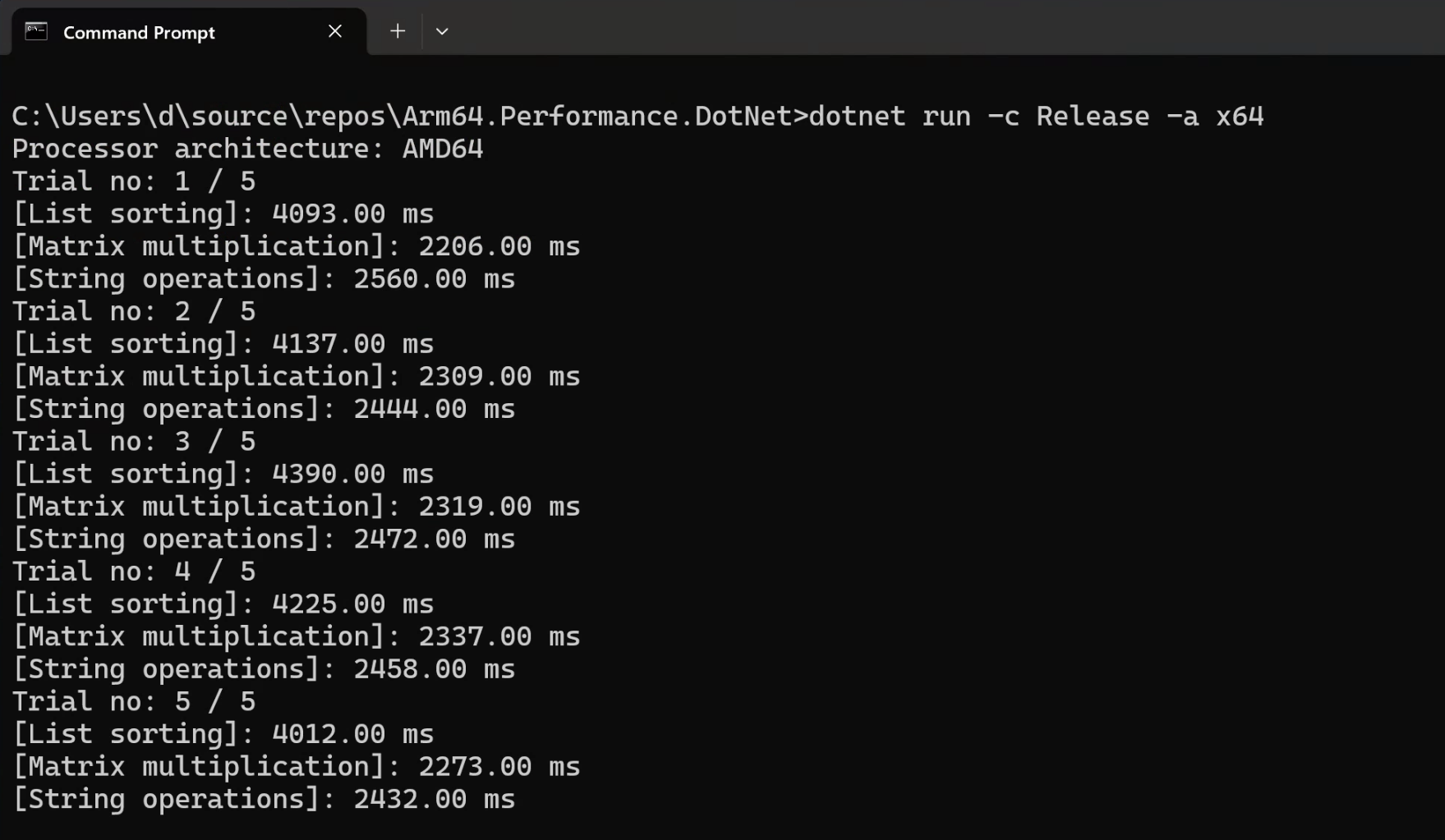

You will now compare execution times to x64 architecture (emulator on arm64) by typing:
dotnet run -c Release -a x64
The above command will lead to significantly longer execution times than before:
Image Alt Text:fig4

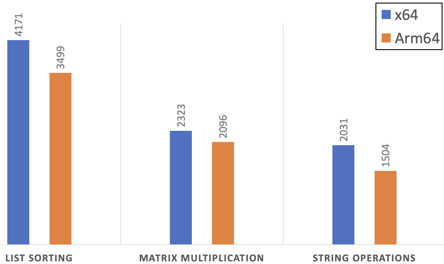

The operations all take more time on the emulated x64 than when you execute them natively on Arm64. On average, native execution provides about a 19% performance improvement for list sorting, 11% for matrix multiplication, and 35% for string operations.
The following chart summarizes the mean execution times for x64 and Arm64’s natively executed code.
Image Alt Text:fig4
