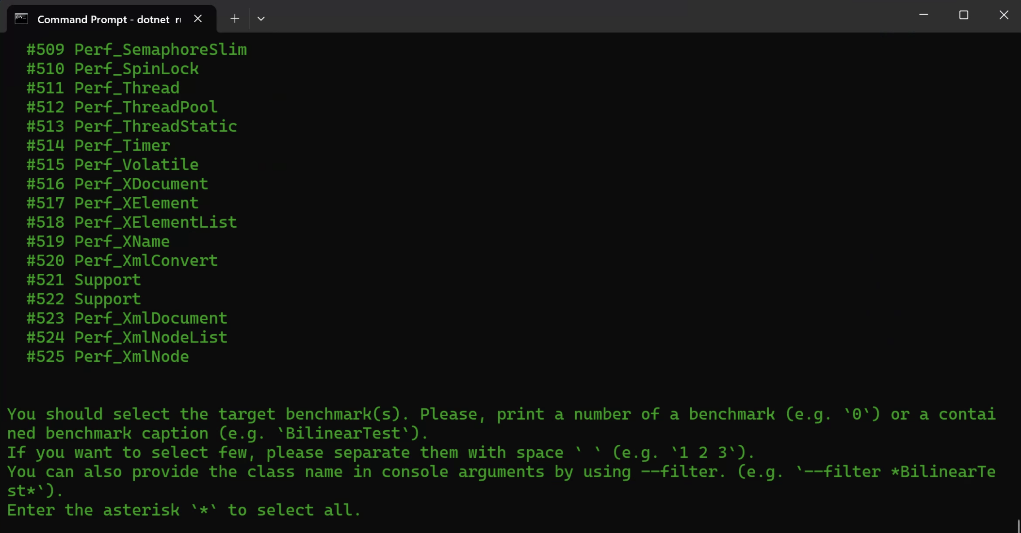

The command will build and run the performance benchmarks. The output will look as follows:
Image Alt Text:fig1

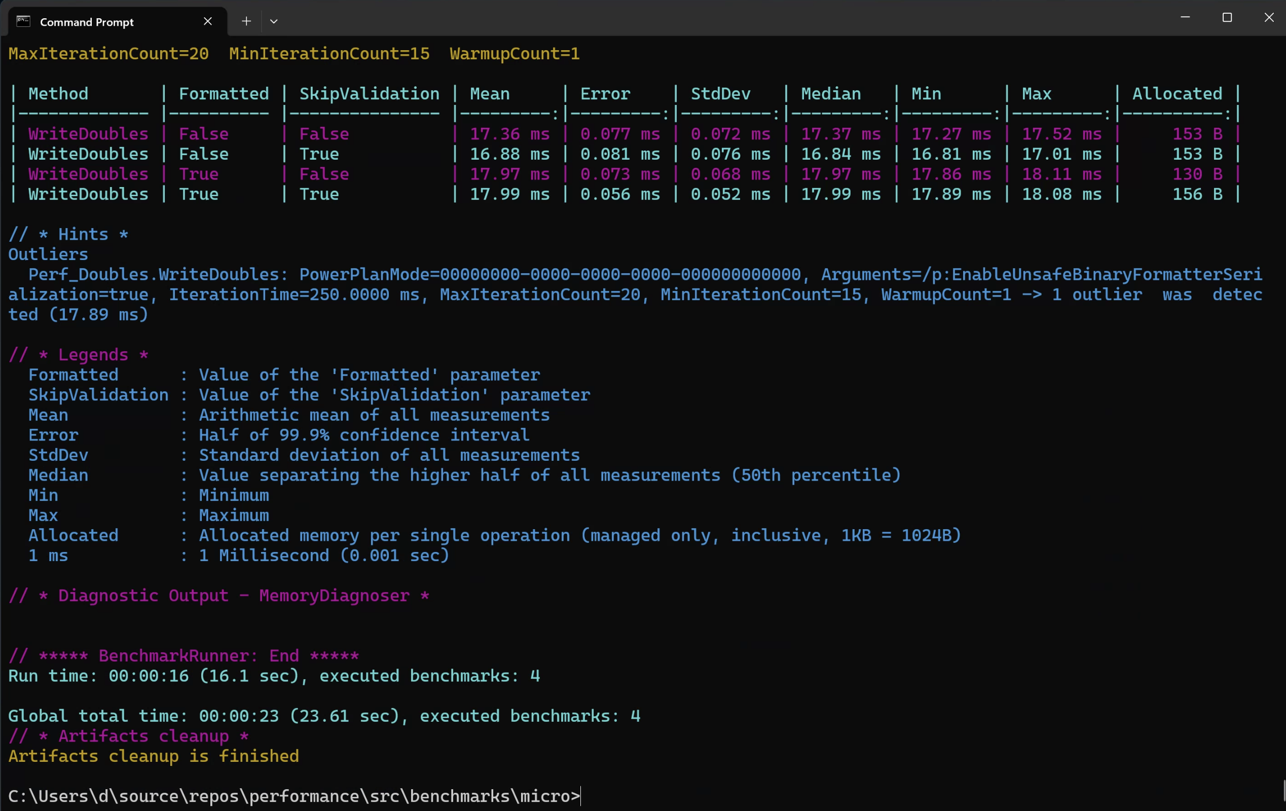

The output lists all available benchmarks. You can type * to run all benchmarks or type a number to select individual performance tests. In this example, let’s type 483 to execute the Perf_Doubles benchmark. After a while you will see a summary of the performance test. A portion of this output is shown in the figure below:
Image Alt Text:fig2
By default, the table summarizes the performance test results. You can see each performance test’s execution time and statistics (mean, median, minimum, maximum, and standard deviation) which gives you a comprehensive overview of code performance.
