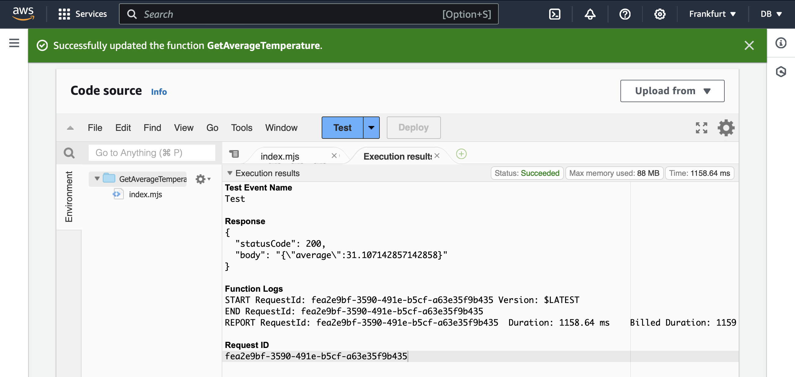

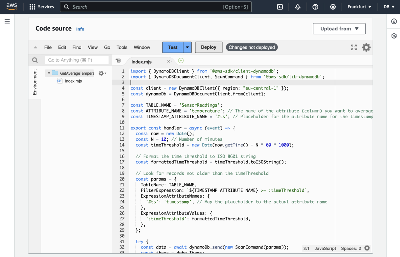

In the GetAverageTemperature function dashboard click the Deploy button:
Image Alt Text:fig5
You can then click the Test button. This will open the Configure test event window, in which you type Test in the Event name and click the Save button. This will take you back to the GetAverageTemperature function dashboard, where you click the Test button again. You will see the execution status, including the average temperature value as shown below:
Image Alt Text:fig6
