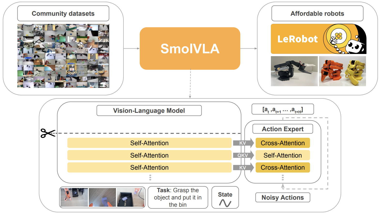

The SmolVLA research paper describes a lightweight vision-language-action model with around 450 million parameters. The model takes camera images, a language instruction, and the robot state as inputs. It then outputs a sequence of robot actions.
Image Alt Text:SmolVLA uses a vision-language model to combine camera images, a task instruction, and robot state. An action expert then denoises an action sequence for the robot to execute.SmolVLA architecture from the research paper

The embedded vision-language model processes and concatenates the inputs into a multimodal sequence of context tokens known as the prefix. It then passes the prefix to the action expert.
LeRobot’s provided SmolVLA checkpoint is configured with the following:
  • Three camera image inputs
  • 48-token instruction padding
  • Ten iterations of flow matching in the action expert
After denoising, the action expert outputs a robot action chunk with shape [1, 50, 32]. The checkpoint uses six action dimensions. Removing the padding leaves a [1, 50, 6] tensor that represents a 50-step trajectory for each action dimension.
