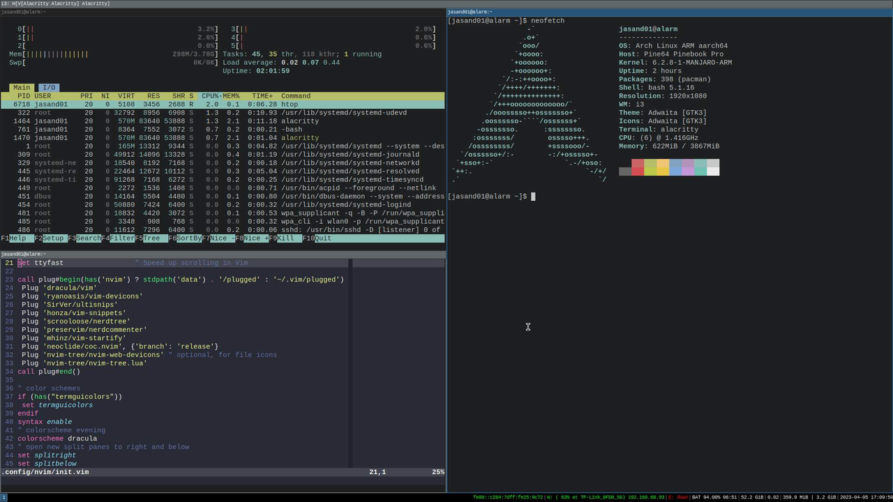

Neovim is a great option for the Pinebook Pro running the i3 window manager.
![i3 window manager](https://learn.arm.com/learning-paths/laptops-and-desktops/pinebook-pro/i3.webp)
