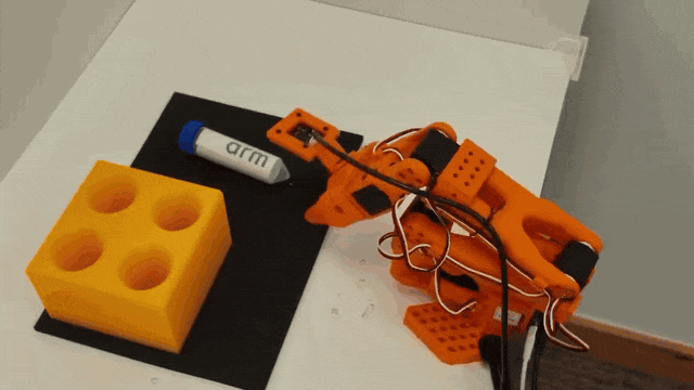

Observe the result
The animation shows an example rollout of the fine-tuned model.
Watch how the follower:
- Moves toward the vial
- Positions the gripper around it
- Closes the gripper
- Moves toward the rack
- Releases the vial
SmolVLA pick-and-place evaluation on the SO-101 follower
A successful rollout should complete the requested task without human intervention. For this example, that means the follower grasps the vial, moves it to the rack, places it inside a rack hole, and releases it safely.
A rollout is unsuccessful if:
- The follower doesn’t grasp the vial
- The vial is dropped
- The vial is released outside a rack hole
- The task isn’t completed before the time limit
- You need to stop or assist the robot
A failed rollout doesn’t necessarily indicate a problem with the command. It might indicate that the starting layout is outside the demonstrated range, the demonstrations were inconsistent, or the model needs additional training.
