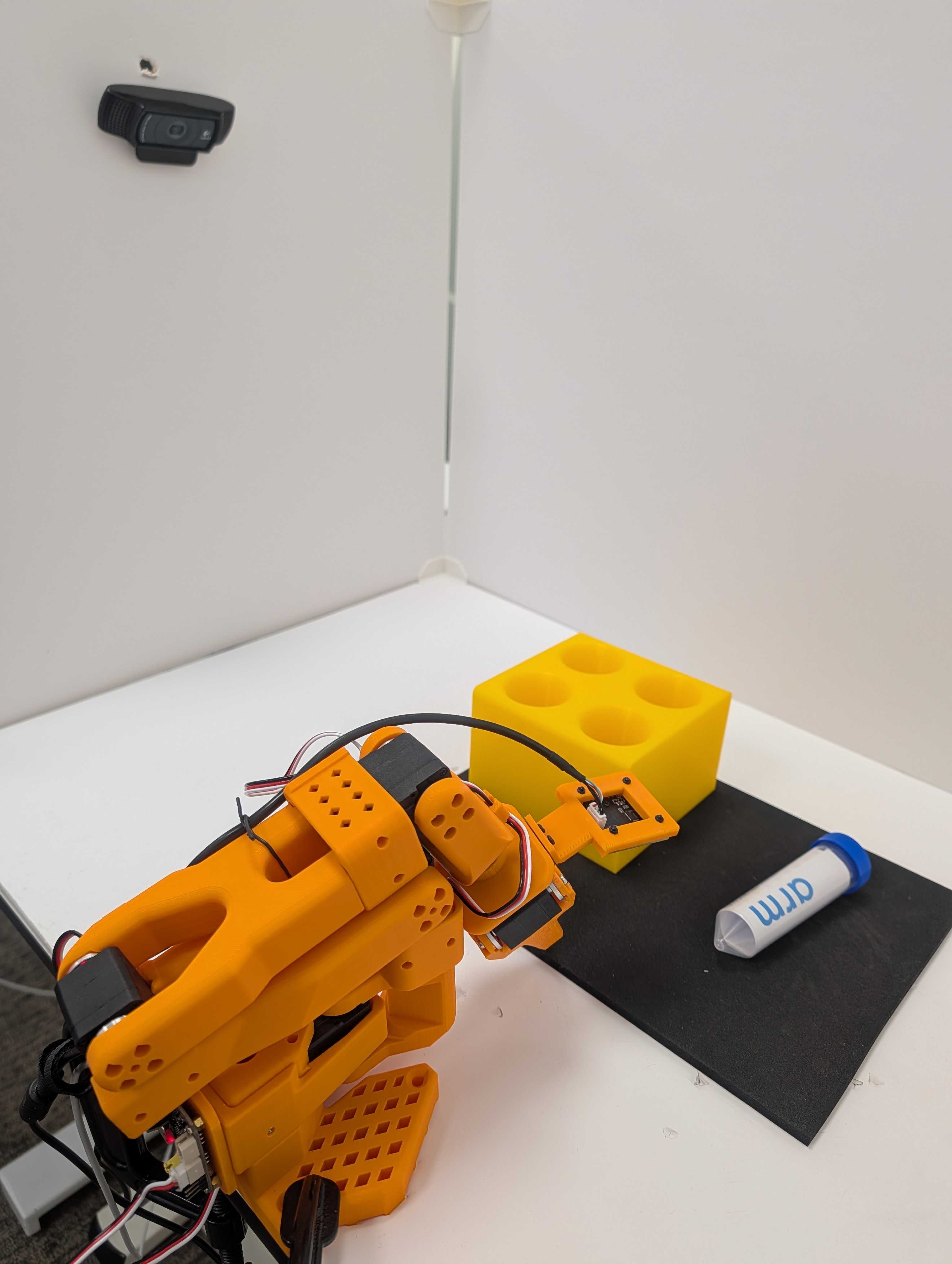

Use the two-camera workspace that you prepared during hardware setup. Lay the vial on the black mat and place the rack beside it, within the follower’s calibrated reach. The mat provides a consistent task area and visual contrast. Leave enough space between the vial and rack for the follower to grasp and move the vial without colliding with the rack.
Image Alt Text:SO-101 follower workspace with one camera mounted near the gripper and a second camera fixed above the table. The fixed camera covers the vial, yellow rack, follower, and motion area while the gripper camera provides the close manipulation view.Two-camera SO-101 workspace

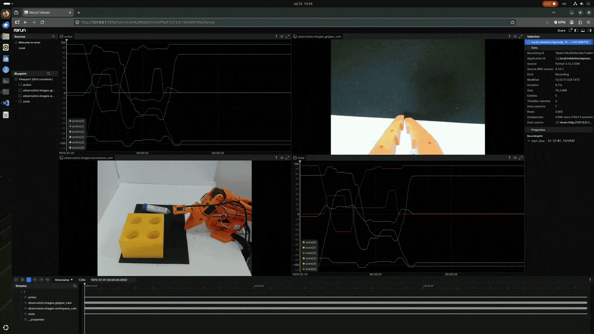

Review an episode with Rerun
Rerun is a visualization toolkit for time-aligned multimodal data. You can use Rerun to scrub camera frames alongside robot state and action plots, making it easier to spot missing images, timing gaps, or unexpected motion.
The lerobot-dataset-viz command launches Rerun with the recorded camera, state, and action data:
lerobot-dataset-viz \
  --repo-id $DATASET_REPO_ID \
  --root $LOCAL_DATASET_ROOT \
  --episode-index 15 \
  --mode distant \
  --host 127.0.0.1 \
  --web-port 9090 \
  --grpc-port 9876 \
  --display-compressed-images
Note
The option --display-compressed-images is used for image datasets because uncompressed frames can exceed Rerun’s distant-mode memory buffer and make early images appear blank. Press Ctrl+C after review.
Open http://127.0.0.1:9090 in the DGX Spark desktop browser while the lerobot-dataset-viz command is running, then complete the following steps:
  1. When the browser window opens, select + in the upper-left corner.
  2. Select Open from URL….
  3. Enter rerun+http://127.0.0.1:9876/proxy.
  4. Select Open.
Note
You have to use the browser on the DGX Spark to view the UI. Typically, CORS errors will occur if you try to use a browser on a different or remote desktop instead of the browser on the DGX Spark.
You should now see the following console including your USB camera images as well as data:
Image Alt Text:Rerun Viewer animation showing episode 15 being scrubbed with the gripper and workspace camera panes, action and state plots, and image timelines visible together.Inspecting an episode with LeRobot and Rerun
Press the play button in the lower left-hand portion of the console to play your animation. The animation shows the Rerun view while episode 15 is scrubbed. Both camera panes update with the task, and the action and state plots update as the arm moves.
Scrub from the first frame to the last. Check that the approach, grasp, lift, placement, release, and final pose before the reset period are visible. Reject a dataset with missing camera intervals, abrupt unexplained actions, unsafe motion, or inconsistent task order.
