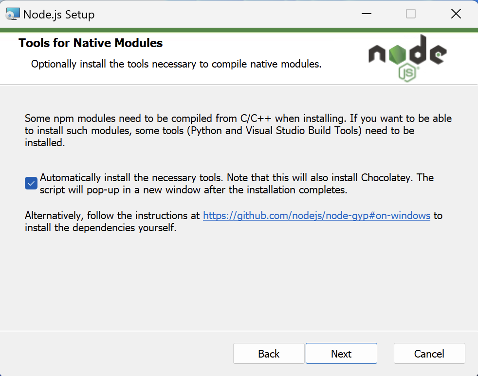

Before you begin, install Node.JS for Arm64. You can find the Node.js installer . In this learning path, you will use version 20.10.0. The installation process is automatic. However, make sure to check the “Automatically install the necessary tools” checkbox so that it automatically installs the build tools for the NPM packages:

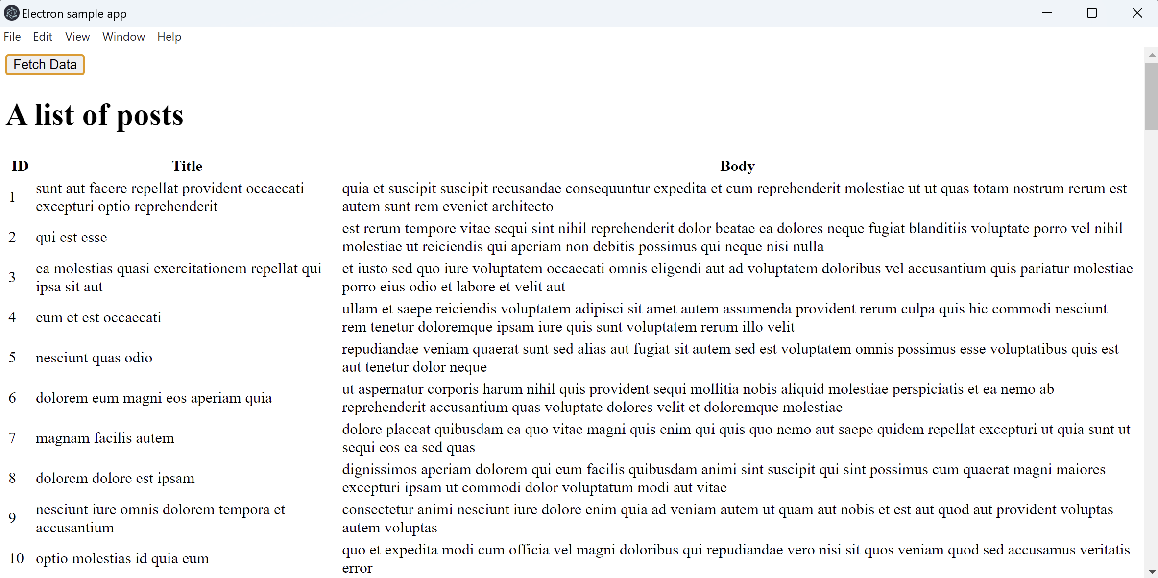

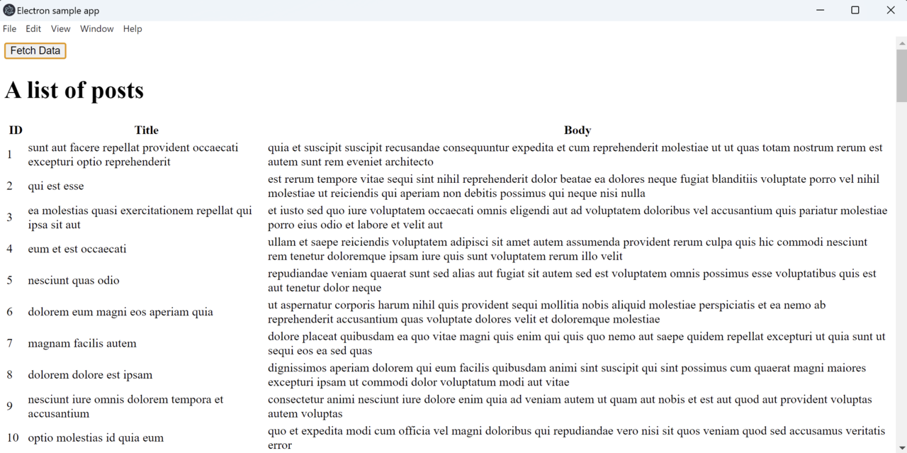

The application window appears. Then click the Fetch data button and you will see the list of posts:

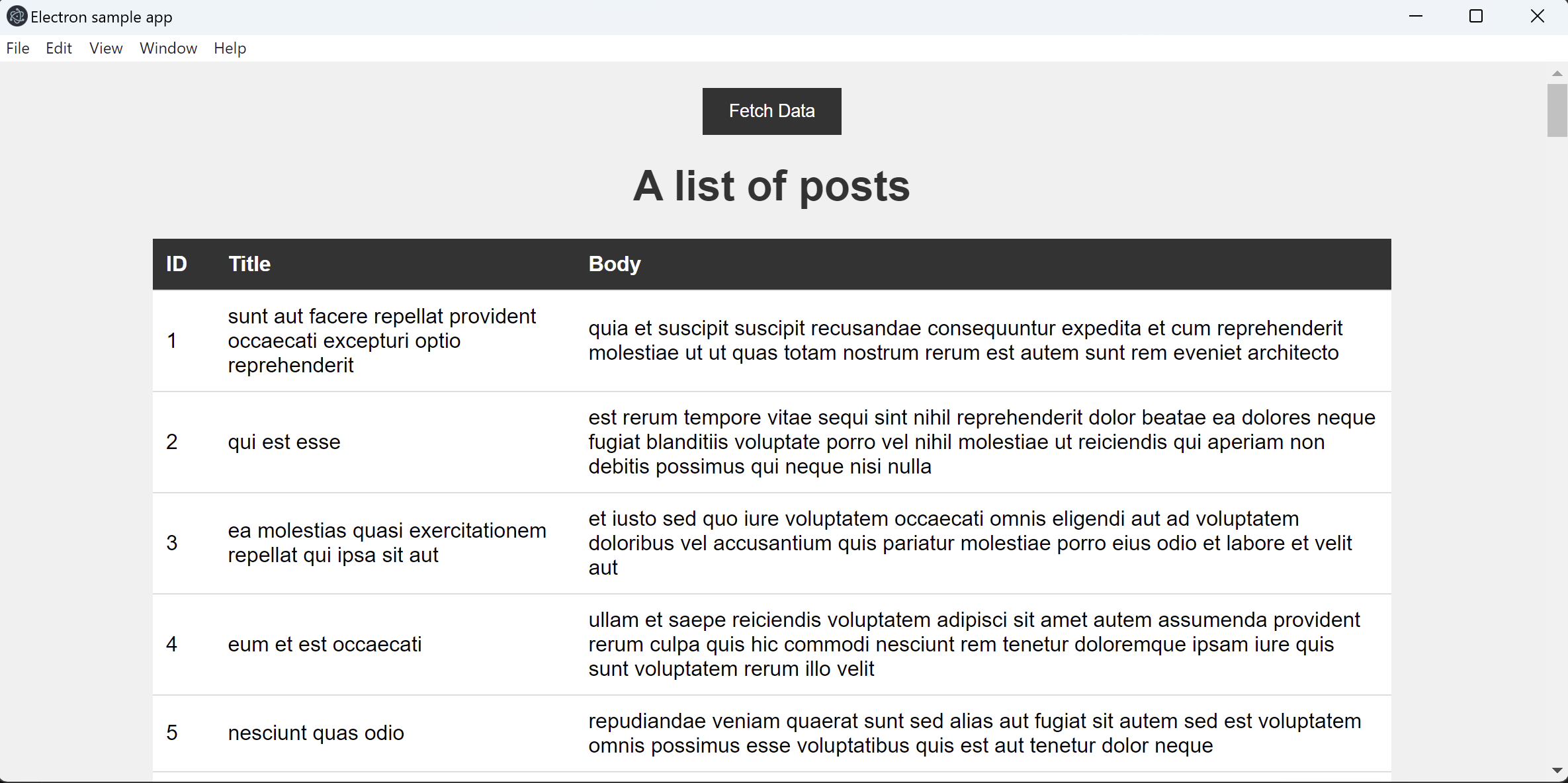

After the application launches, click the Fetch data button and you will see the following result:
Image Alt Text:fig3

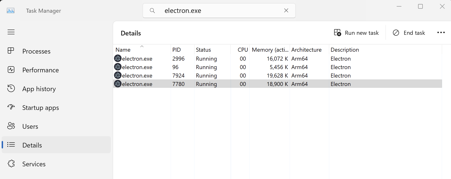

You now have the application up and running. By default, it runs using the Arm64 architecture because we used Node.js for Arm64. To confirm this, open the Task Manager, click the Details tab and look for electron.exe processes:
Image Alt Text:fig4
