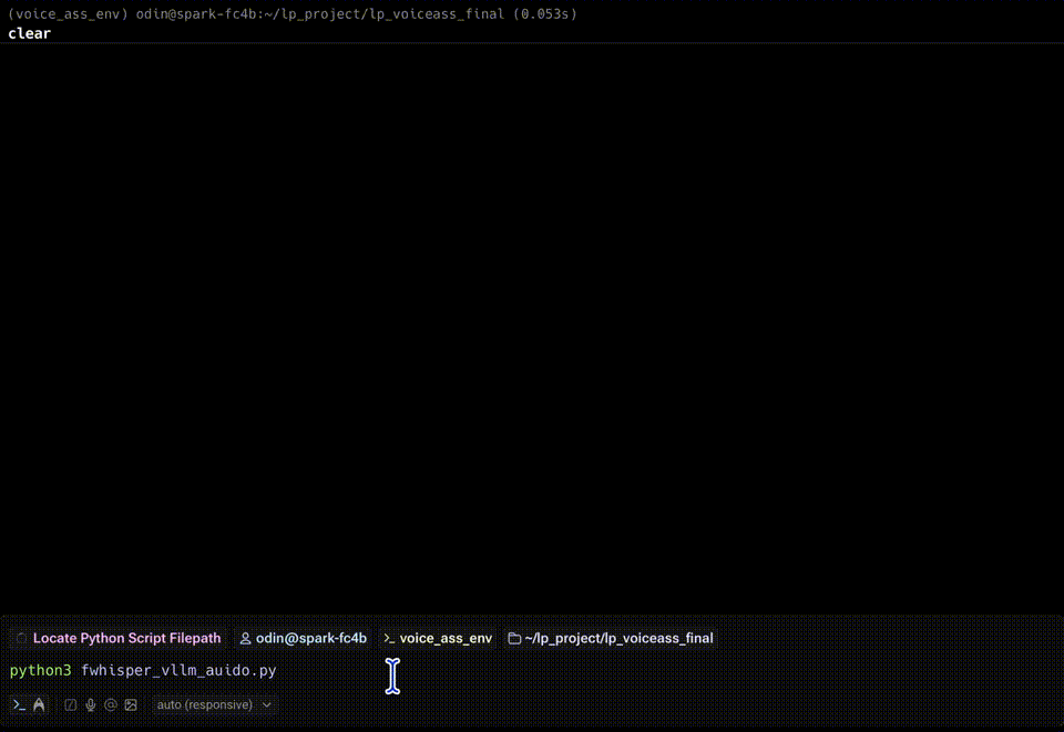

Run the assistant with multi-turn memory:
python3 fwhisper_vllm_audio.py
Once both the STT and LLM services are live, you’ll be able to speak naturally and receive real-time, intelligent responses from the assistant. The assistant will remember previous exchanges in the conversation, allowing for natural multi-turn dialogues without any cloud connection.
Demo: Multi-turn voice chatbot with context memory on DGX Spark
Image Alt Text:Animated terminal session showing real-time speech-to-text transcription and AI responses in a multi-turn customer service conversation, with a volume bar at the bottom indicating live audio input levels from a microphone alt-txtFull function voice-to-AI with volume bar
This demo showcases a fully offline voice assistant that combines real-time transcription (via faster-whisper) and intelligent response generation (via vLLM). Running on an Arm-based DGX Spark system, the assistant captures live audio, transcribes it, and generates context-aware replies using a local language model, all in a seamless loop.
The assistant now supports multi-turn memory, allowing it to recall previous user inputs and its own responses. As shown in the video, this enables natural back-and-forth conversations, such as confirming account details or resolving support requests.
No cloud services are used, ensuring full control, privacy, and low-latency performance.
