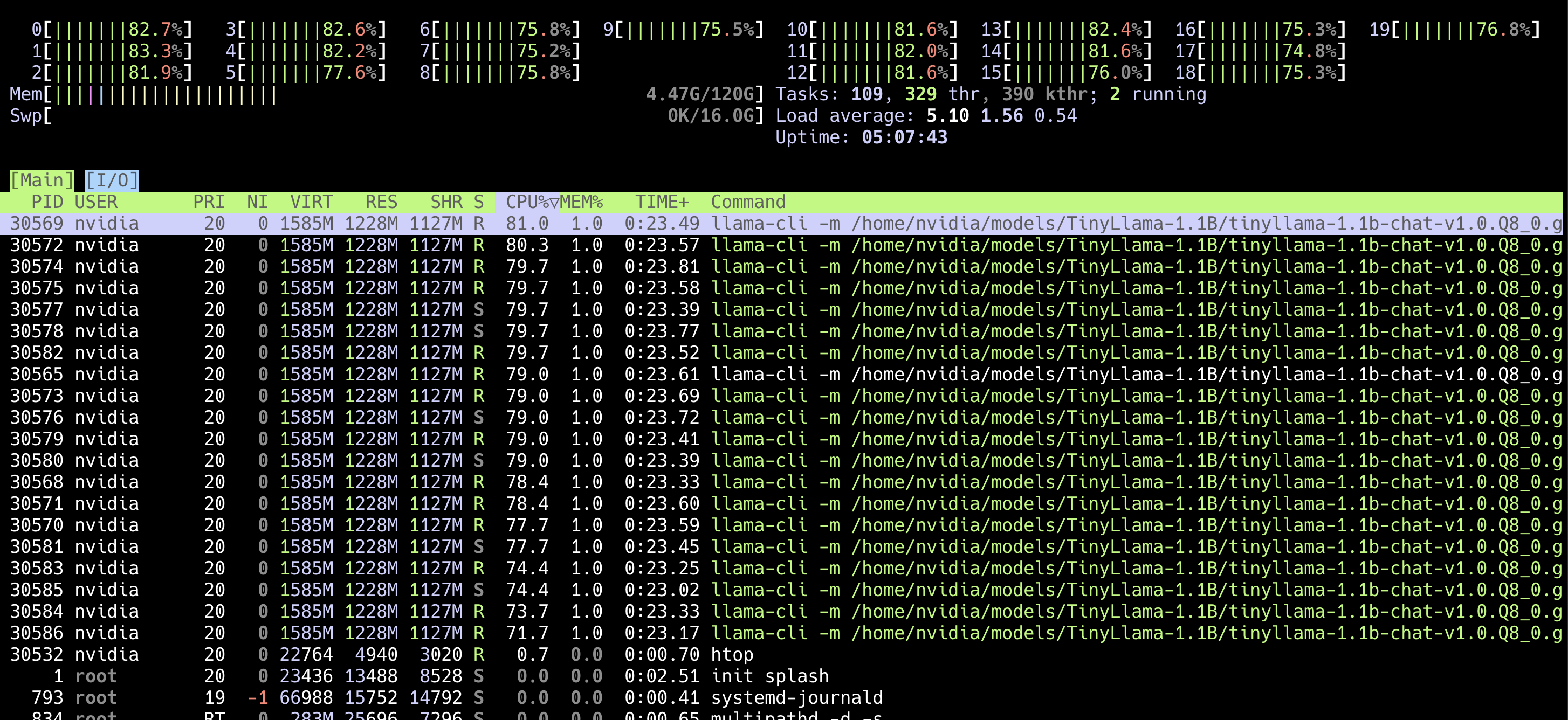

To monitor live CPU utilization and power metrics during inference, use htop:
htop
The following screenshot shows CPU utilization and thread activity during TinyLlama inference on DGX Spark, confirming full multi-core engagement: Image Alt Text:htop display showing 20 Grace CPU cores at 75-85% utilization during TinyLlama inference with OpenMP threading alt-textTinyLlama CPU utilization
The htop interface shows:
  • CPU Utilization: all 20 cores operate between 75–85%, confirming efficient multi-thread scaling
  • Load Average: around 5.0, indicating balanced workload distribution
  • Memory Usage: approximately 4.5 GB total for the TinyLlama Q8_0 model
  • Process List: displays multiple llama-cli threads (each 7–9% CPU), confirming OpenMP parallelism
Note
In htop, press F6 to sort by CPU% and verify load distribution, or press t to toggle the tree view, which shows the llama-cli main process and its worker threads.
