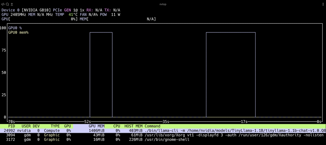

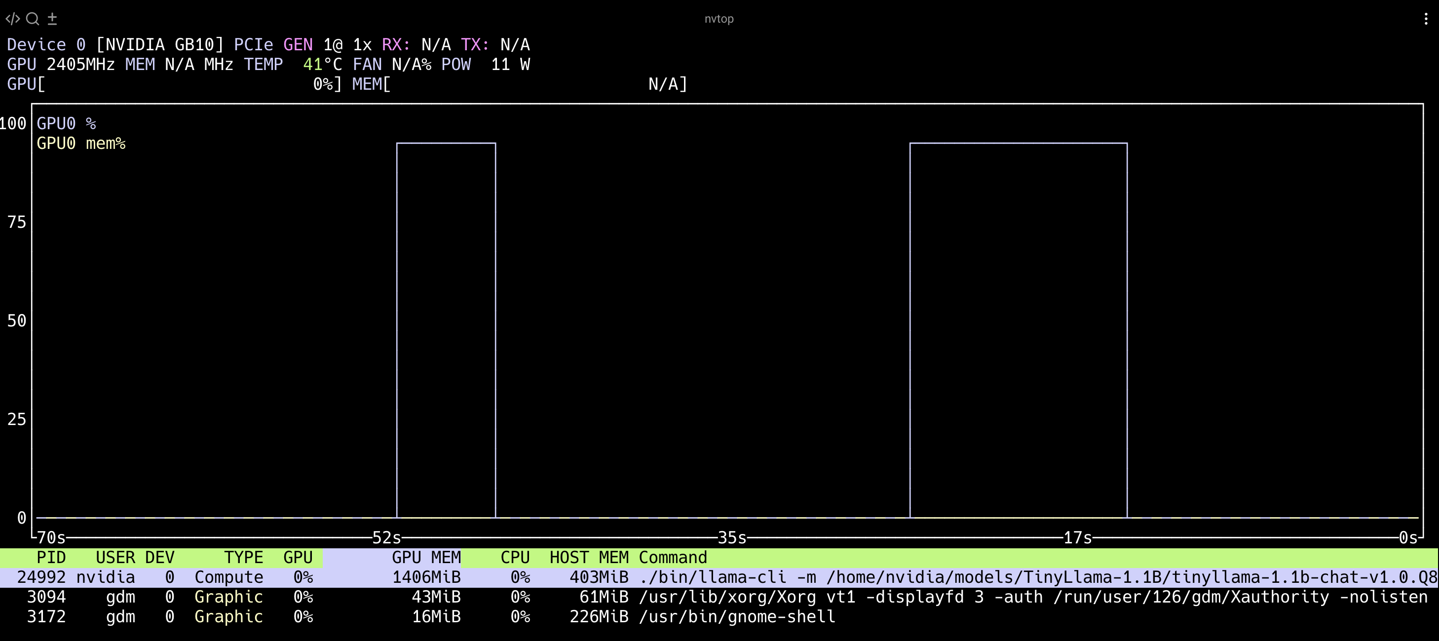

The following screenshot shows GPU utilization during TinyLlama inference on DGX Spark:
Image Alt Text:nvtop terminal interface displaying real-time GPU metrics, including GPU utilization, memory usage, temperature, power consumption, and active processes for the NVIDIA GB10 GPU during model inference on DGX Spark. alt-textTinyLlama GPU Utilization
The nvtop interface shows:
  • GPU Utilization (%): Confirms CUDA kernels are active.
  • Memory Usage (VRAM): Shows model loading and runtime footprint.
  • Temperature / Power Draw: Monitors thermal stability under sustained workloads.
