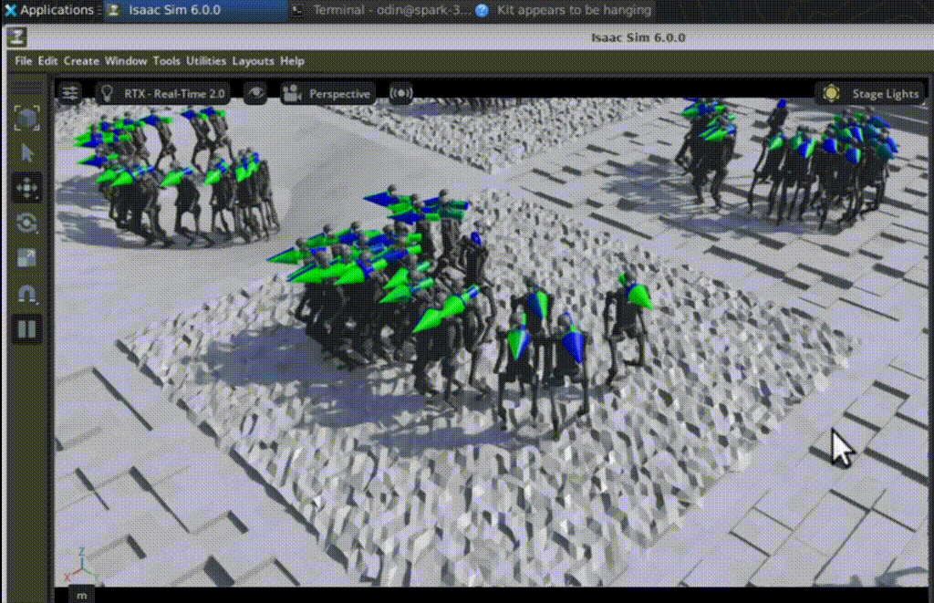

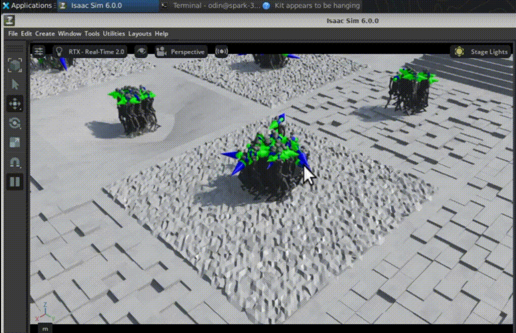

The following visualizations compare two training stages using num_envs=512, showcasing the benefit of large-scale parallel training on DGX Spark.
Iteration 50 (Early Stage, num_envs=512)
At iteration 50, the policy is still in its exploration phase. Most robots exhibit noisy joint actions, lack coordination, and frequently fall. There is no observable response to the velocity command, and no stable gait has emerged.
Image Alt Text:img3 alt-textEarly Stage
Iteration 1350 (Late Stage, num_envs=512)
By iteration 1350, the policy has matured. Most robots demonstrate coordinated walking behavior, balance maintenance, and accurate velocity tracking, even on rough terrain. The improvement in foot placement and heading stability is clearly visible.
