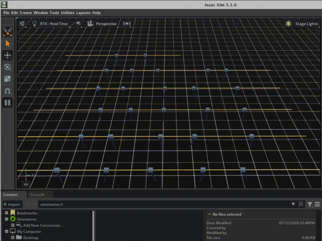

./isaaclab.sh -p scripts/tutorials/01_assets/run_articulation.py
This script loads a robot model, advances the physics simulation, and prints joint states to the terminal. It demonstrates:
  • Loading a robot from a USD (Universal Scene Description) asset file
  • Configuring joint actuators and control modes
  • Stepping the physics simulation and reading back joint positions and velocities
Image Alt Text:img1 alt-textrun_articulation.py

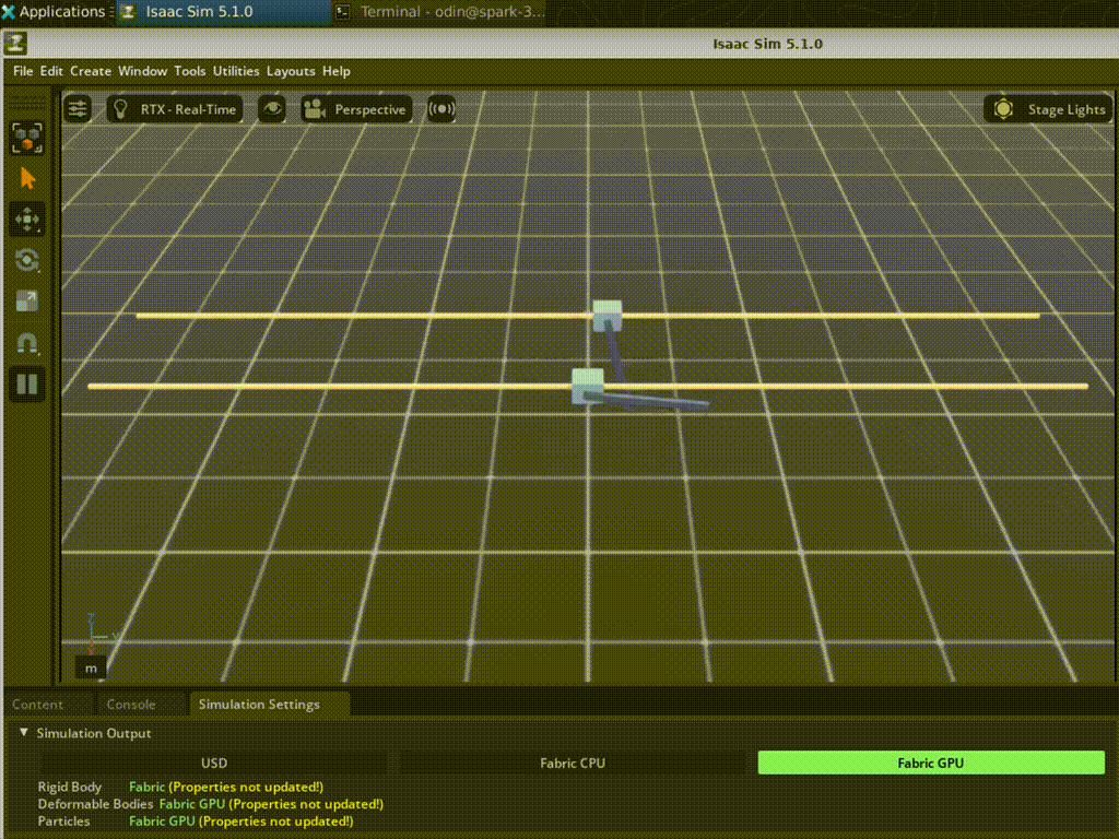

The create_cartpole_base_env.py tutorial creates a Cartpole environment and applies random actions to the cart. Running multiple environments in parallel allows reinforcement learning algorithms to collect experience more efficiently. Run the following command:
./isaaclab.sh -p scripts/tutorials/03_envs/create_cartpole_base_env.py --num_envs 32
This command launches 32 parallel Cartpole environments on the Blackwell GPU. Each environment runs its own independent simulation with random joint efforts applied to the cart. You’ll see the pole joint angle printed to the terminal for each step.
Image Alt Text:img2 alt-text32 parallel Cartpole
Note
This tutorial script uses a hardcoded CartpoleEnvCfg configuration. It does not accept a --task argument. The --num_envs flag controls how many parallel environments are spawned on the GPU.
