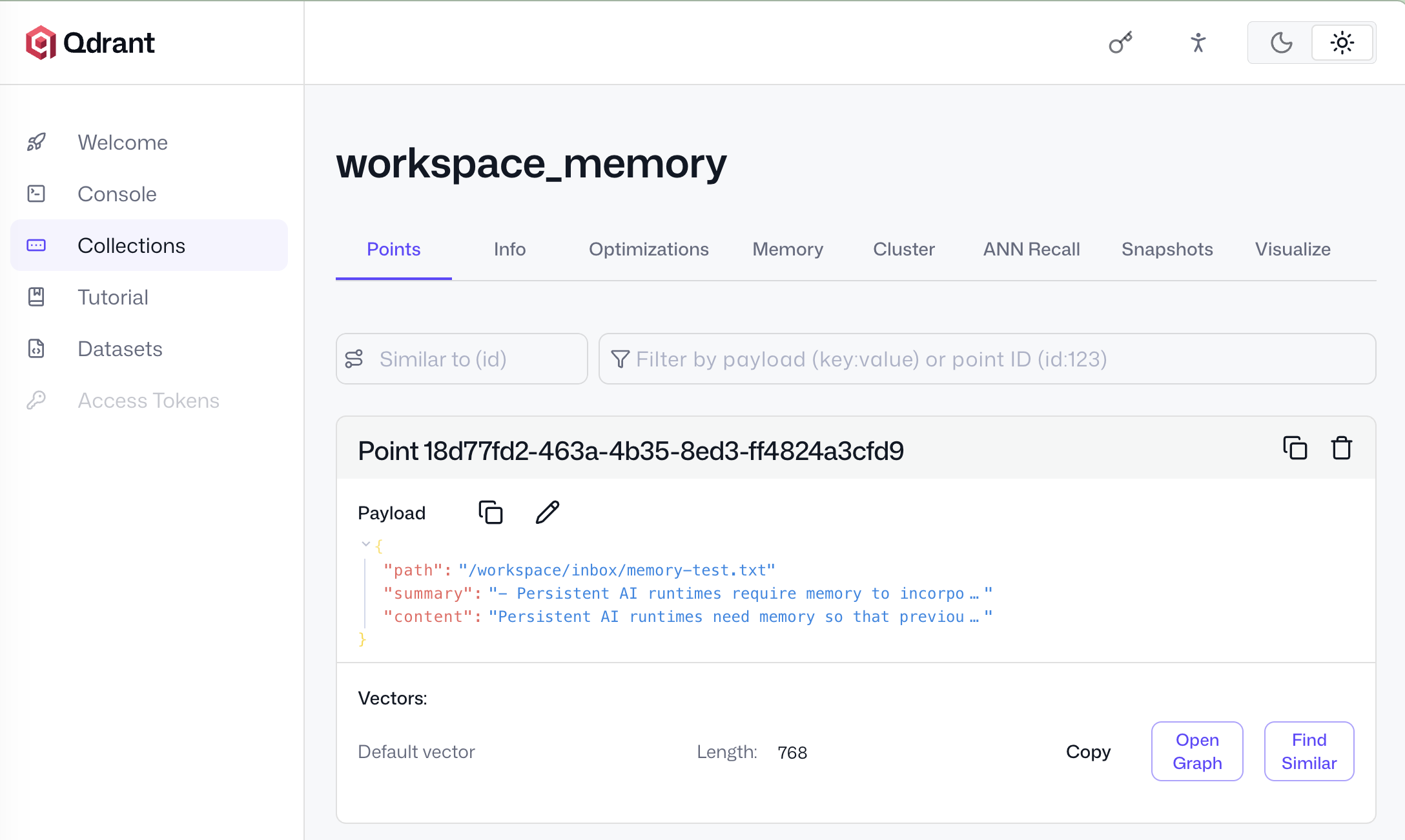

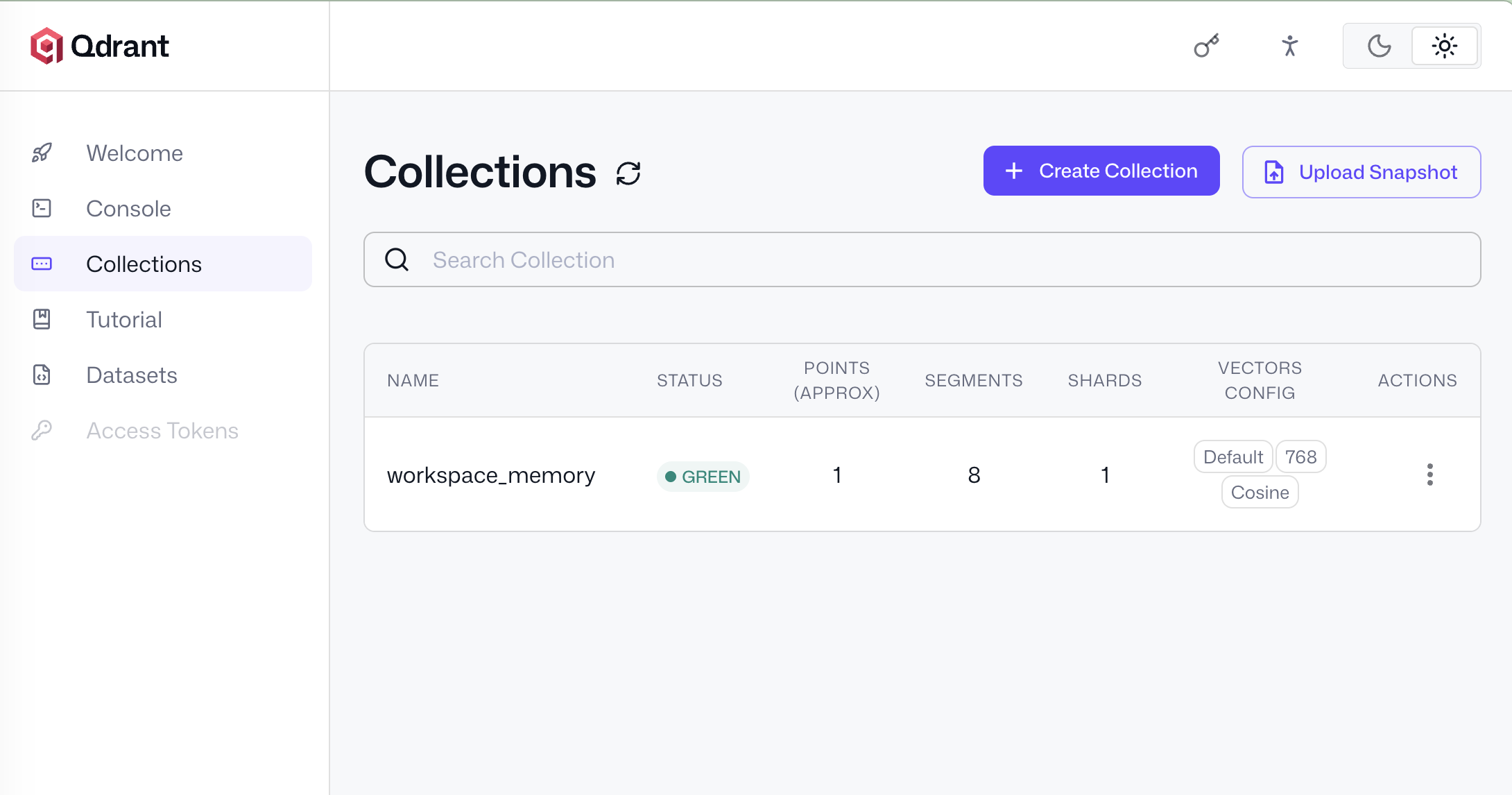

### Verify Qdrant memory
Open the Qdrant dashboard:
[http://localhost:6333/dashboard](http://localhost:6333/dashboard)
Confirm that the `workspace_memory` collection exists:
![Qdrant Dashboard](https://learn.arm.com/learning-paths/laptops-and-desktops/dgx_persistent_agent/qdrant_dashboard_2.png)
The dashboard shows the `workspace_memory` collection after Hermes starts and runs `ensure_collection()`. If the collection doesn’t appear, check the Hermes logs for Qdrant connection errors and confirm that the `qdrant` container is running.
Open the collection and verify that points are being stored. Each point represents one ingested workspace document and contains:
- A 768-dimensional vector
- A `path` payload field
- A `summary` payload field
- A `content` payload field
![Qdrant workspace_memory vector and payload view](https://learn.arm.com/learning-paths/laptops-and-desktops/dgx_persistent_agent/qdrant_dashboard_3.png)
Use this view to confirm that Qdrant has stored both the vector and payload metadata. The payload fields are important because later retrieval steps need the path and summary to assemble useful context for the LLM.

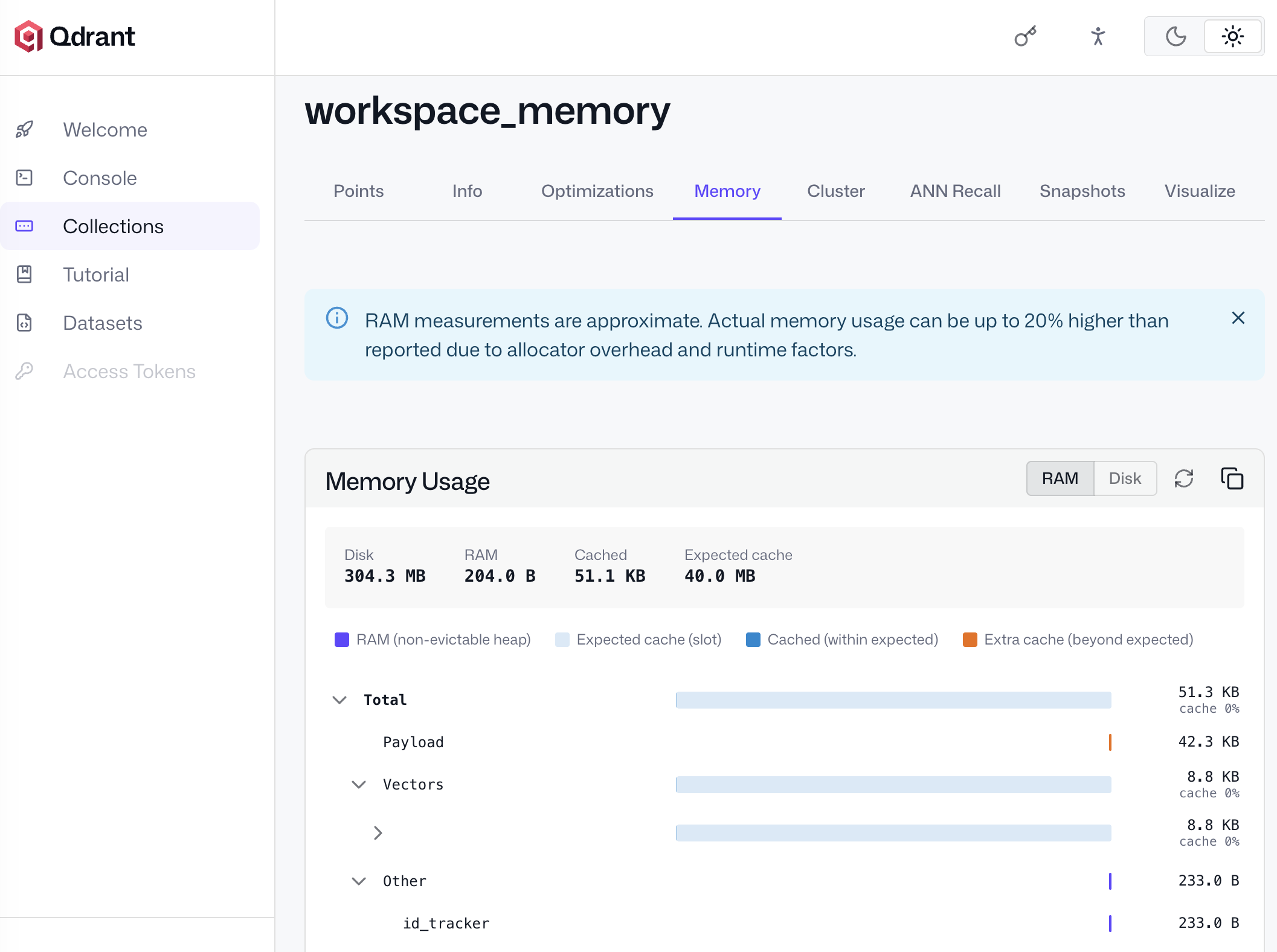

You can also inspect collection storage and memory usage:
![Qdrant workspace_memory memory usage view](https://learn.arm.com/learning-paths/laptops-and-desktops/dgx_persistent_agent/qdrant_dashboard_4.png)
The memory usage view confirms that Qdrant is maintaining persistent collection state on disk. This matters because the vector memory survives container restarts as long as the `../qdrant:/qdrant/storage` volume remains mounted.
