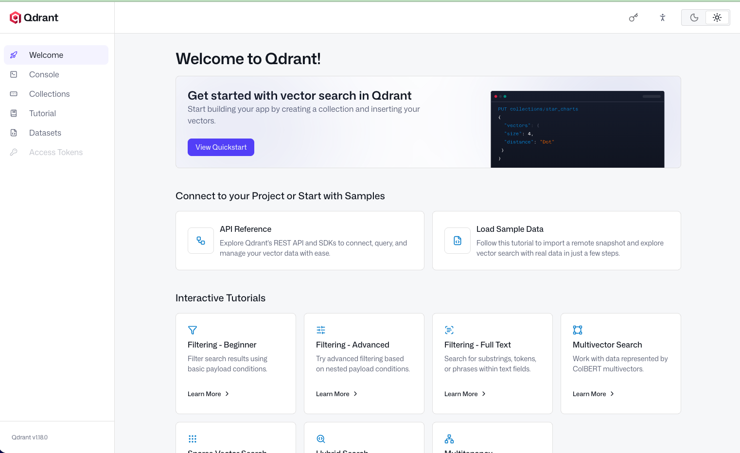

  qdrant:
    image: qdrant/qdrant:latest
    container_name: qdrant
    ports:
      - "6333:6333"
      - "6334:6334"
    volumes:
      - ../qdrant:/qdrant/storage
    restart: unless-stopped

This Compose stack creates the first three runtime services. You’ll add Hermes as a fourth service later. The explicit DNS settings in the Ollama service help the container reach the model registry reliably. You’ll verify this in the networking step.
### Understand the role of each runtime service
The initial stack separates model execution, memory storage, and user interaction.
| Service | Role |
| Ollama  | Runs local language and embedding models |
| Qdrant  | Stores persistent vector memory |
| Open WebUI | Provides a local browser interface to Ollama |
The `models/` directory persists Ollama models on the host. The `qdrant/` directory persists vector database storage. The `workspace/` directory is mounted into Ollama now and will also be mounted into Hermes later.

### Verify Qdrant
Open the Qdrant dashboard:
http://localhost:6333/dashboard
Qdrant is running, but it doesn’t contain the `workspace_memory` collection yet. Hermes creates that collection later when you add persistent memory.
