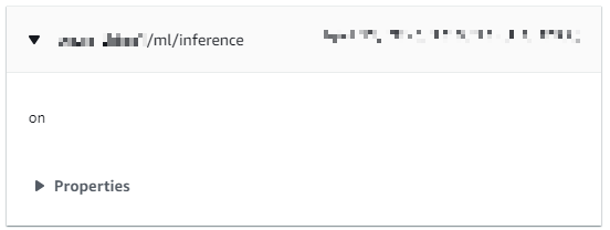

Run with MQTT connectivity
Rebuild and run the keyword application.
./ats.sh build-n-run keyword
The messages are shown in the terminal as well as in MQTT test client .
        ML_HEARD_ON
109 27329 [ML_MQTT] [INFO] Publish to the MQTT topic <thingname>/ml/inference.
Image Alt Text:keyword

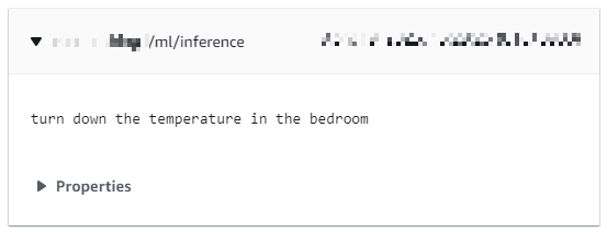

Repeat with the speech example
Build and run the speech example.
./ats.sh build-n-run speech
Observe the output on the terminal and your MQTT console.
        INFO - Complete recognition: turn down the temperature in the bedroom
134 14506 [ML_MQTT] [INFO] Publish to the MQTT topic <thingname>/ml/inference.
Image Alt Text:speech
