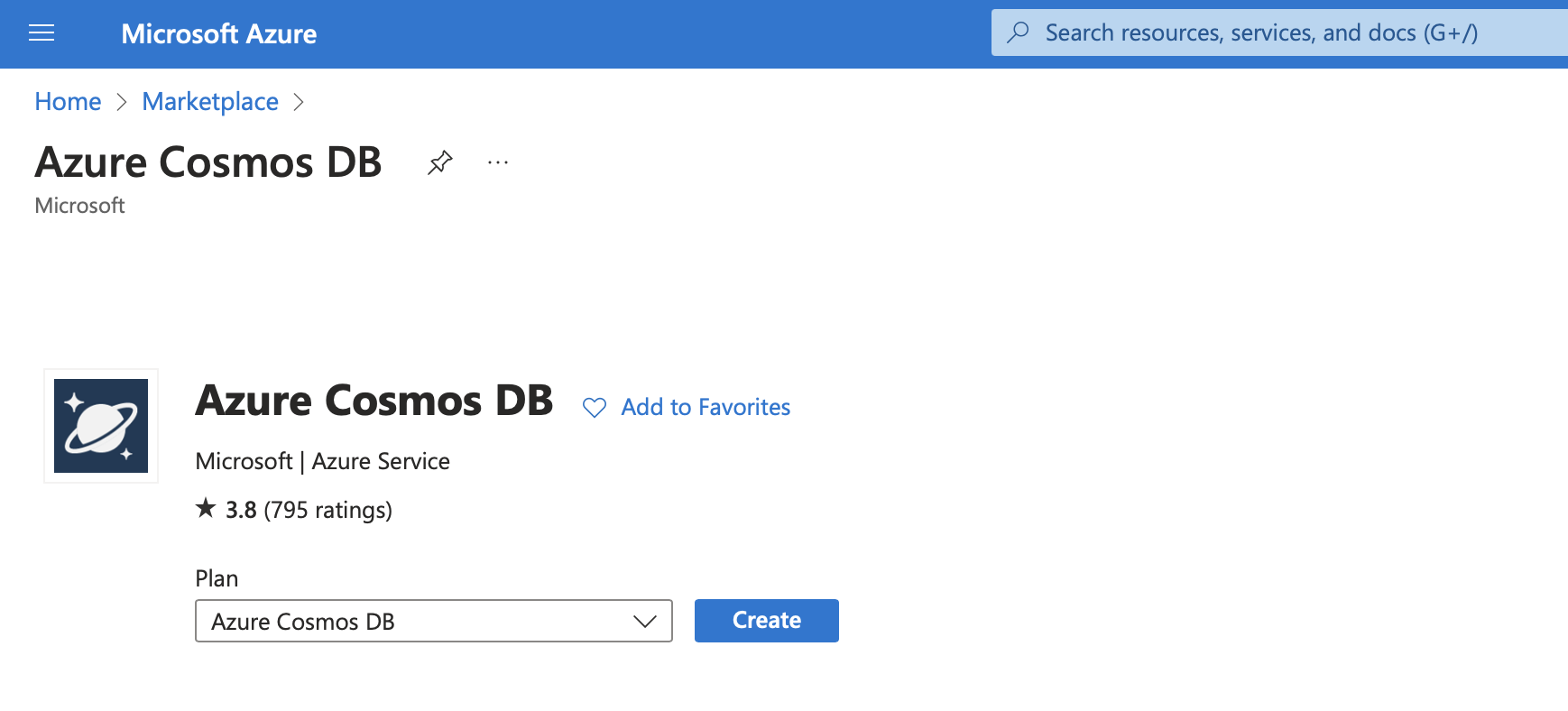

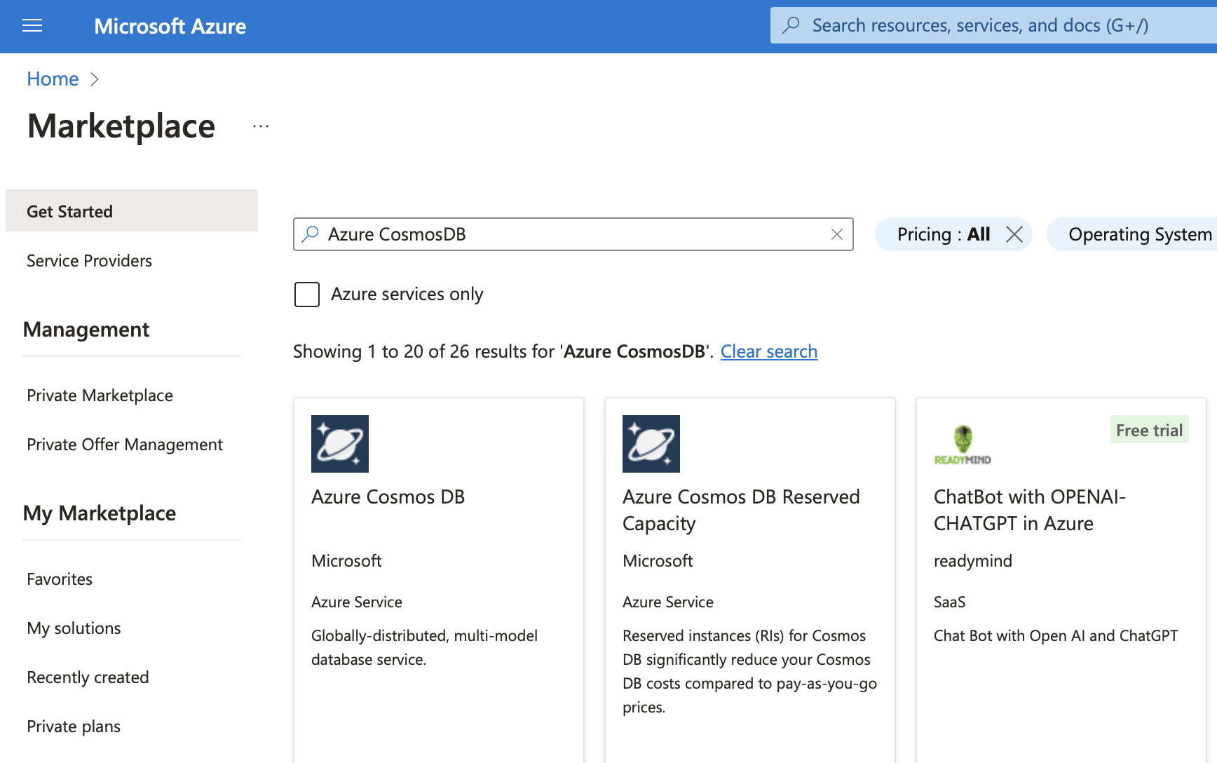

  2. Select Create a resource, search for “Azure Cosmos DB”, and click Create: Image Alt Text:img14 alt-text Image Alt Text:img15 alt-text

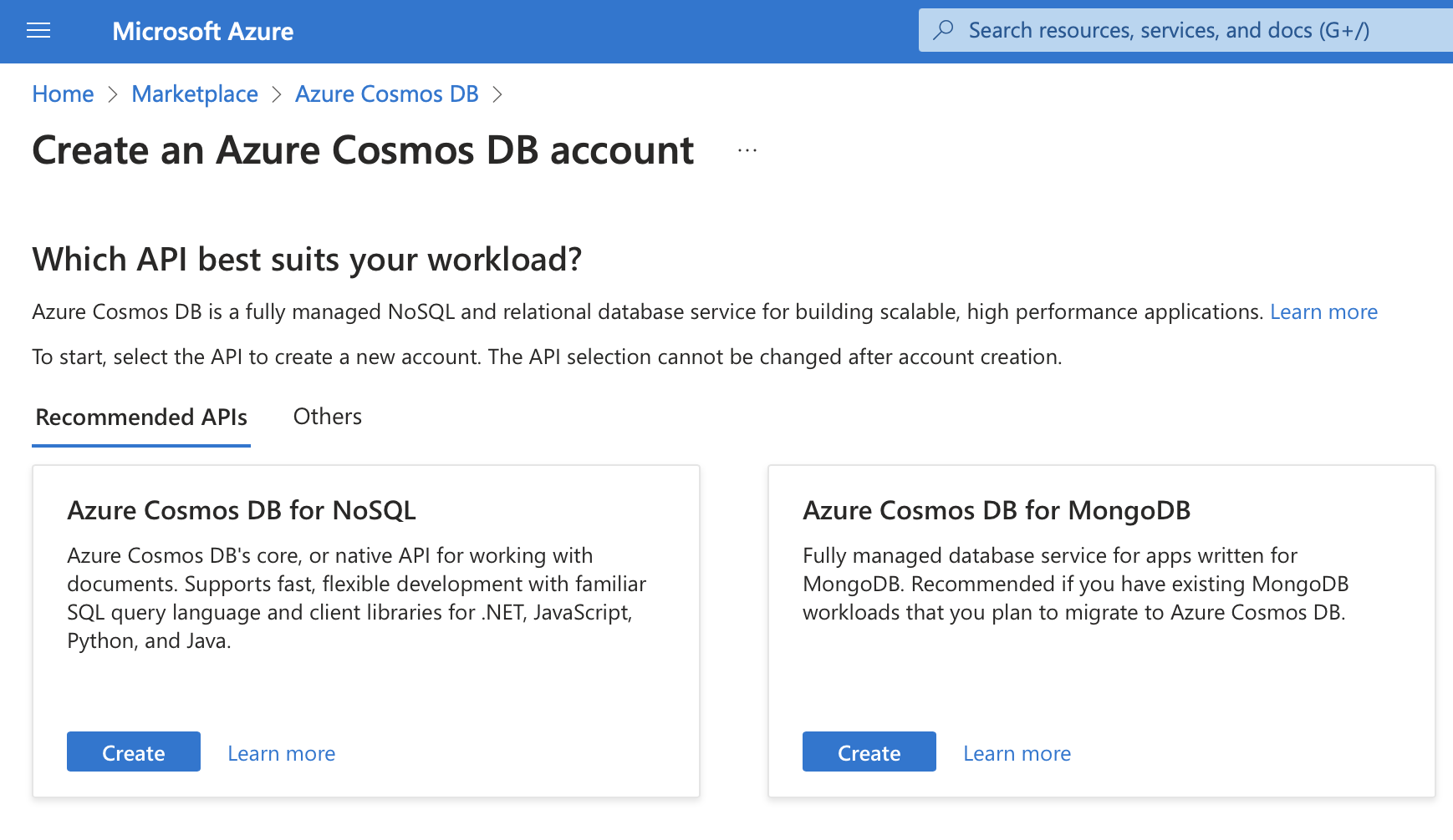

  3. Select Azure Cosmos DB for NoSQL, then click Create. Image Alt Text:img16 alt-text

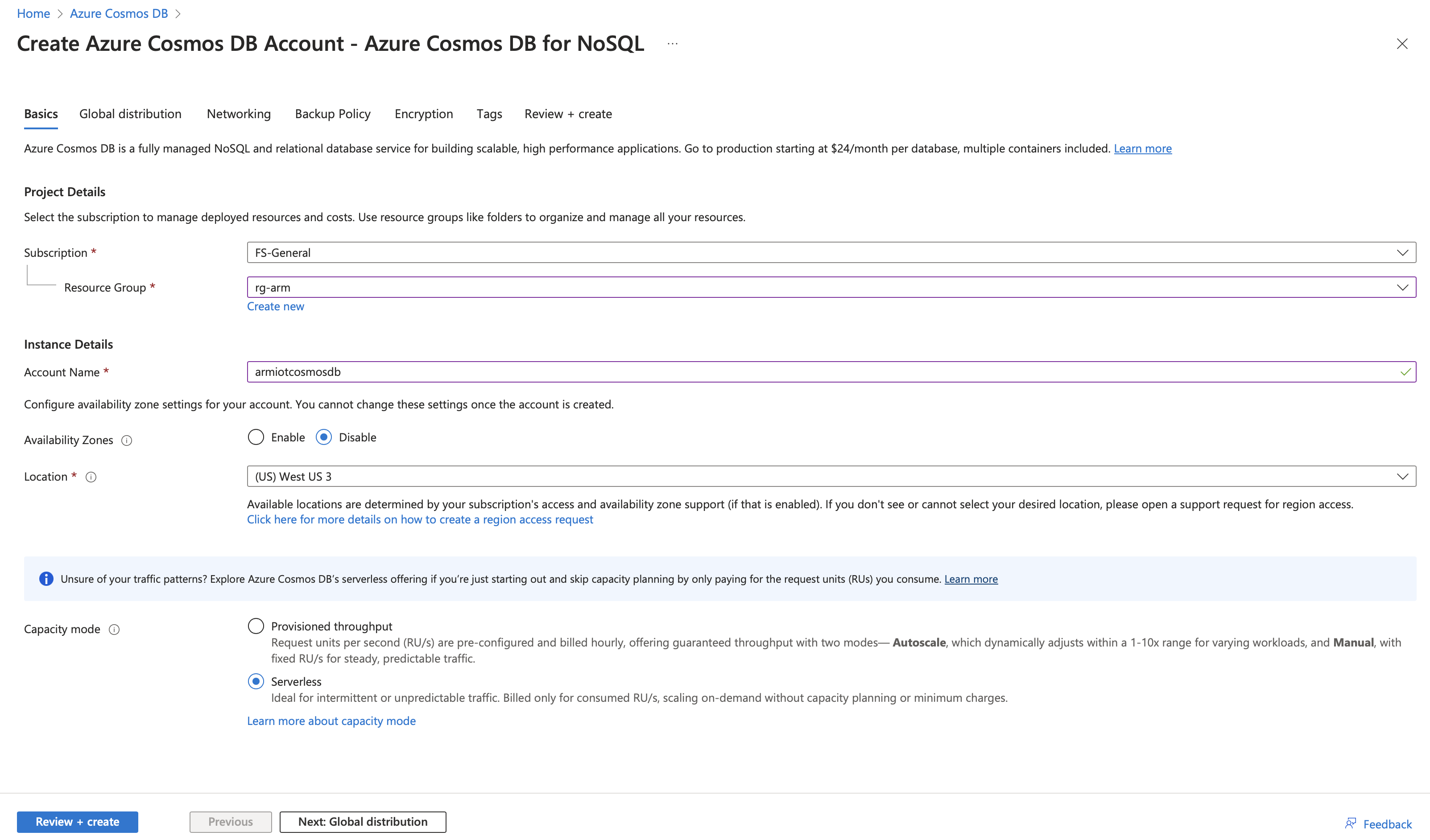

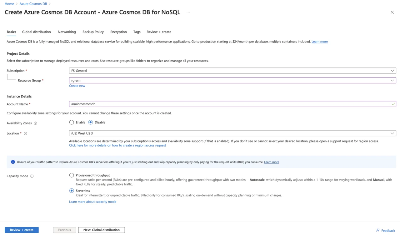

  4. Fill in the required details:
  • Subscription: select your subscription.
  • Resource Group: use your existing IoT resource group or create a new one.
  • Account Name: provide a unique name (for example, armiotcosmosdb).
  • Availability Zones: disable.
  • Region: choose the same region as your IoT Hub and Stream Analytics job.
  • Select serverless as capacity mode.
  • Apply Free Tier Discount: apply
  • Check Limit total account throughput. Image Alt Text:img17 alt-text
  1. Click Review + create, then click Create.

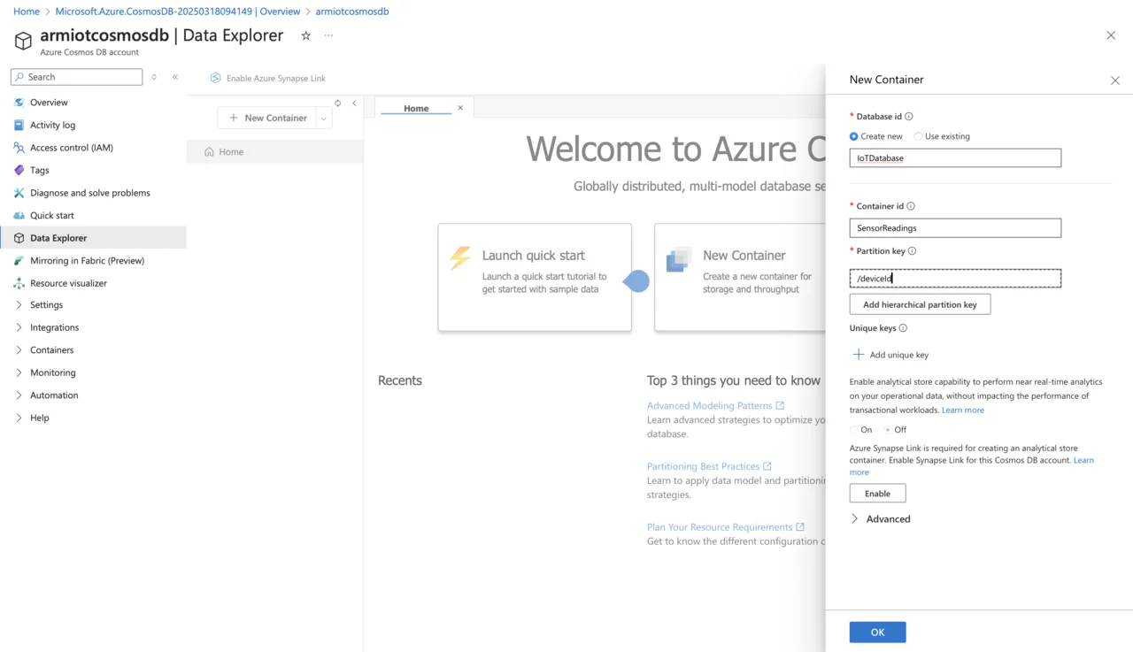

Once the deployment completes:

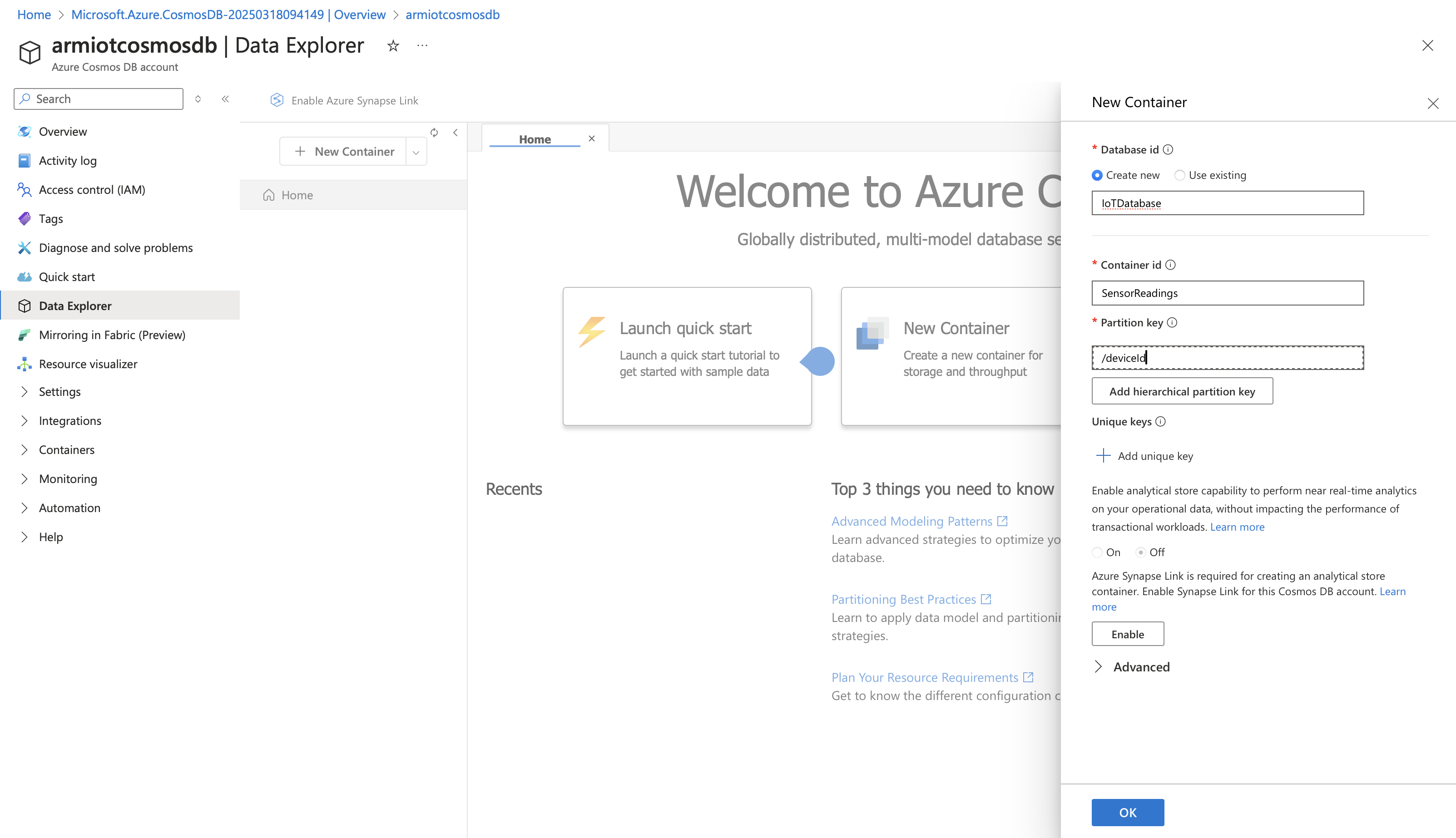

  • Navigate to your Cosmos DB account and select Data Explorer.
  • Click New Container, then create a database with a name such as “IoTDatabase”, and create a container named “SensorReadings”.
  • Select an appropriate partition key (recommended: /deviceId).
  • Enable analytical store capability to perform near real-time analytics on your operational data, without impacting the performance of transactional workloads: Off.
  • Click OK. Image Alt Text:img18 alt-text

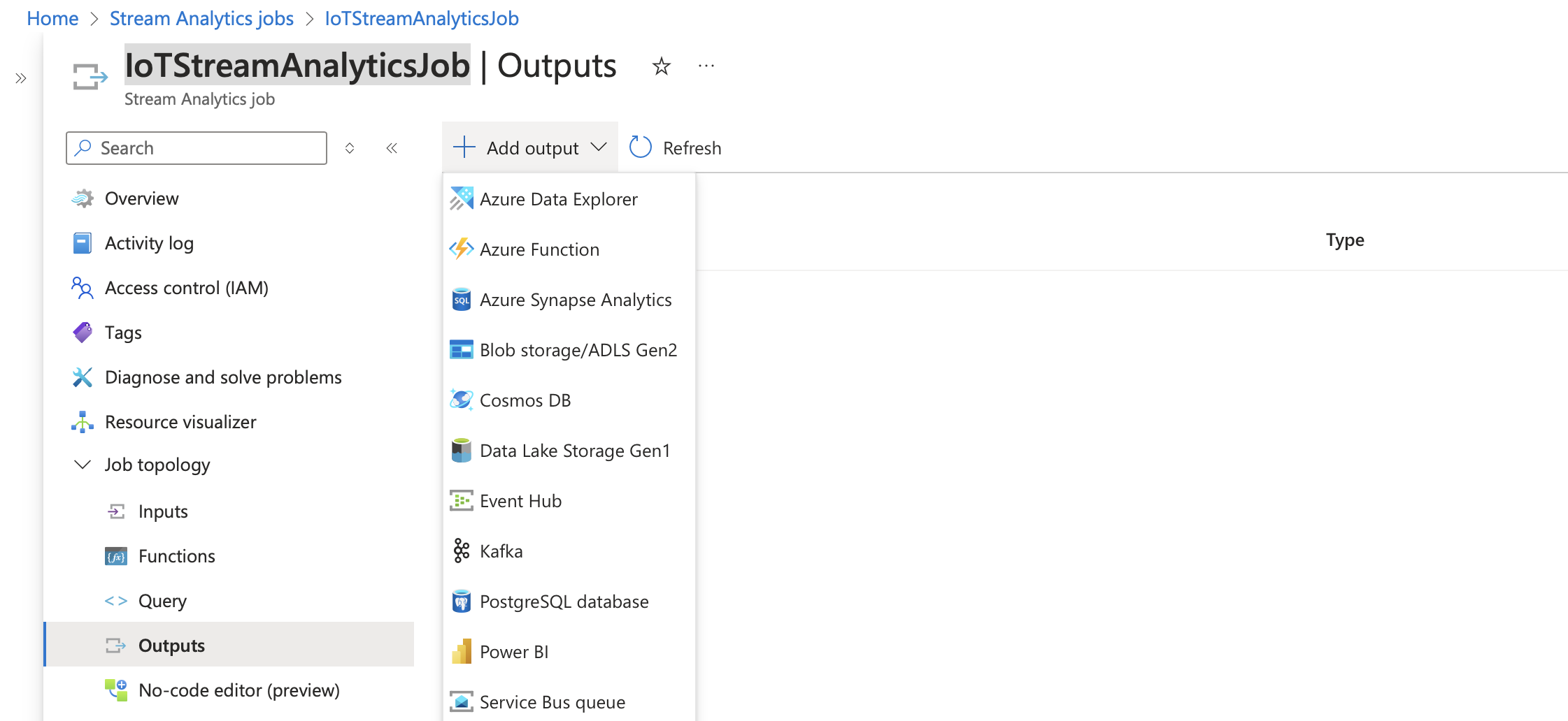

  1. Go to IoTStreamAnalyticsJob.
  2. Under Job topology, select Outputs.

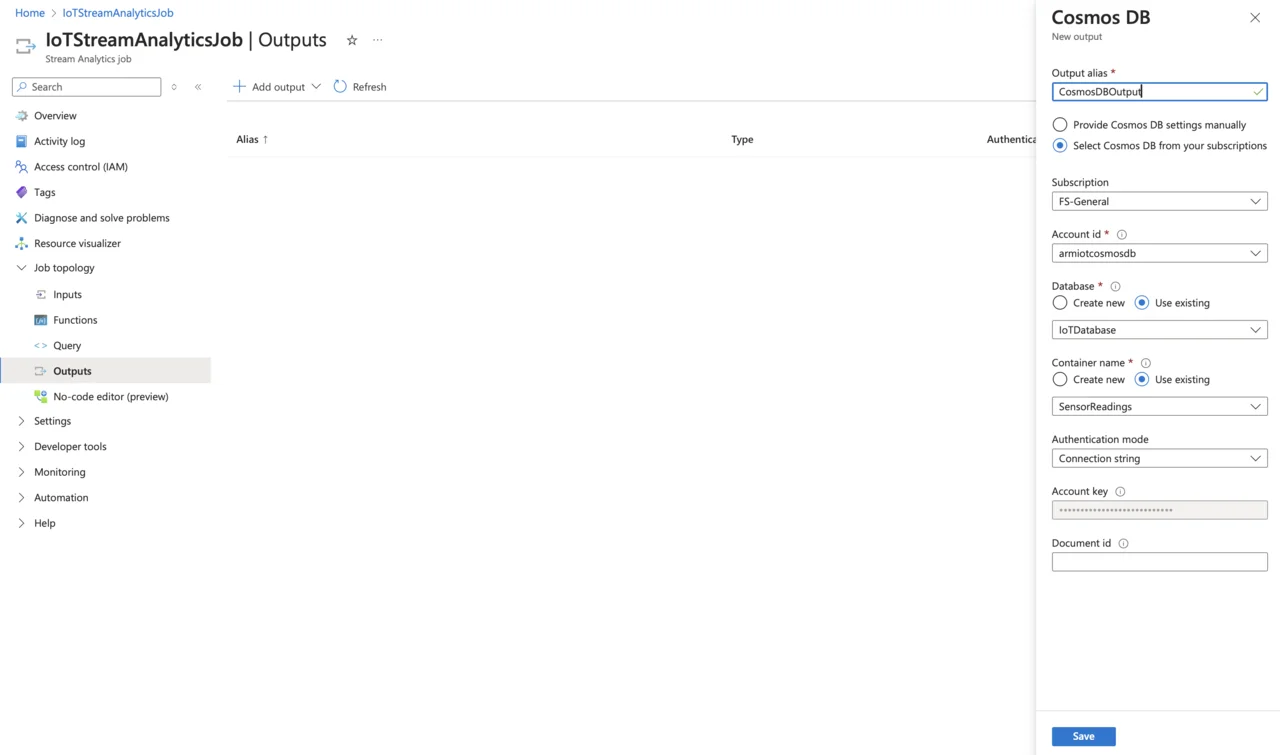

  3. Click Add output, and select Cosmos DB: Image Alt Text:img19 alt-text

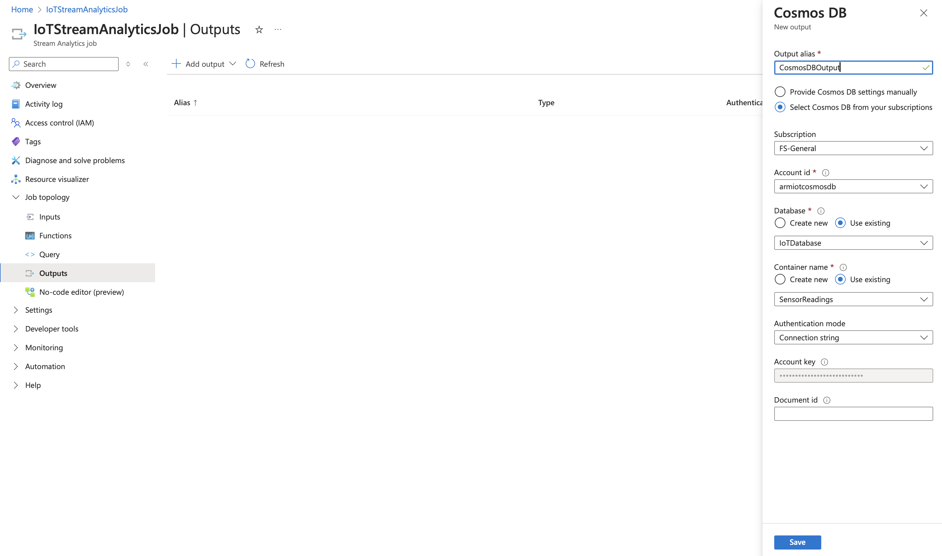

  4. In the Cosmos DB pane, type “CosmosDBOutput” for the alias name, leave other fields at their default values, and click the Save button: Image Alt Text:img20 alt-text

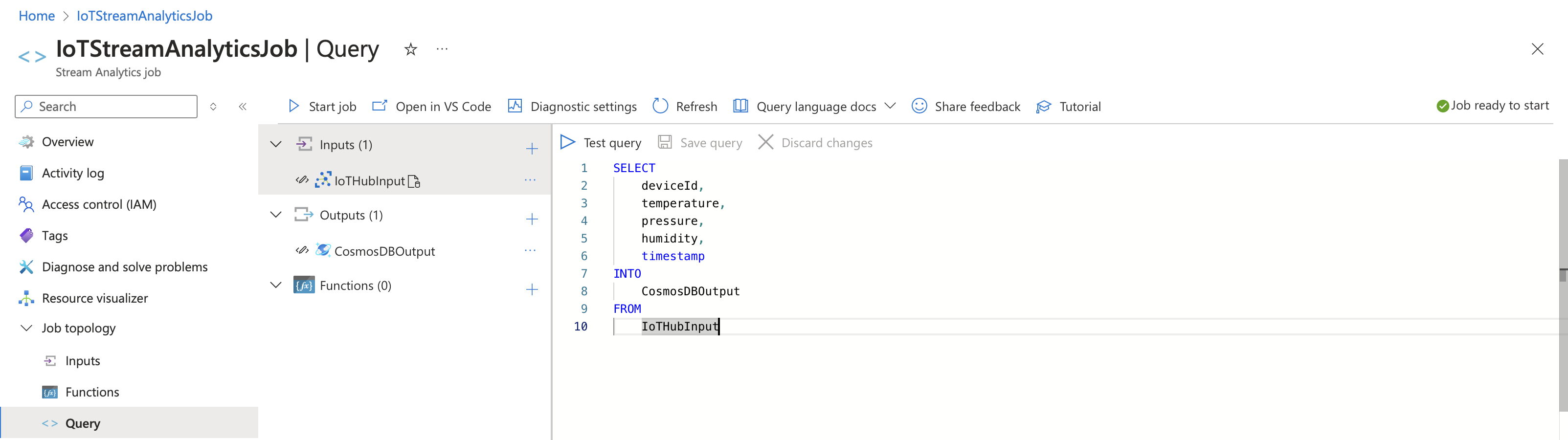

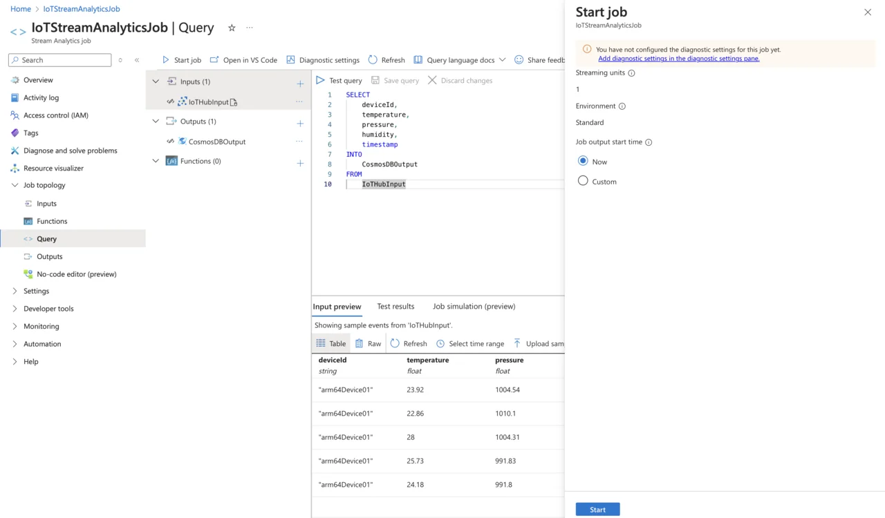

Now that you have the output configured, lets modify the query. To do so, select Query under Job topology. Then, modify your existing query to explicitly specify your Cosmos DB output alias:
SELECT
    deviceId,
    temperature,
    pressure,
    humidity,
    timestamp
INTO
    CosmosDBOutput
FROM
    IoTHubInput
Image Alt Text:img21 alt-text

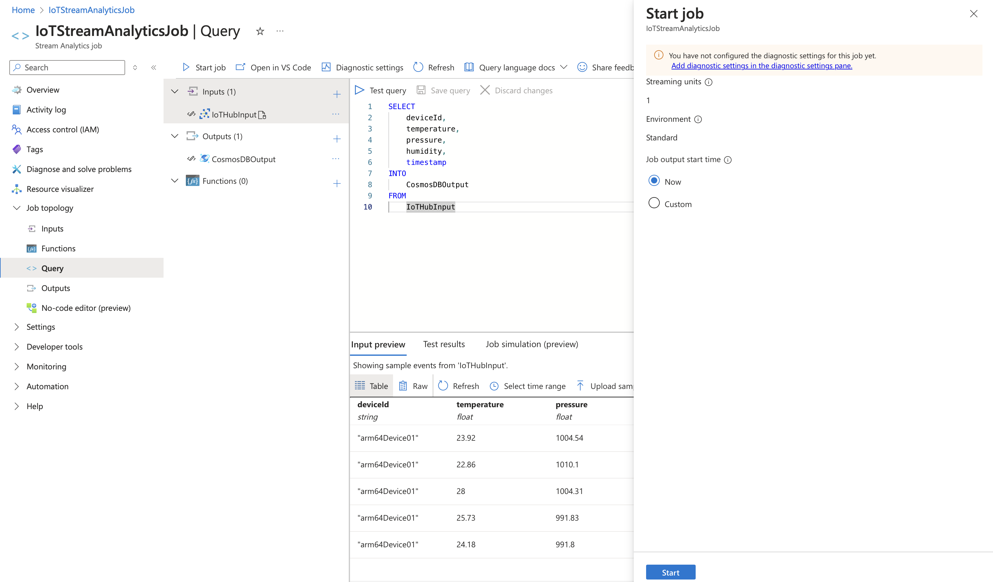

Afterwards, click Start job, and then Start:
Image Alt Text:img22 alt-text

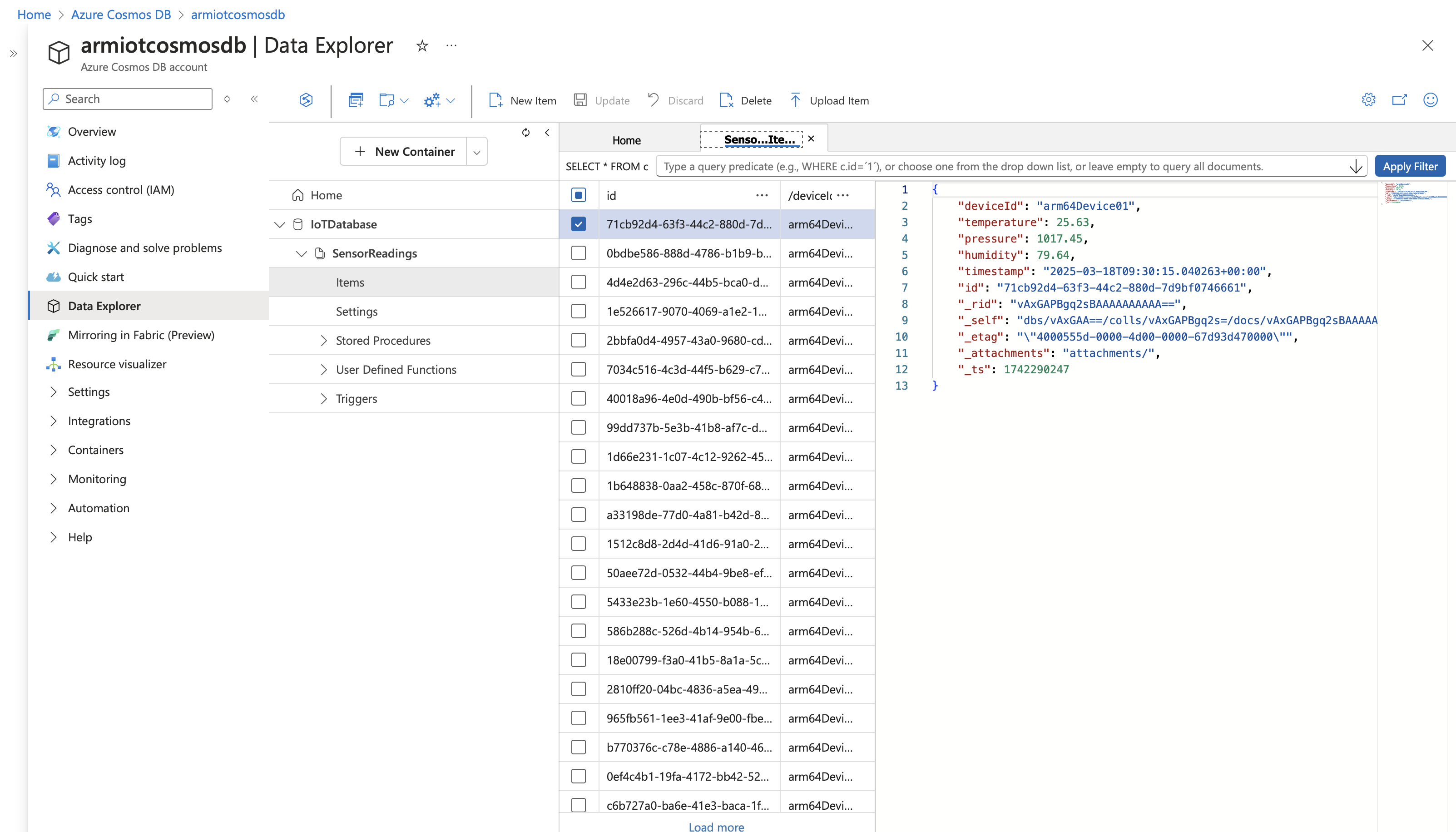

Verify data flow in Cosmos DB
To verify that your data pipeline is working correctly, first start your Python IoT simulator application iot_simulator.py. Ensure it’s actively sending telemetry data. Next, open the Azure Portal and navigate to your Azure Cosmos DB resource. Under Data Explorer, select your database and then your container (e.g., SensorReadings). Once selected, click Items to view your stored data. Sensor readings streamed from your IoT device will appear on the right-hand side of the Data Explorer interface, similar to the screenshot below:
Image Alt Text:img23 alt-text
Azure Cosmos DB stores data as JSON documents within a NoSQL (document-based) structure, making it ideal for flexible and dynamic data, such as IoT telemetry. Each record (also called a document) is stored in a container (or collection) that doesn’t enforce a rigid schema. As a result, each document can contain different fields without requiring schema changes or migrations, which is particularly valuable when collecting data from diverse IoT devices with evolving attributes.
Consider the sample item with the sensor reading:
    "deviceId": "arm64Device01",
    "temperature": 25.63,
    "pressure": 1017.45,
    "humidity": 79.64,
    "timestamp": "2025-03-18T09:30:15.040263+00:00",
    "id": "71cb92d4-63f3-44c2-880d-7d9bf0746661",
    "_rid": "vAxGAPBgq2sBAAAAAAAAAA==",
    "_self": "dbs/vAxGAA==/colls/vAxGAPBgq2s=/docs/vAxGAPBgq2sBAAAAAAAAAA==/",
    "_etag": "\"4000555d-0000-4d00-0000-67d93d470000\"",
    "_attachments": "attachments/",
    "_ts": 1742290247
Our defined fields (deviceId, temperature, pressure, humidity, and timestamp) contain the actual telemetry data from your IoT device. Then, Azure Cosmos DB automatically adds metadata fields to each stored document:
  • _rid - this is a resource identifier used internally by Cosmos DB.
  • _self - a unique URI representing the document within Cosmos DB.
  • _etag - a version tag used for optimistic concurrency control.
  • _self - a self-link, providing the path to access the document via Cosmos DB API.
  • _ts - timestamp automatically indicating when the document was last modified (if present).
  • each document has a unique id field, represented by your own ID or autogenerated by Cosmos DB, to identify documents uniquely within the container.
When storing data, Cosmos DB uses the provided partition key (such as deviceId) to evenly distribute documents across logical partitions. This optimizes retrieval speed and scalability, especially in IoT scenarios where queries often target specific devices. This approach helps ensure efficient data management and high performance, even as your data volume and throughput requirements increase.
