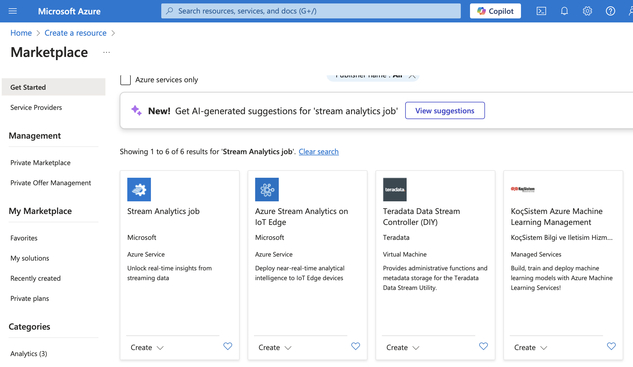

  1. Sign in to the Azure Portal.
  2. Click Create a resource, type “Stream Analytics job” into the search box, and press Enter.
  3. From the search results, select Stream Analytics job, then click Create: Image Alt Text:img9 alt-text

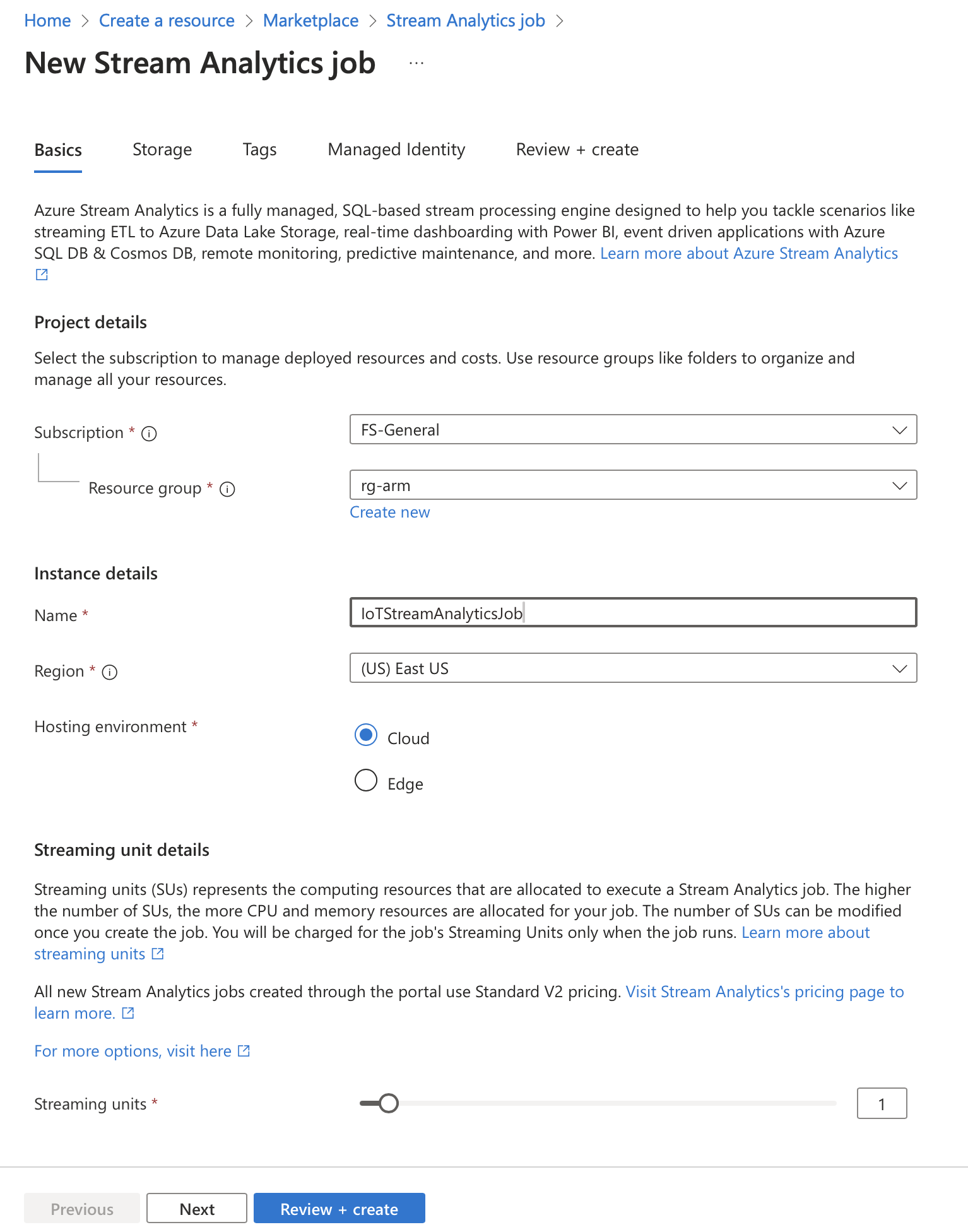

  4. Provide the necessary information:
  • Subscription: choose the Azure subscription you want to use for this job.
  • Resource group: select the resource group you previously created (e.g., your IoT project’s resource group).
  • Name: provide a meaningful, unique name for your Stream Analytics job (e.g., IoTStreamAnalyticsJob).
  • Region: choose the same Azure region as your IoT Hub for optimal performance and minimal latency.
  • Hosting environment: select Cloud for Azure-managed infrastructure.
  • Streaming units: set this to 1 (appropriate for initial testing and smaller workloads, you can scale up later).
Image Alt Text:img10 alt-text
  1. After reviewing your settings carefully, click Review + create, confirm that all details are correct, and then click Create to deploy your Azure Stream Analytics job.
Your Stream Analytics job will deploy within a few minutes. Once the deployment is complete, you’ll be ready to configure inputs, define queries, and set outputs for real-time data processing and analytics.

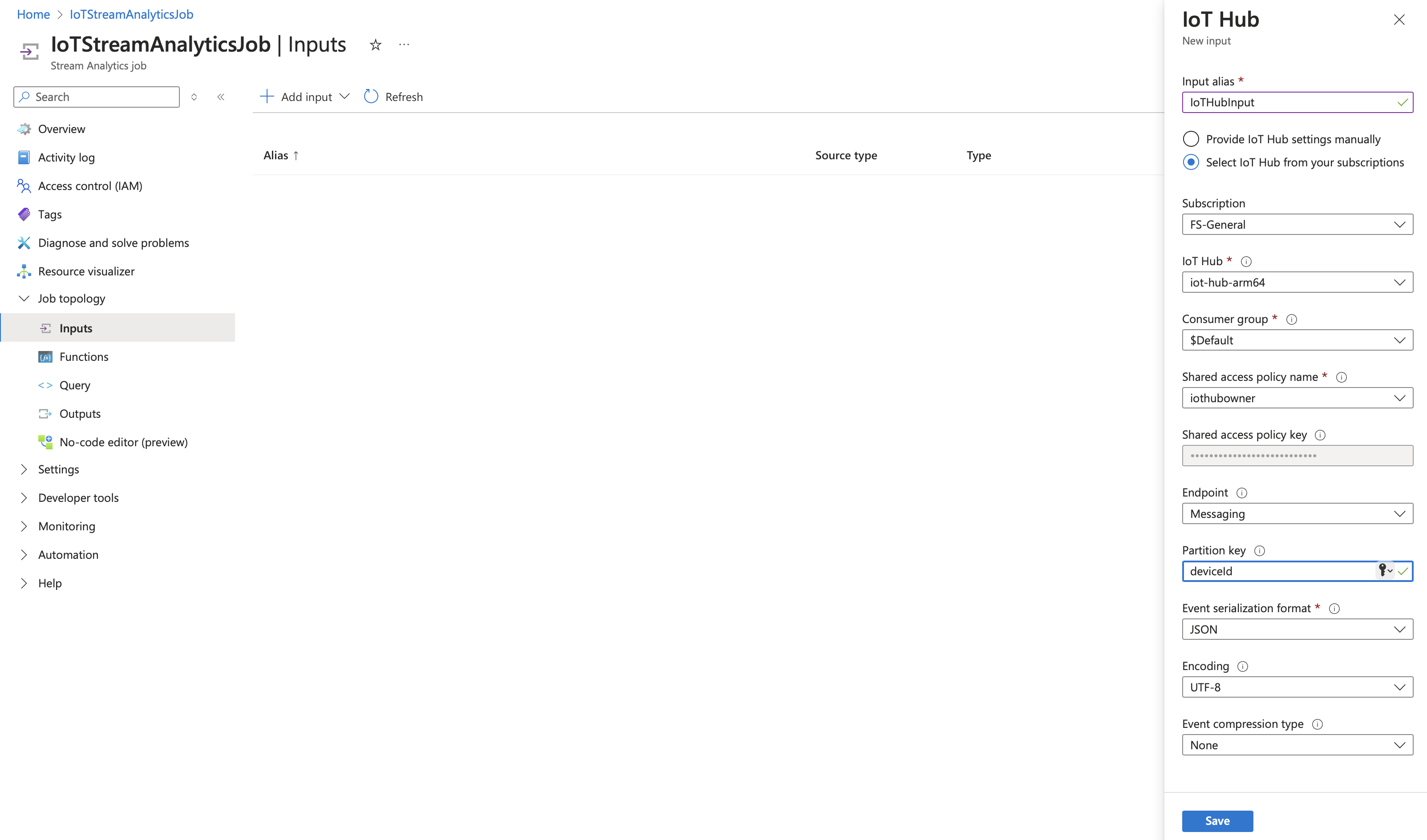

Configure Azure IoT Hub as an Input for Stream Analytics Job
After successfully creating the Stream Analytics job, you will need to configure your Azure IoT Hub as an input source. This configuration allows Stream Analytics to read real-time telemetry data directly from your IoT devices. Follow these steps:
  1. Navigate to your newly created Stream Analytics job in the Azure Portal.
  2. On the left-hand menu, under the Job topology section, select Inputs.
  3. Click Add input, and choose IoT Hub as the input type. Image Alt Text:img11 alt-text
  4. Enter the following configuration details:
  • Input Alias: provide a name, such as IoTHubInput.
  • IoT Hub: select the Azure IoT Hub you created earlier.
  • Consumer group: choose $Default, unless you have explicitly created a custom consumer group.
  • Shared access policy name: select iothubowner (which provides full access for reading data from IoT Hub).
  • Endpoint: select Messaging.
  • Partition key: Type deviceId (this helps ensure the data streams are partitioned by device identifiers).
  • Event serialization format: select JSON, as our telemetry data is transmitted in JSON format.
  • Encoding: Choose UTF-8.
  • Event compression type: Set this to None.
Image Alt Text:img12 alt-text
  1. After entering these details, carefully verify them for accuracy and completeness. Click Save to apply the changes and successfully link your Azure IoT Hub as the input source for your Stream Analytics job.
Your job is now configured to ingest streaming IoT telemetry data in real-time, preparing it for further analysis, storage, and visualization.

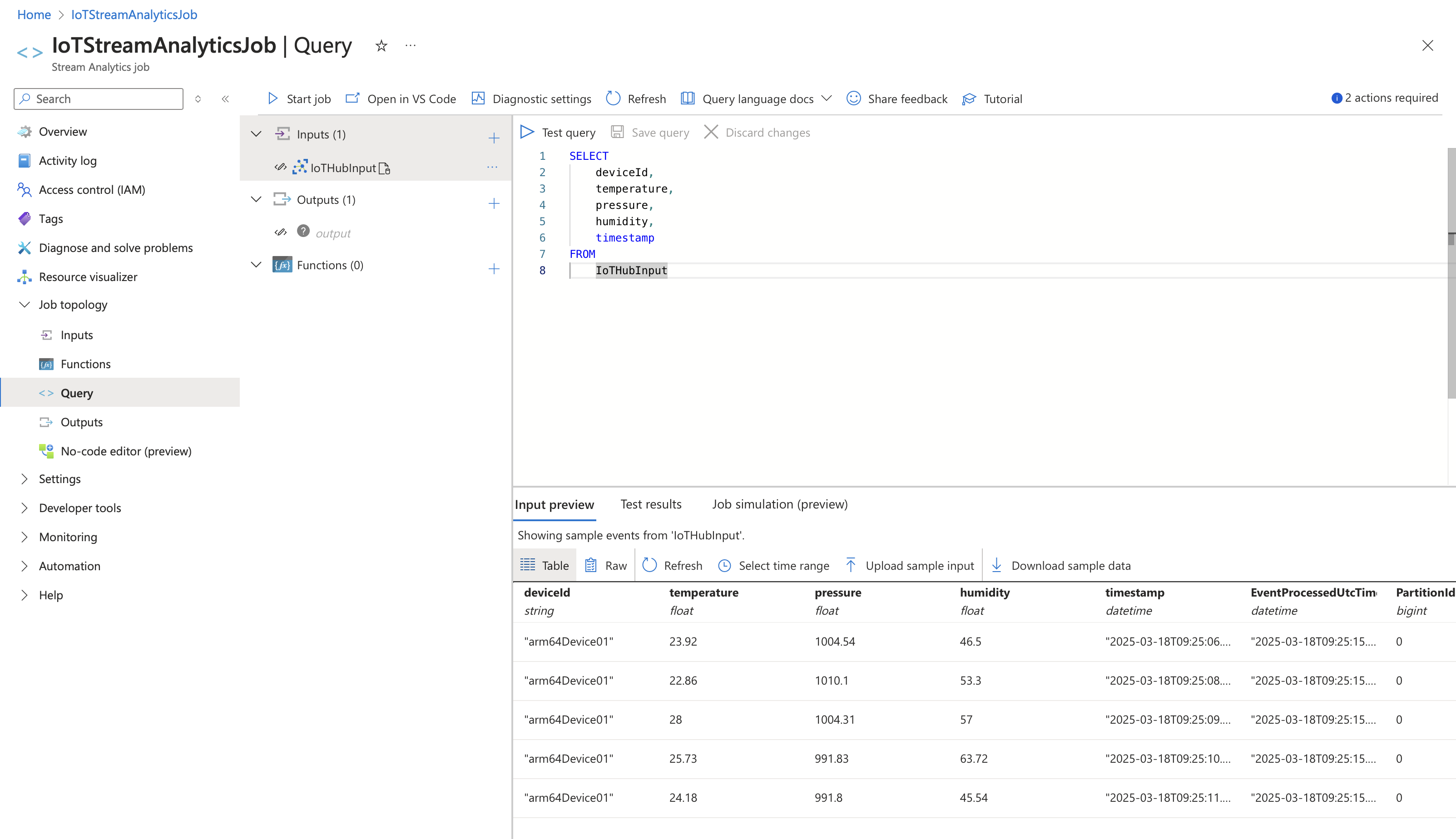

Define the Stream Analytics Query
Now that you have configured your Azure IoT Hub as an input source, the next step is to create and run a Stream Analytics query. This query defines how incoming IoT data will be filtered, transformed, or routed for further processing. Follow these steps:
  1. Navigate to your Stream Analytics job in the Azure Portal.
  2. Under the Job topology menu on the left, select Query.
  3. In the query editor, enter the following simple SQL-like query to stream all incoming data from your IoT device
SELECT
    deviceId,
    temperature,
    pressure,
    humidity,
    timestamp
FROM
    IoTHubInput
This straightforward query selects all relevant fields (deviceId, temperature, pressure, humidity, and timestamp) directly from your configured input (IoTHubInput), which corresponds to the Azure IoT Hub you previously connected.
Before running this query, ensure your Python IoT simulator iot_simulator.py is actively sending telemetry data. After the simulator begins transmitting data, you can test and verify your Stream Analytics query within the Azure Portal using the built-in Test query feature. Doing this allows you to view live-streamed sensor data in real-time and confirm that your streaming pipeline is working as expected:
Image Alt Text:img13 alt-text
Constructing queries in Azure Stream Analytics involves using a straightforward SQL-like syntax specifically optimized for real-time stream processing. Typically, a query contains a SELECT statement to specify which fields from the incoming telemetry data to process, and a FROM statement to indicate the source stream. Queries can be expanded with advanced features such as filtering, aggregations, and temporal window functions to handle more complex scenarios.
In the current example, you implemented a simple query using SELECT and FROM clauses to view and forward all incoming sensor data from our IoT device without any additional filtering or transformation. This straightforward query effectively demonstrates how Azure Stream Analytics ingests and processes real-time IoT data, establishing a foundation upon which you can build more advanced and powerful data analytics workflows in the future.
