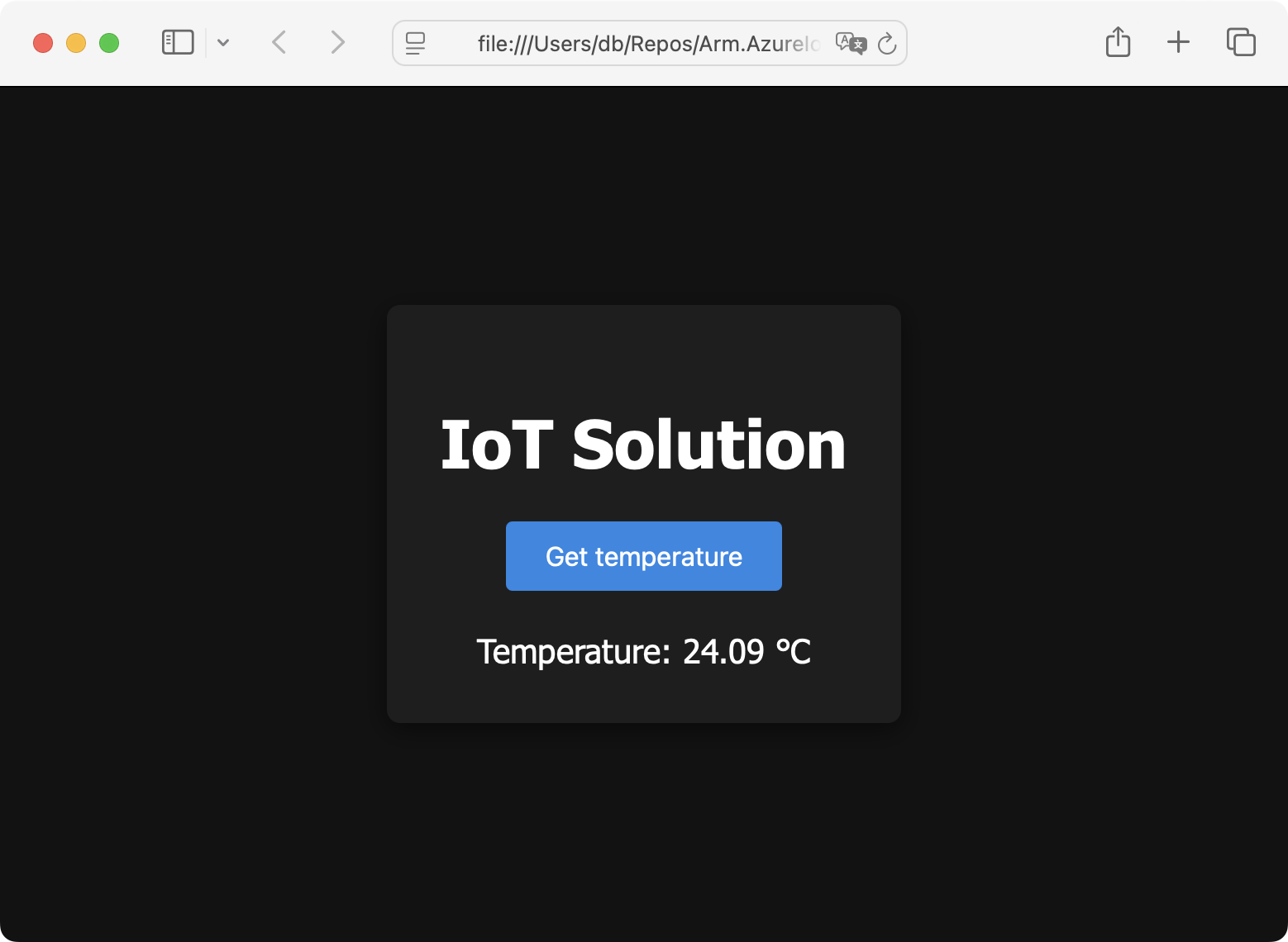

Testing the Implementation:
Make sure you have saved all three files (index.html, main.js, and styles.css). Next:
  1. Start the IoT Simulator to begin streaming data to the Azure IoT Hub.
  2. Open the index.html file locally in your web browser.
  3. Click the Get temperature button.
You should now see real-time temperature readings displayed:

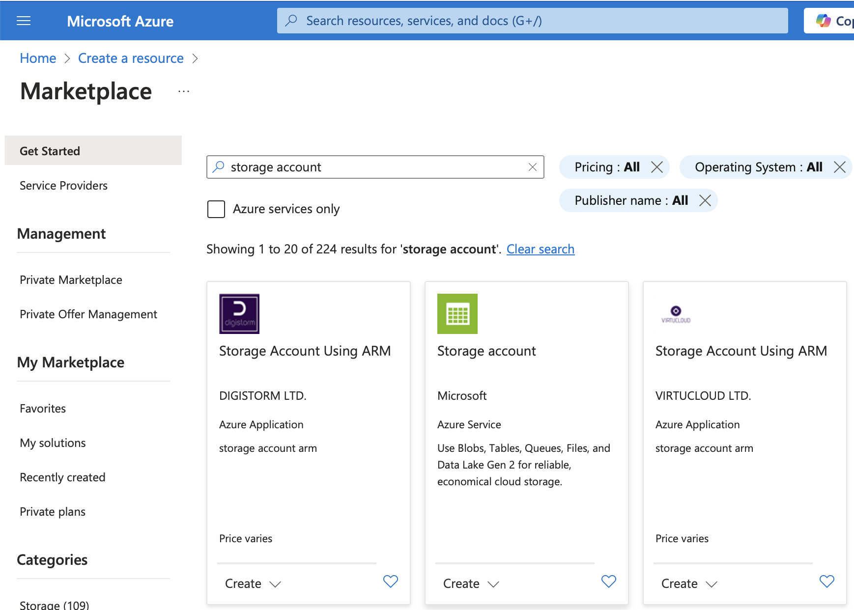

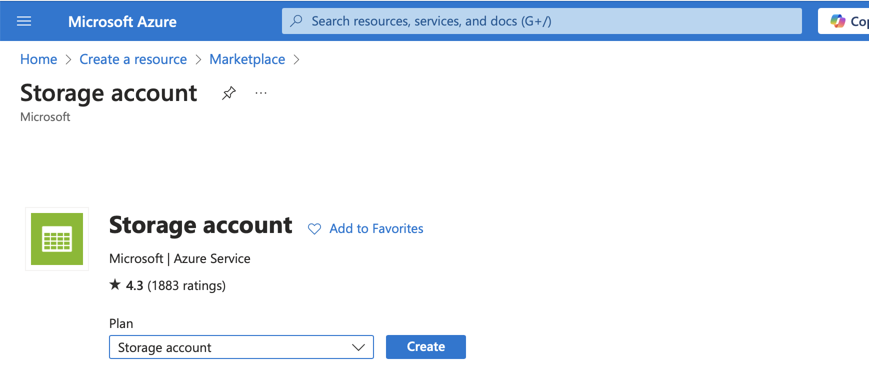

  2. Create a Storage Account:
  • Click Create a resource.
  • Search for “Storage account”. Image Alt Text:img45 alt-text
  • Click Create. Image Alt Text:img46 alt-text

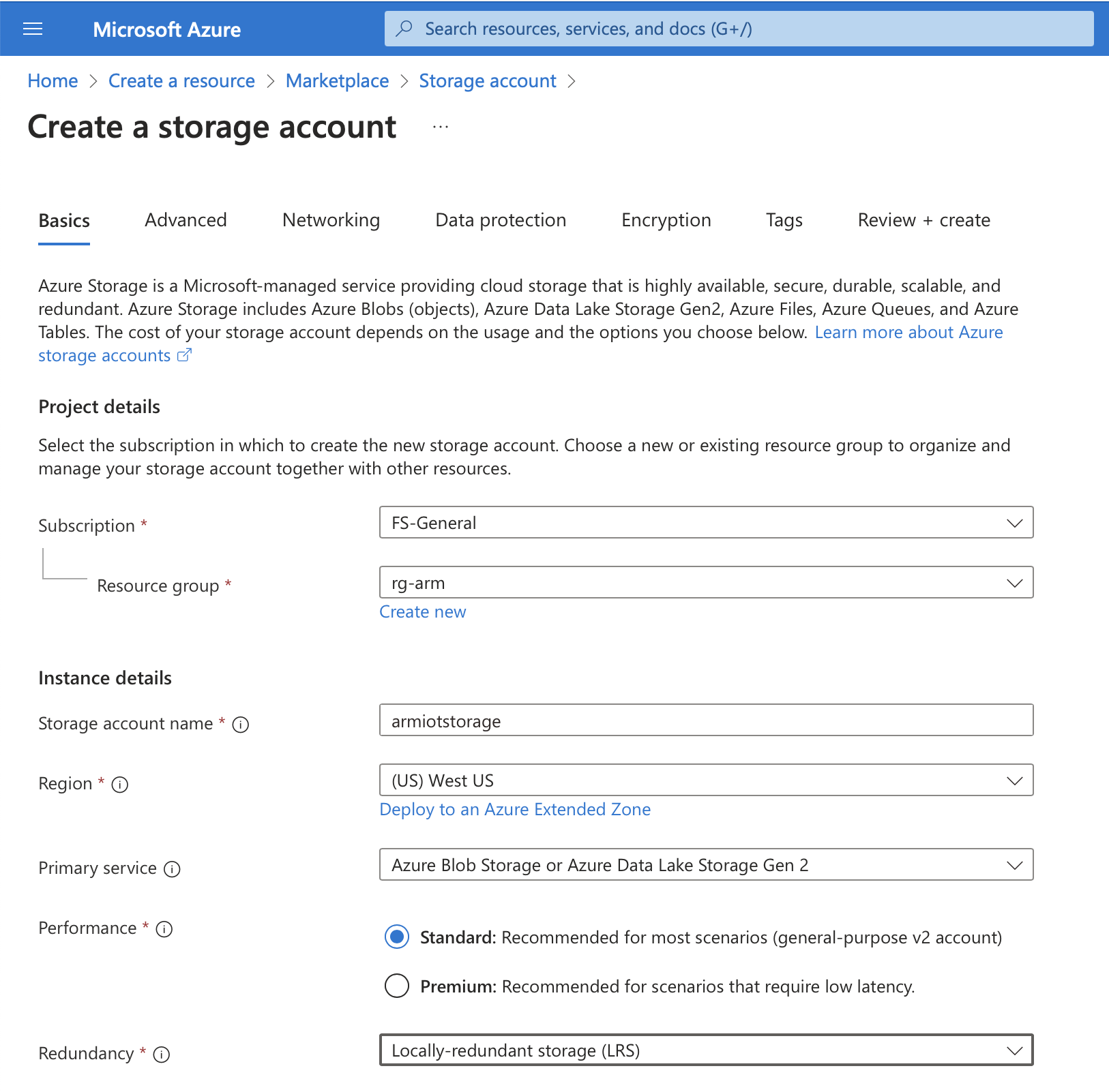

  1. Provide the required details:
  • Subscription, resource group, and storage account name (e.g. armiotstorage).
  • For Primary service, choose Azure Blob Storage or Azure Data Lake Storage Gen 2.
  • Select Standard performance and Locally-redundant storage (LRS). Image Alt Text:img47 alt-text
  • Click “Review + create”, then “Create”.

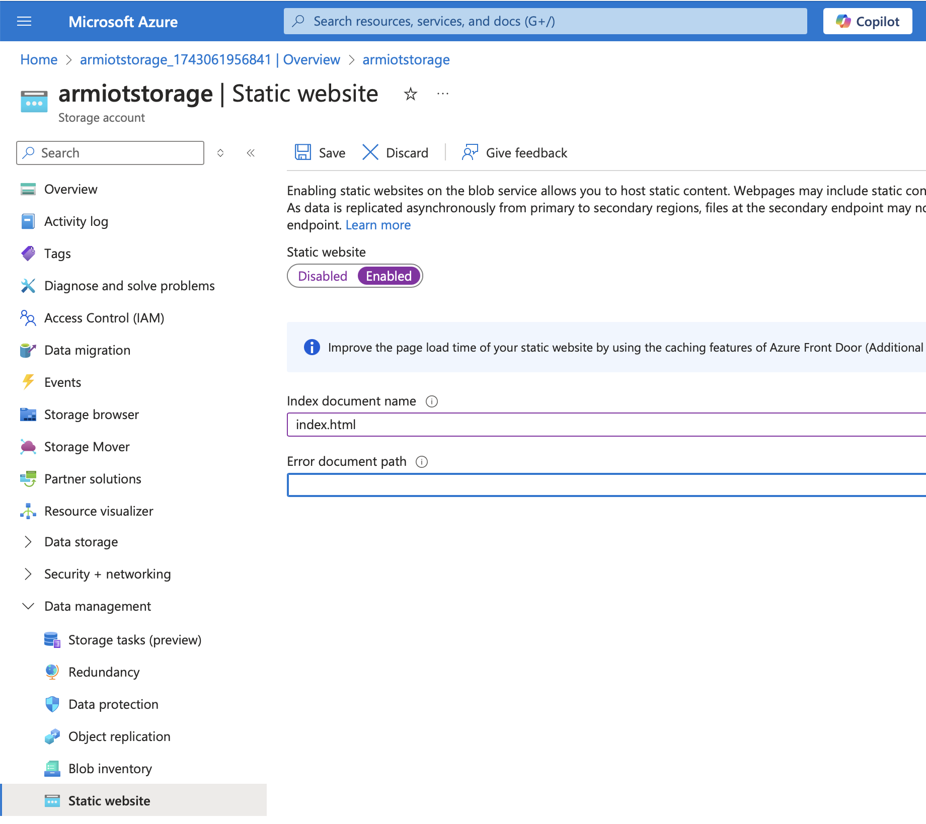

  1. Enable Static Website Hosting:
  • Navigate to your newly created storage account.
  • Under Data management, click Static website.
  • Select Enabled.
  • Set index.html as the index document name. Image Alt Text:img48 alt-text
  • Click Save.
After saving, Azure provides you with a URL like: https://.z22.web.core.windows.net/. Save this URL, as it will serve as the public endpoint for your website.

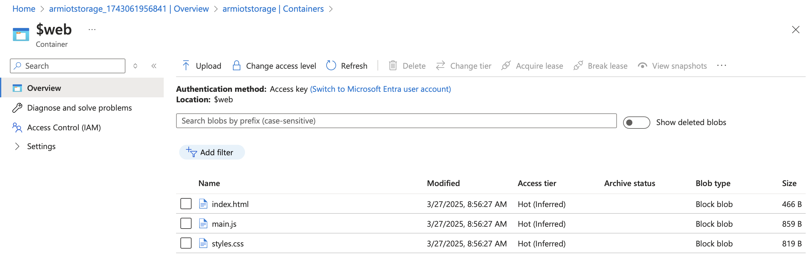

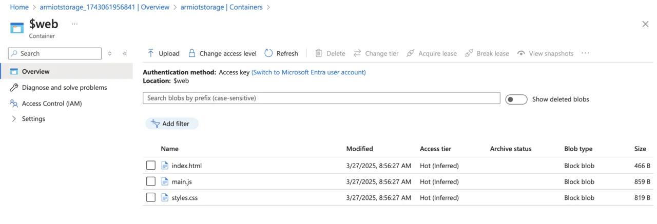

You can upload your website files directly using the Azure Portal or via Azure Storage Explorer. Here, use the Azure Portal:
  1. Navigate to your storage account.
  2. Under Data storage, select Containers.
  3. Open the container named ”$web” (created automatically when enabling static websites).
  4. Click Upload and select your three website files (index.html, main.js, styles.css), and upload them.
Image Alt Text:img49 alt-text

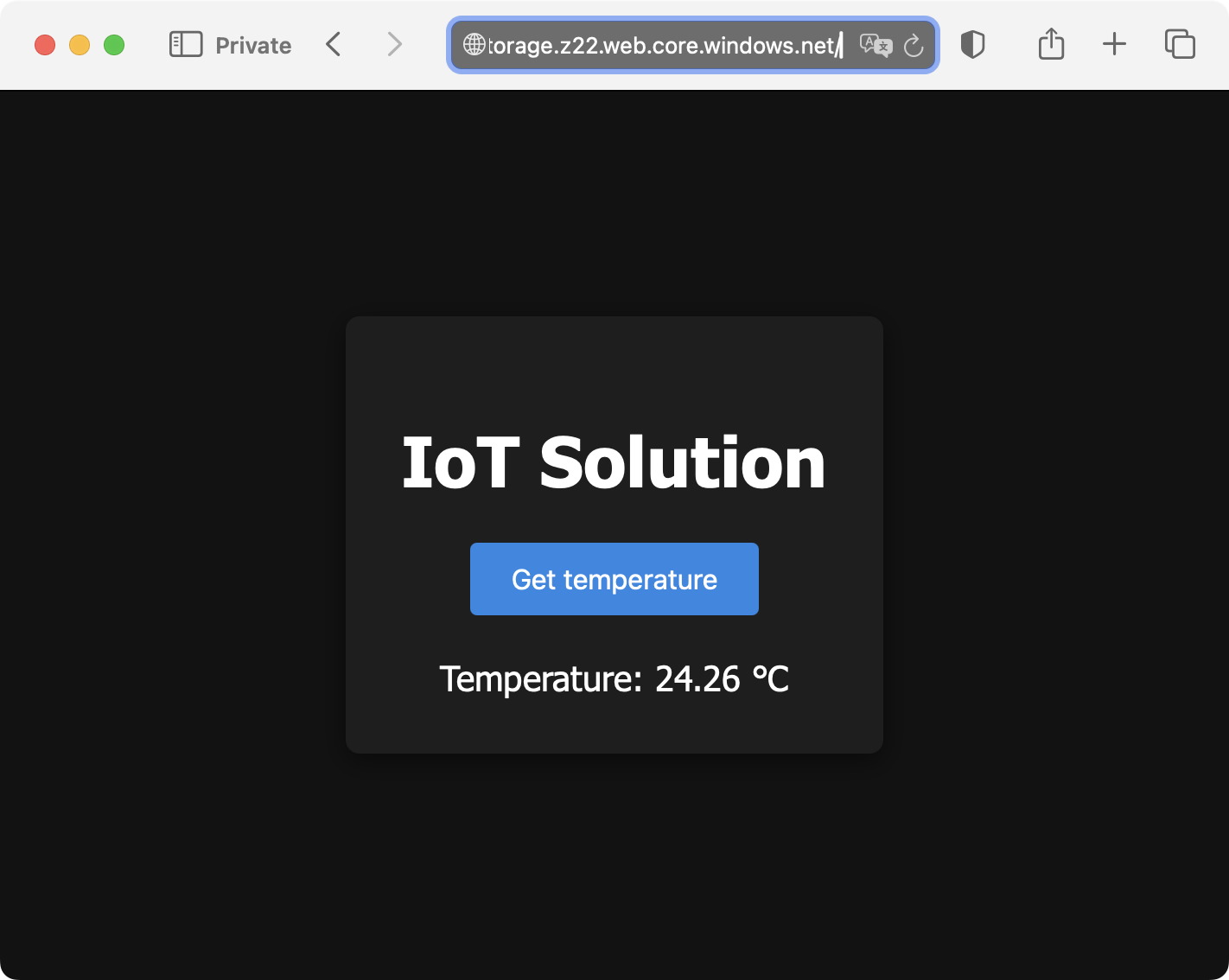

Verify the Deployment
After uploading your files, open a browser and navigate to https://.z22.web.core.windows.net/.
Your static website should load, allowing you to test the Get temperature button (to see temperatures make sure to start the IoT simulator):
Image Alt Text:img50 alt-text
