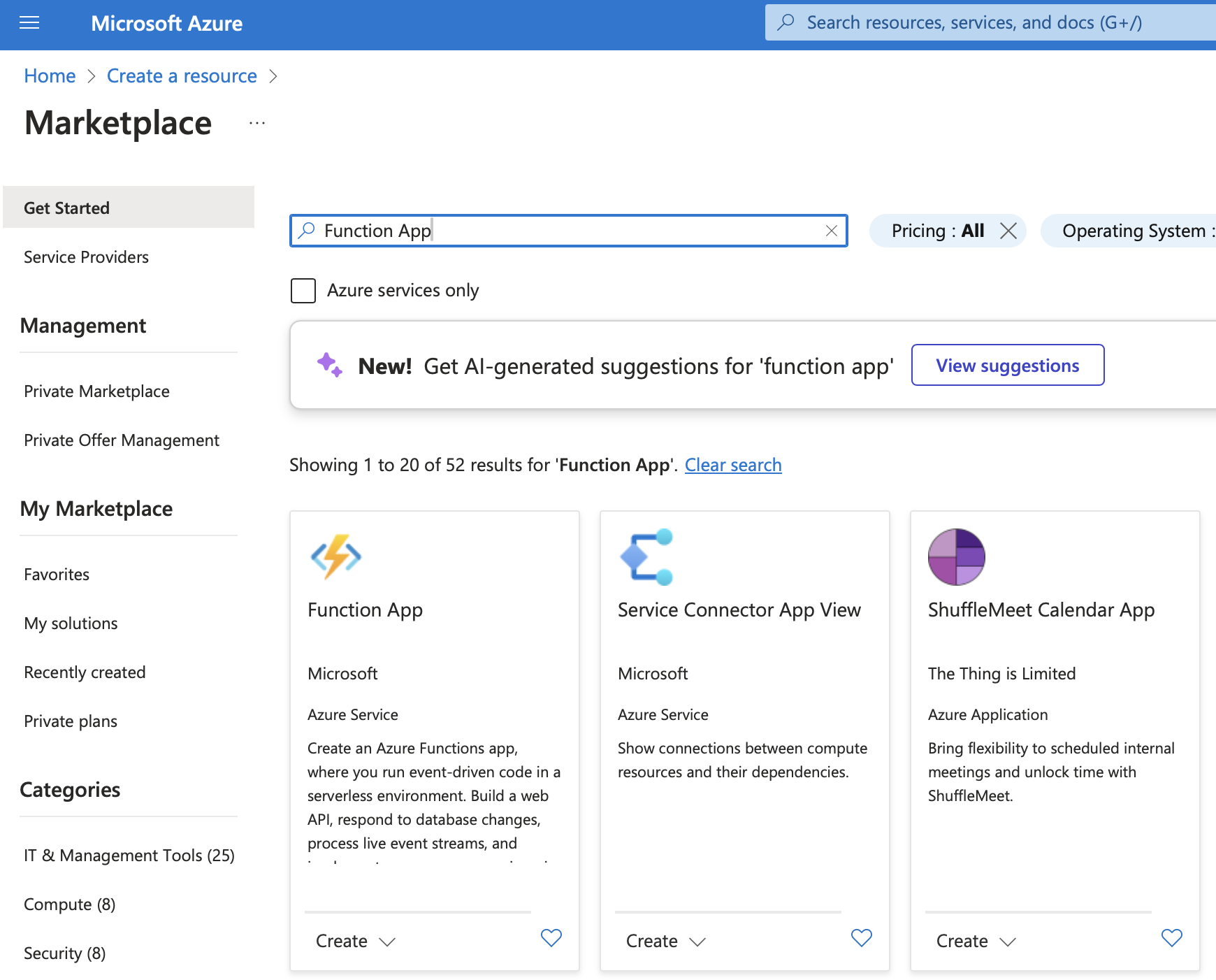

  2. Click Create a resource, type “Function App”, and select it: Image Alt Text:img24 alt-text

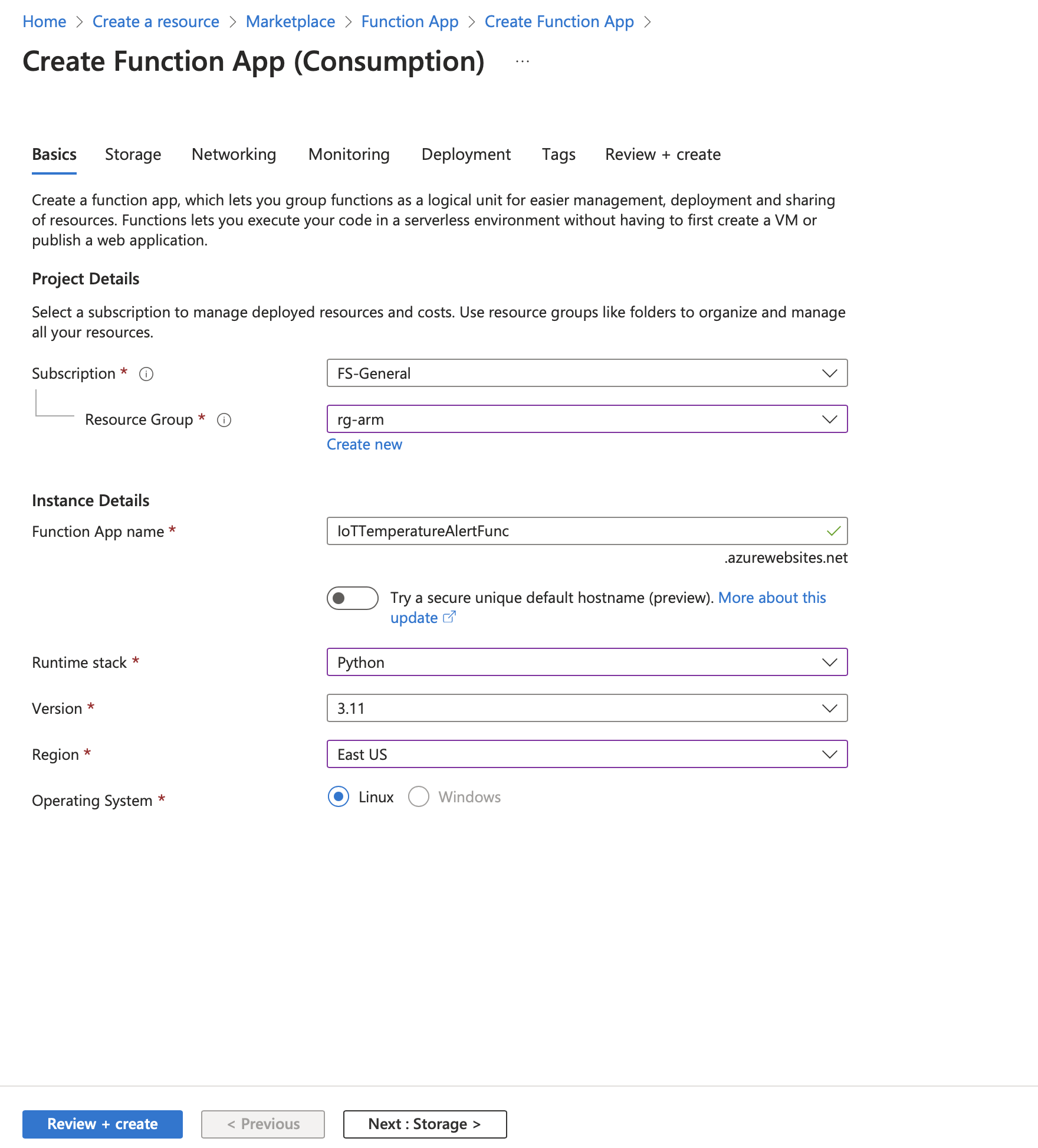

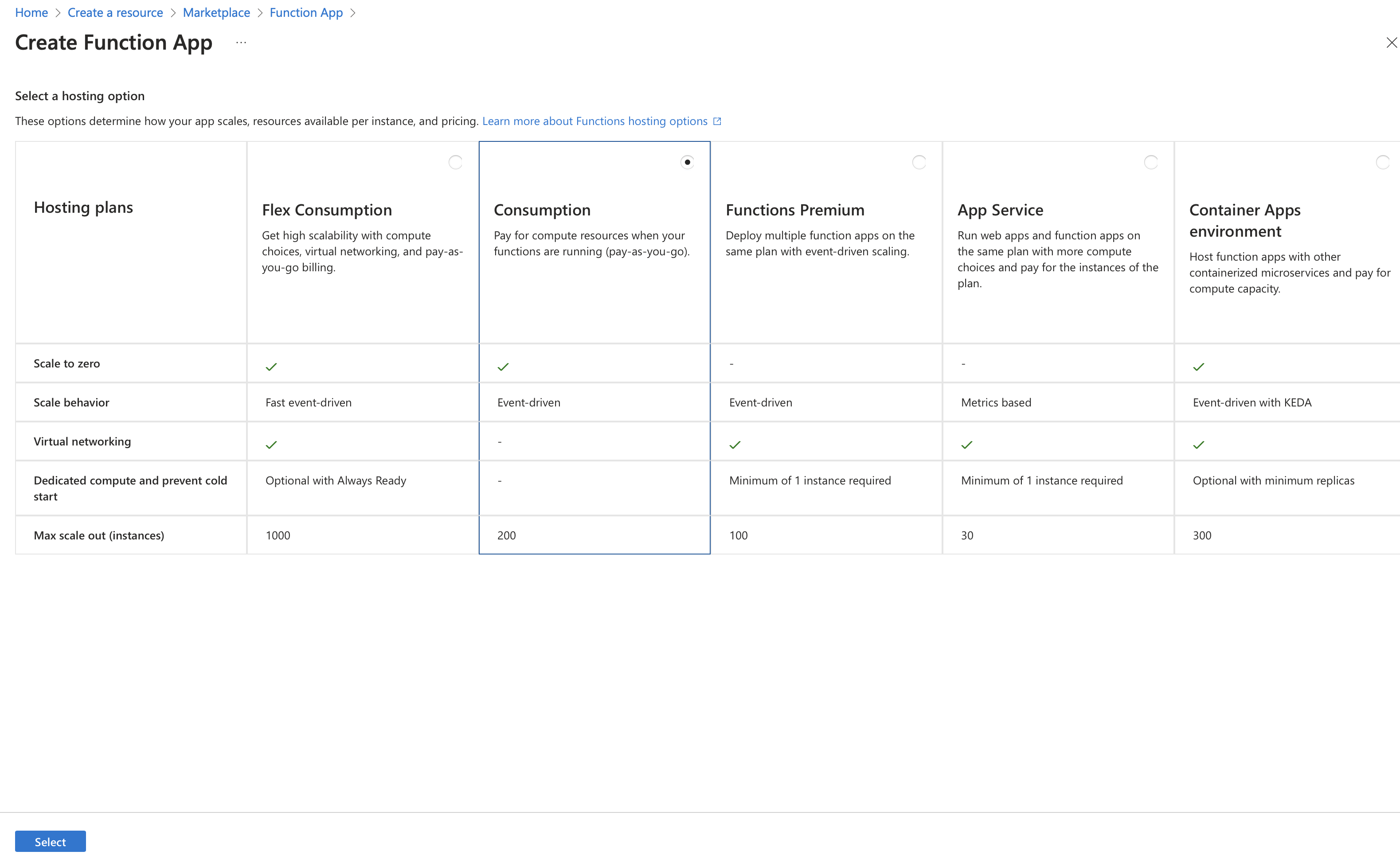

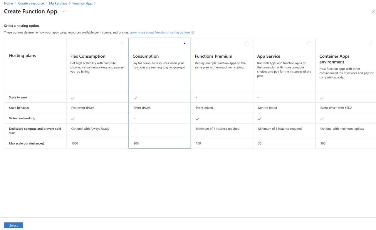

  3. Click Create, then select Consumption as a hosting option: Image Alt Text:img25 alt-text
  4. Provide the required details:
  • Subscription: Your Azure subscription.
  • Resource Group: Select your existing IoT resource group.
  • Function App Name: Provide a unique name (e.g., IoTTemperatureAlertFunc).
  • Runtime Stack: Select Python.
  • Version: Select 3.11
  • Region: Select the same region as your Cosmos DB and IoT Hub.
  • Operating System: Select Linux as Windows is unavailable for Python.
  1. Click Review + Create, and then Create.
Image Alt Text:img26 alt-text

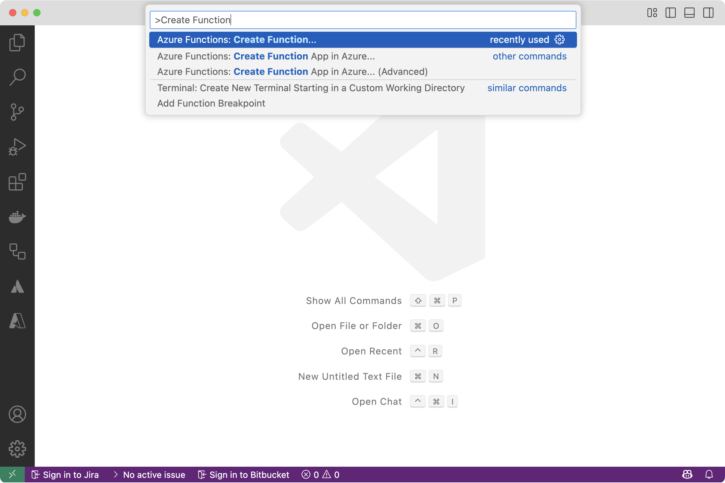

  1. In Visual Studio Code, click View->Command Palette…
  2. Type “Create Function”: Image Alt Text:img27 alt-text
  3. Select Azure Functions: Create Function…

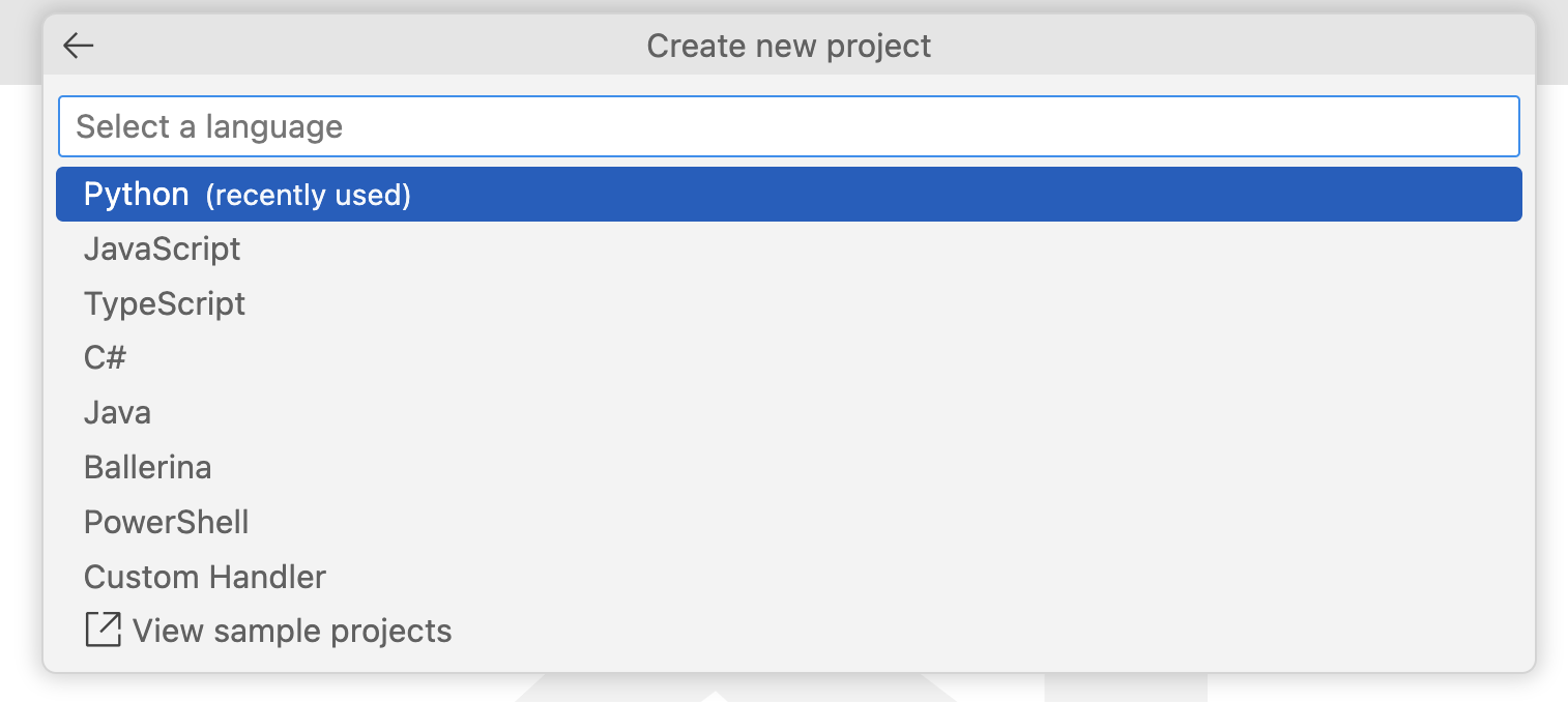

  6. Use this wizard to configure the function:
  • Select a language: Select Python

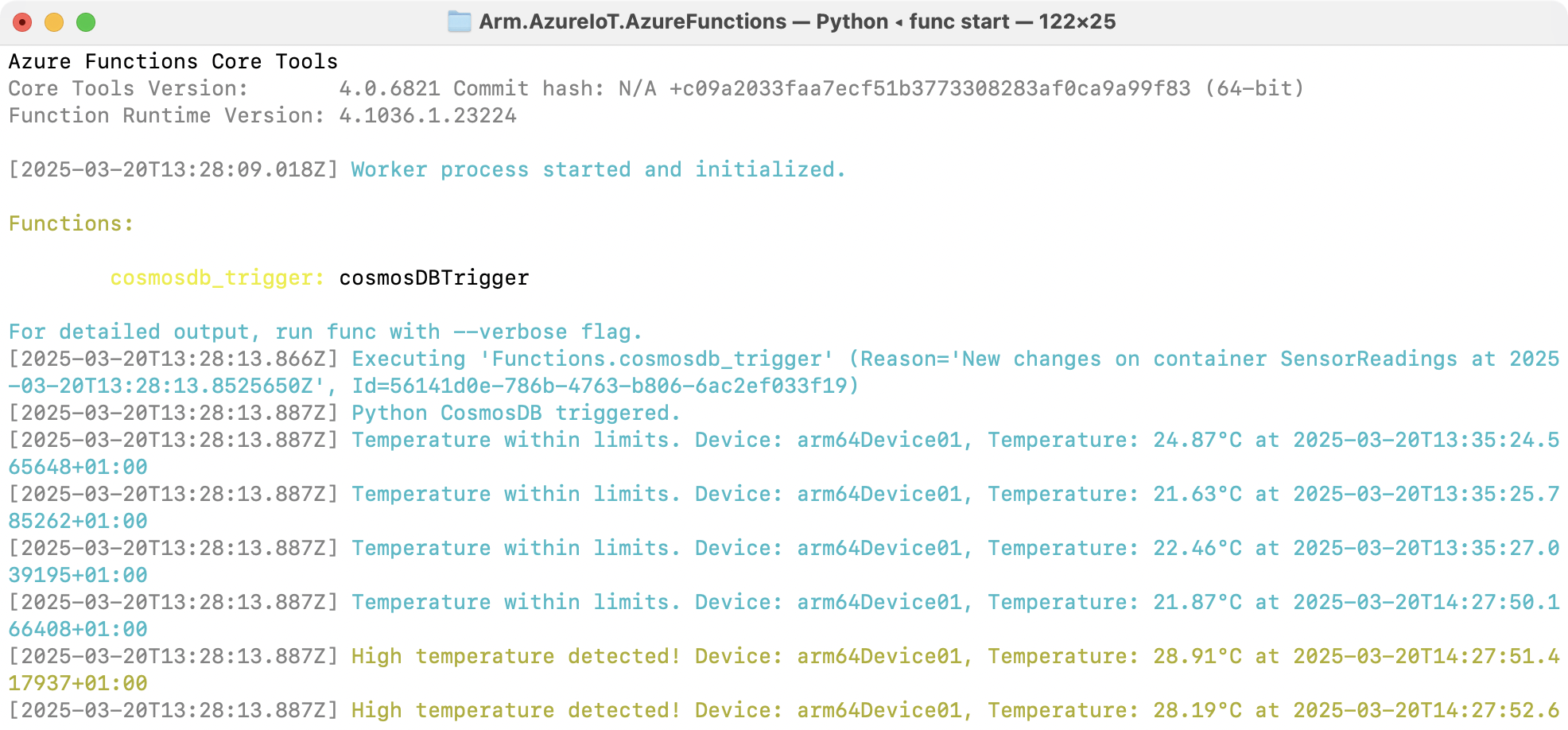

Run and Test Your Function Locally
To run your function locally proceed as follows:
  1. In the Terminal navigate to the folder, in which you saved the function (here that is Arm.AzureIoT.AzureFunctions).
  2. Type the following command:
func start
  1. Run the iot_simulator.py in a separate terminal window.
You should then see the following logs, depending on the generated temperature values:
Image Alt Text:img29 alt-text

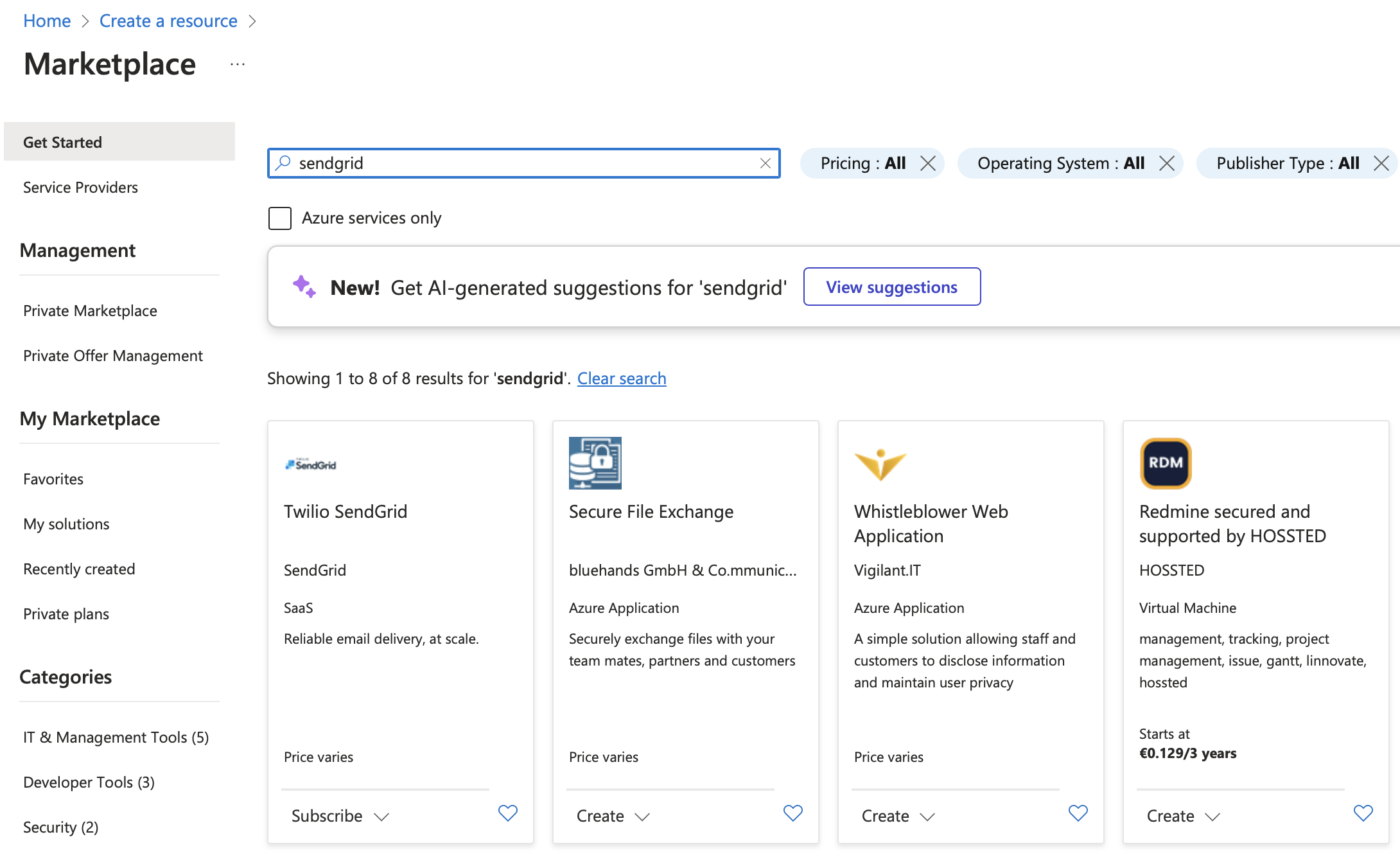

  2. Click “Create a resource” and search for SendGrid. Image Alt Text:img30 alt-text

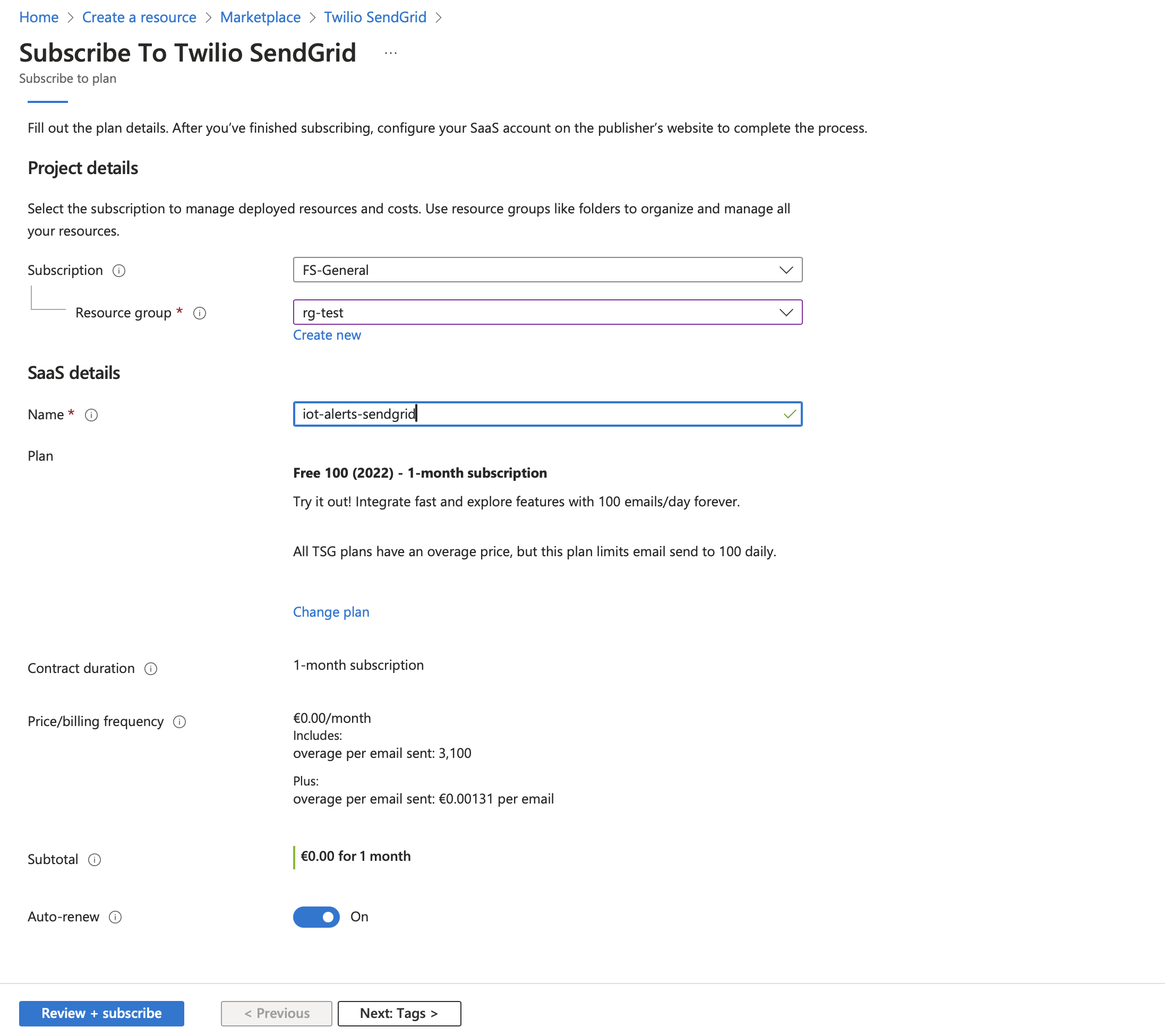

  3. Select Twilio SendGrid, choose the Free 100 (2022) plan, and then click Subscribe.
  4. Provide the following details:
  • Subscription: Select your Azure subscription.
  • Resource group: Choose your existing IoT project resource group.
  • Name: Enter a descriptive name (e.g., iot-alerts-sendgrid). Image Alt Text:img31 alt-text
  1. Click Review + subscribe and then Subscribe.

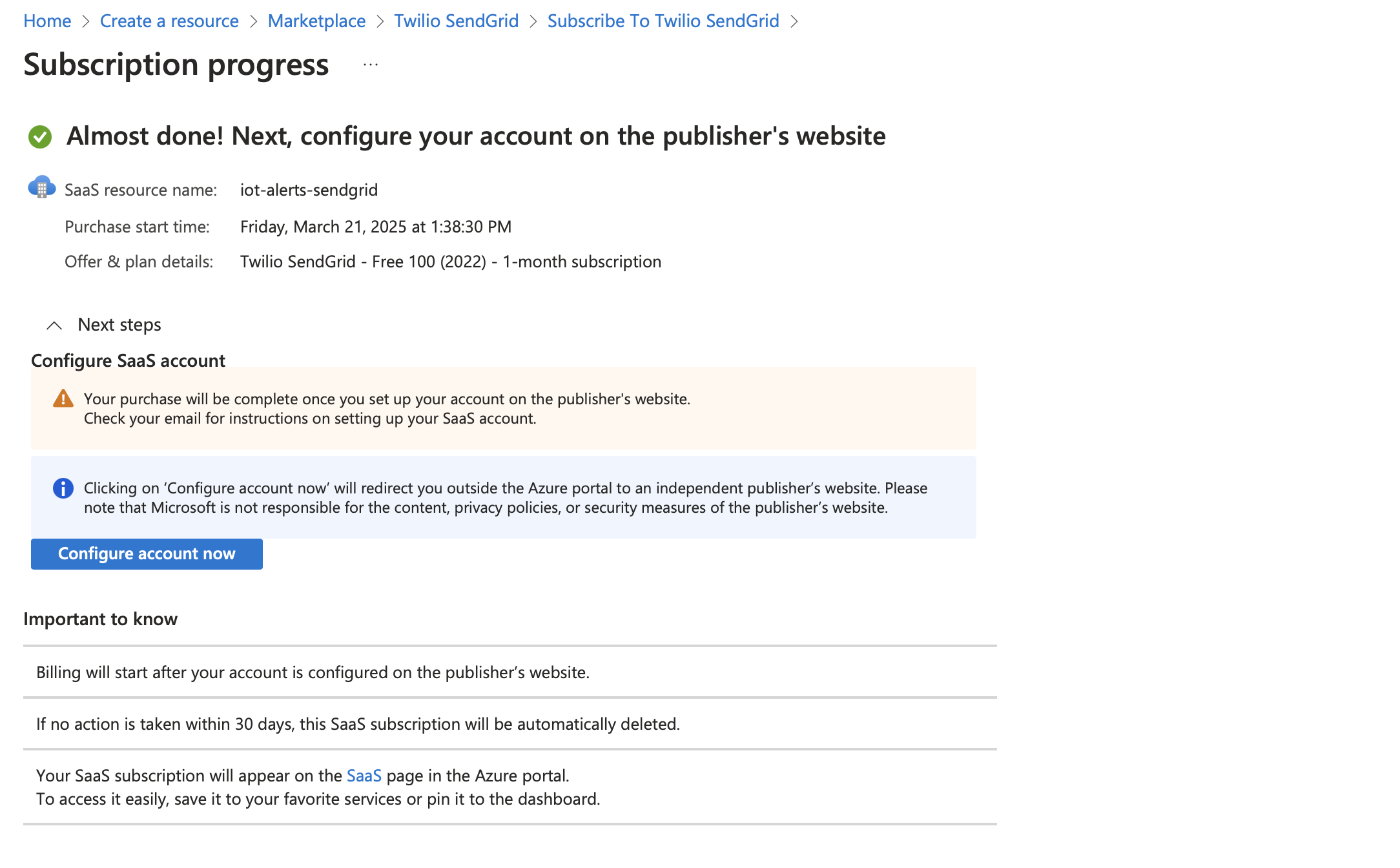

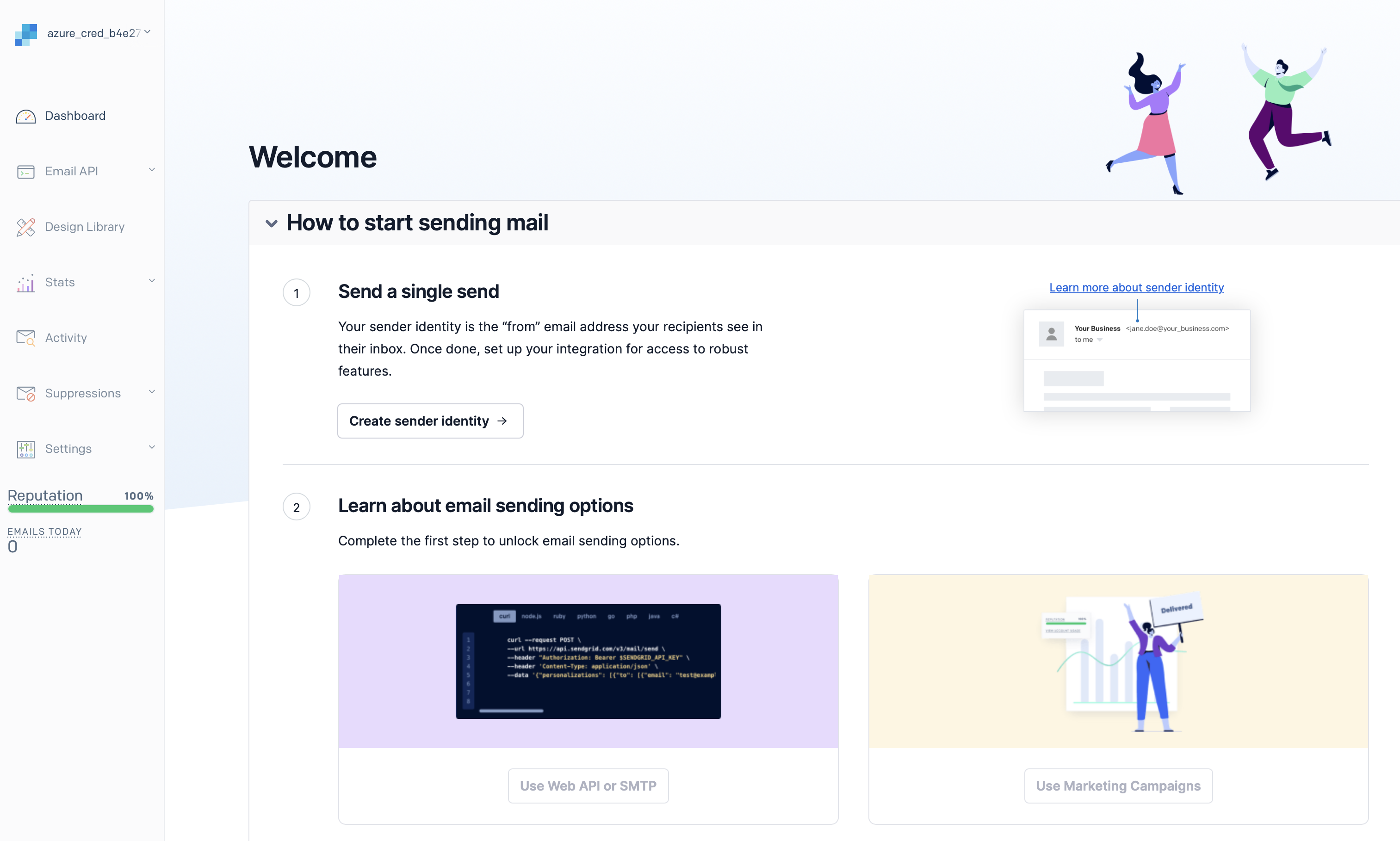

  2. On the next screen, click Configure account now: Image Alt Text:img32 alt-text
  3. Accept any permissions required by SendGrid, and then enter your details to create a sender identity: Image Alt Text:img33 alt-text
  4. Fill out the required details, such as your name and email address.

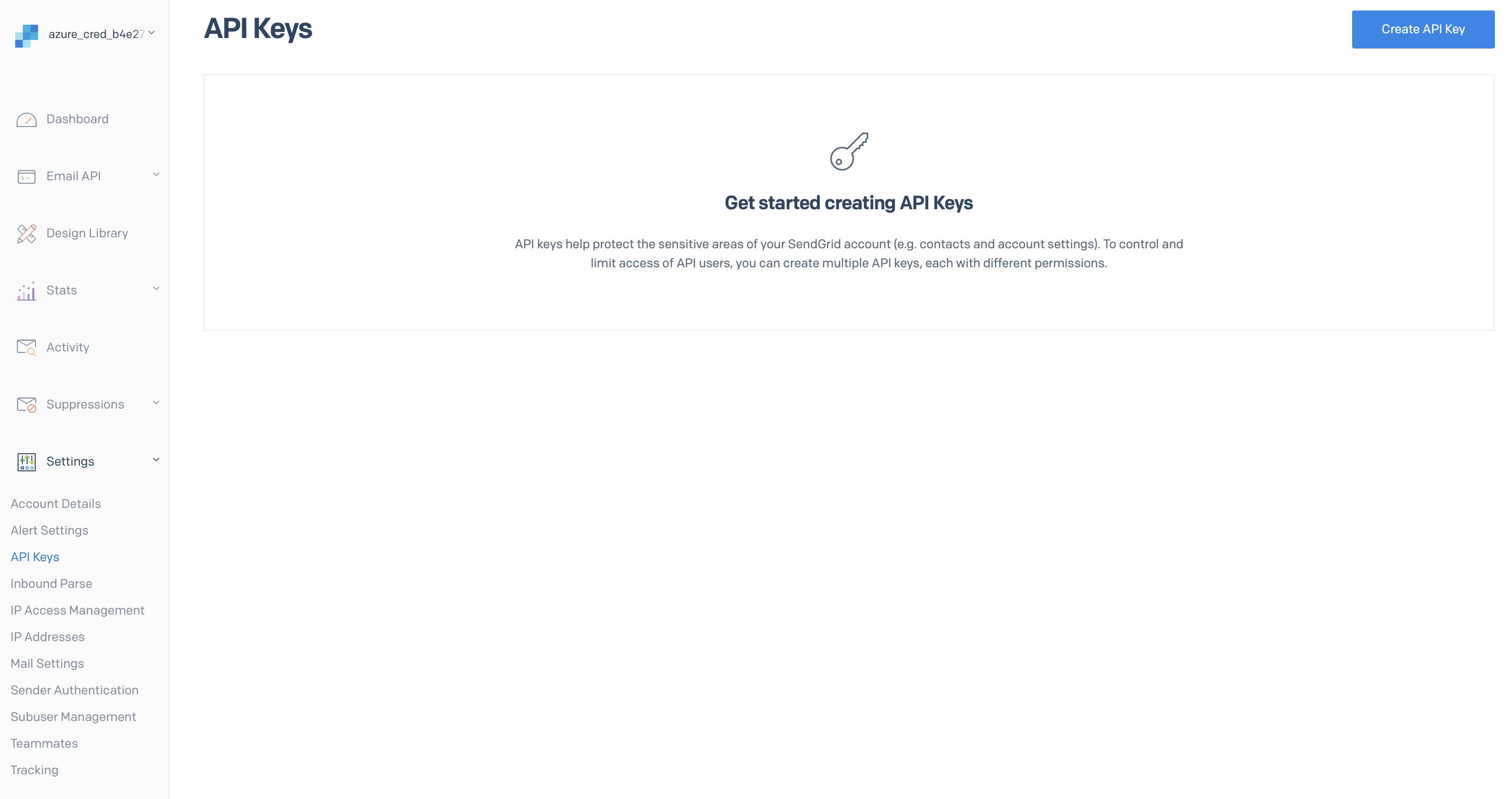

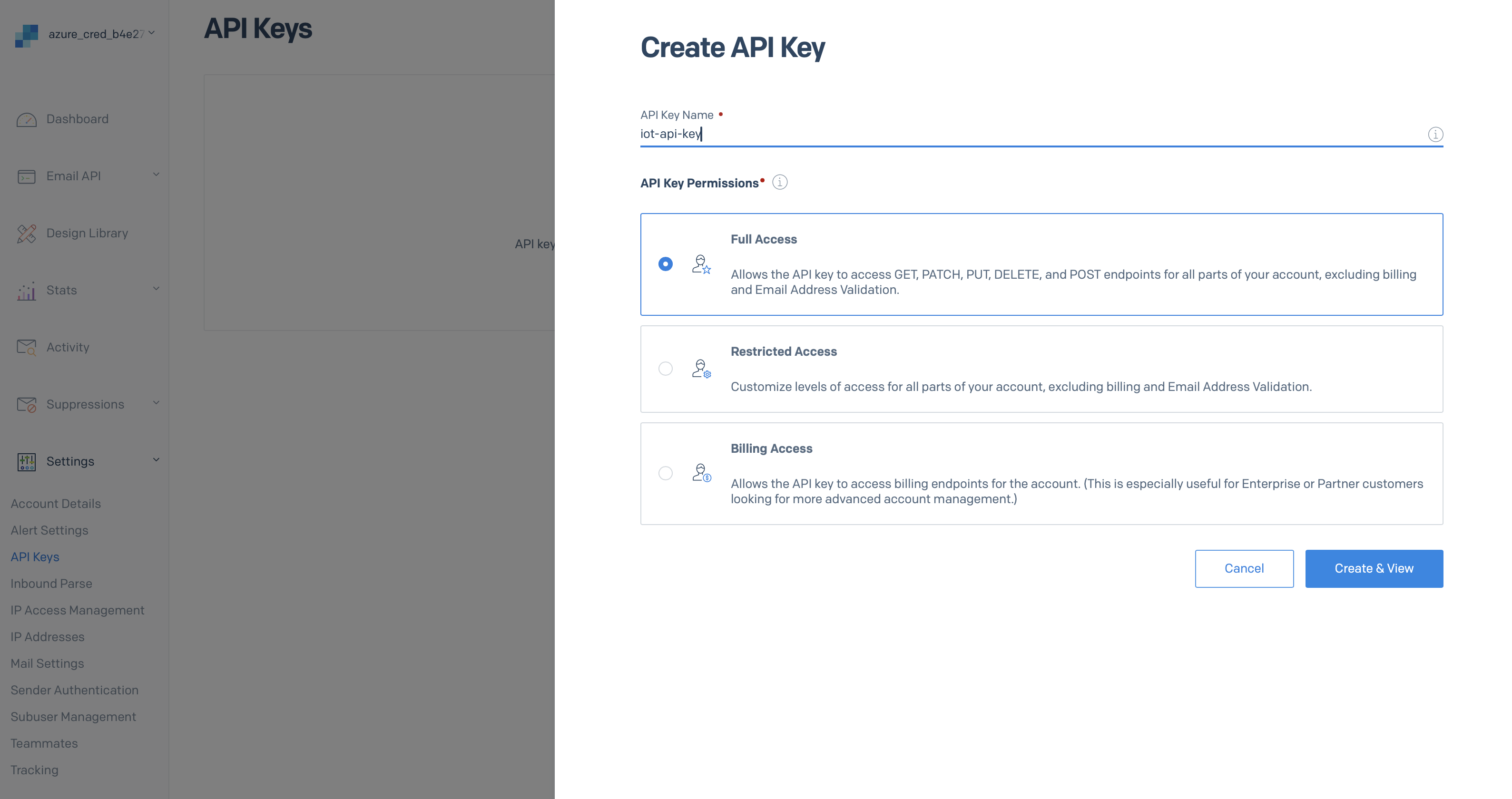

  5. After the sender identity is verified, click API Keys in the left menu: Image Alt Text:img34 alt-text
  6. Click Create API Key. In the popup window, enter a key name (e.g., iot-api-key), and select Full Access. Image Alt Text:img35 alt-text
  7. Copy the generated API key securely. You will not be able to retrieve it later.
