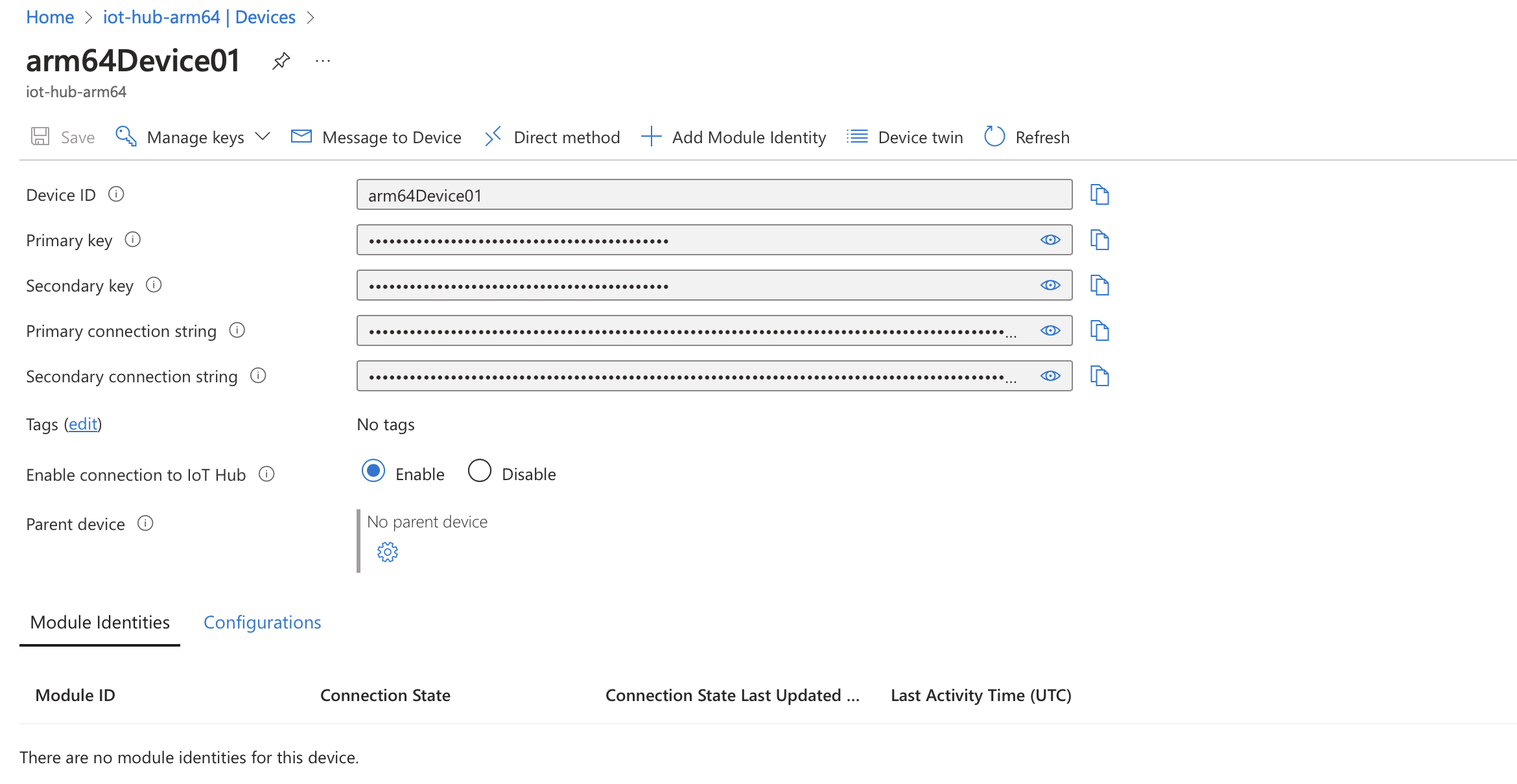

To connect the Python application you developed earlier to Azure IoT Hub, follow these detailed steps.
Ensure this connection string is stored securely, as it provides authentication credentials for your device.
In the next step, you’ll integrate this connection string into your Python simulator app, enabling secure communication and real-time data streaming to Azure IoT Hub.

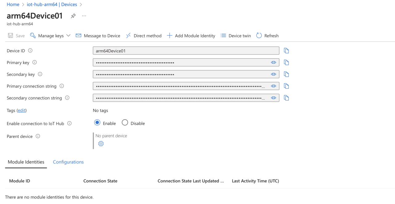

Now you’re ready to stream telemetry data from your Python application directly to Azure IoT Hub. Follow these steps to configure and run the application:
iot_simulator.py.
CONNECTION_STRING = "HostName=iot-hub-arm64.azure-devices.net<THE_REST_OF_THE_CONNECTION_STRING>"
Ensure this connection string exactly matches the string copied from Azure IoT Hub to establish a secure connection.
