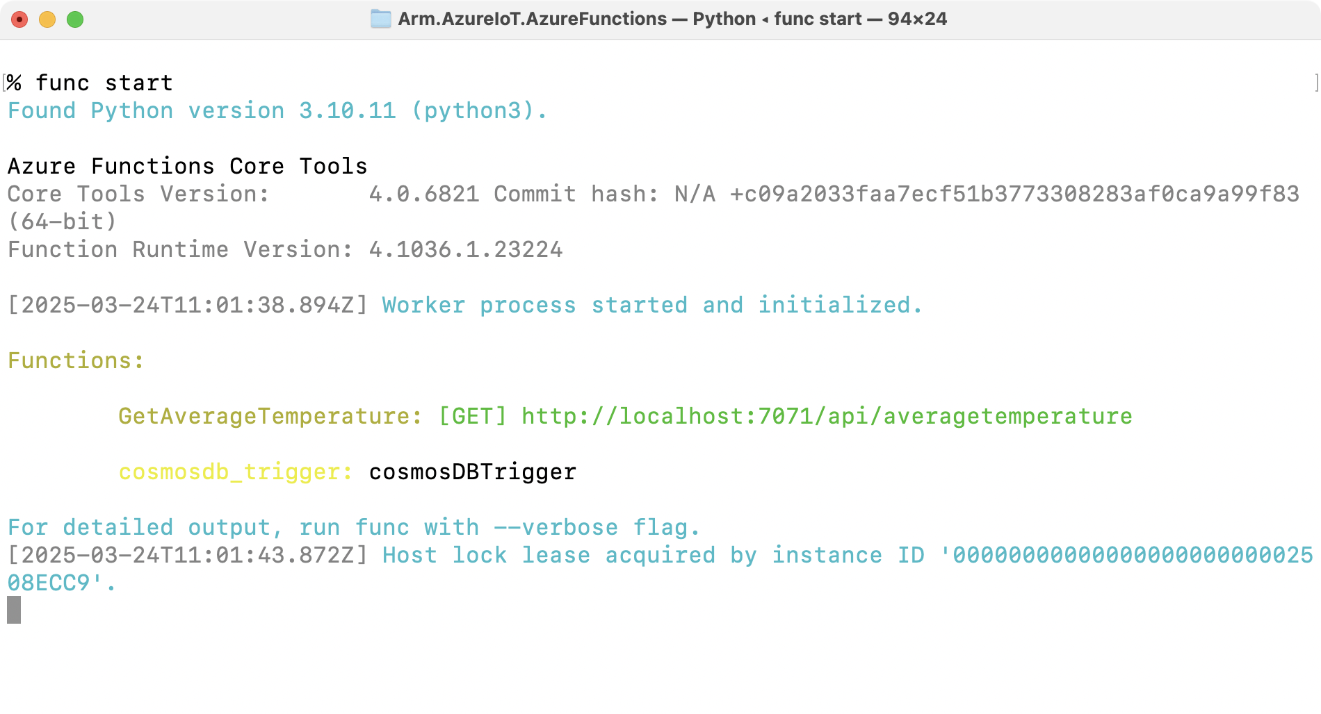

You are now ready to launch the function. Run the following command:
func start
Once running, observe the HTTP trigger endpoint, which should appear similar to the following: Image Alt Text:img36 alt-text

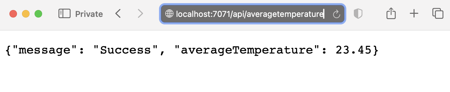

Next, start the simulator to stream sensor data and open the HTTP trigger endpoint URL in your web browser. You will see the calculated average temperature displayed: Image Alt Text:img37 alt-text

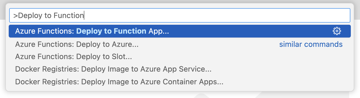

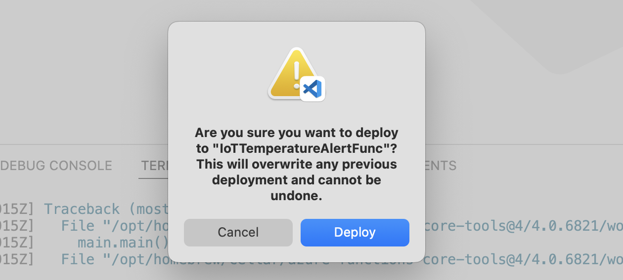

  1. In Visual Studio Code, open the Command Palette (Ctrl+Shift+P on Windows/Linux, or Cmd+Shift+P on macOS) and search for “Azure Functions: Deploy to Function App”: Image Alt Text:img38 alt-text
  2. The deployment wizard will guide you through the following selections:
  • Subscription: choose the Azure subscription you wish to use,
  • Select a function app: Select the Function App that you previously created in Azure (in this example, “IoTTemperatureAlertFunc”)
  • Confirm your deployment: Image Alt Text:img39 alt-text

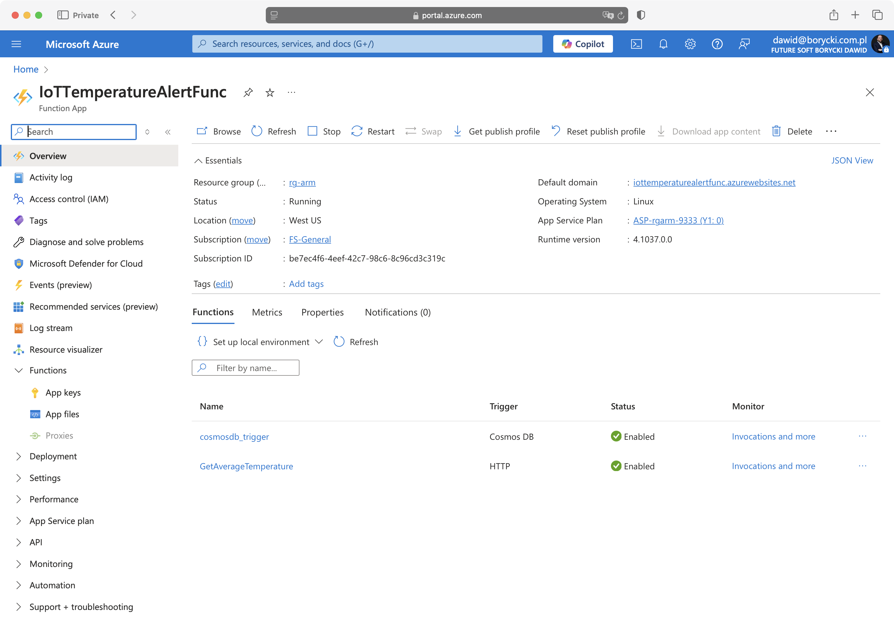

  1. Wait for the deployment to complete. This process typically takes a few moments. Once deployed, your Azure Function is hosted in Azure and ready for use.

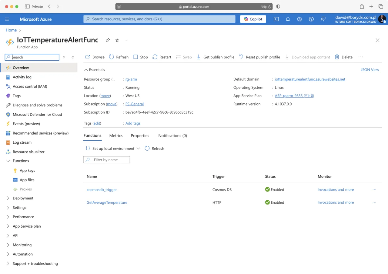

  2. Open the Azure Portal, and go to your function app (in this example, “IoTTemperatureAlertFunc”). You will see the deployed functions: Image Alt Text:img40 alt-text

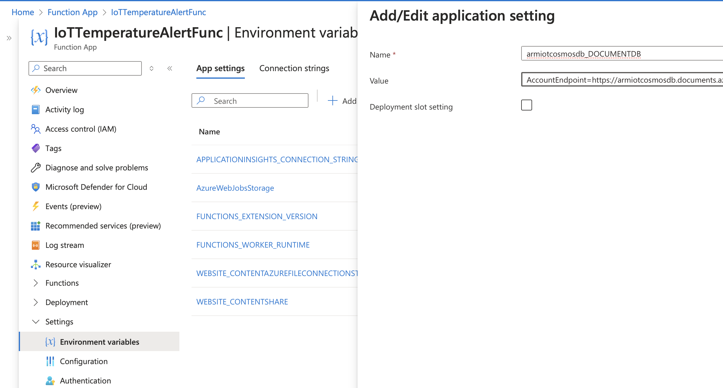

You have just deployed the functions to Azure. Previously, when testing the functions locally, you used the local.settings.json file to store the Cosmos DB connection string. However, this local configuration file is not deployed to Azure. Therefore, you need to update the corresponding settings directly within the Azure portal.
Azure Function App settings, which are also known as application settings or environment variables, are designed to securely store sensitive configuration information, such as database connection strings, API keys, and other confidential details. Storing the Cosmos DB connection string as an app setting in Azure ensures secure management of your database credentials, allowing your function to safely access Cosmos DB without exposing sensitive information within your source code.
Follow these steps to configure the Cosmos DB connection string
  1. In the Azure Portal navigate to Azure Function App.
  2. Click Environmental variables (under Settings).
  3. Click the + Add button.
  4. Enter the name you used in your code (such as “armiotcosmosdb_DOCUMENTDB”).
  5. Paste the Cosmos DB connection string into the Value field: Image Alt Text:img41 alt-text
  6. Click Apply to add the setting.
  7. Click Apply at the bottom to apply changes. Then, confirm to save changes

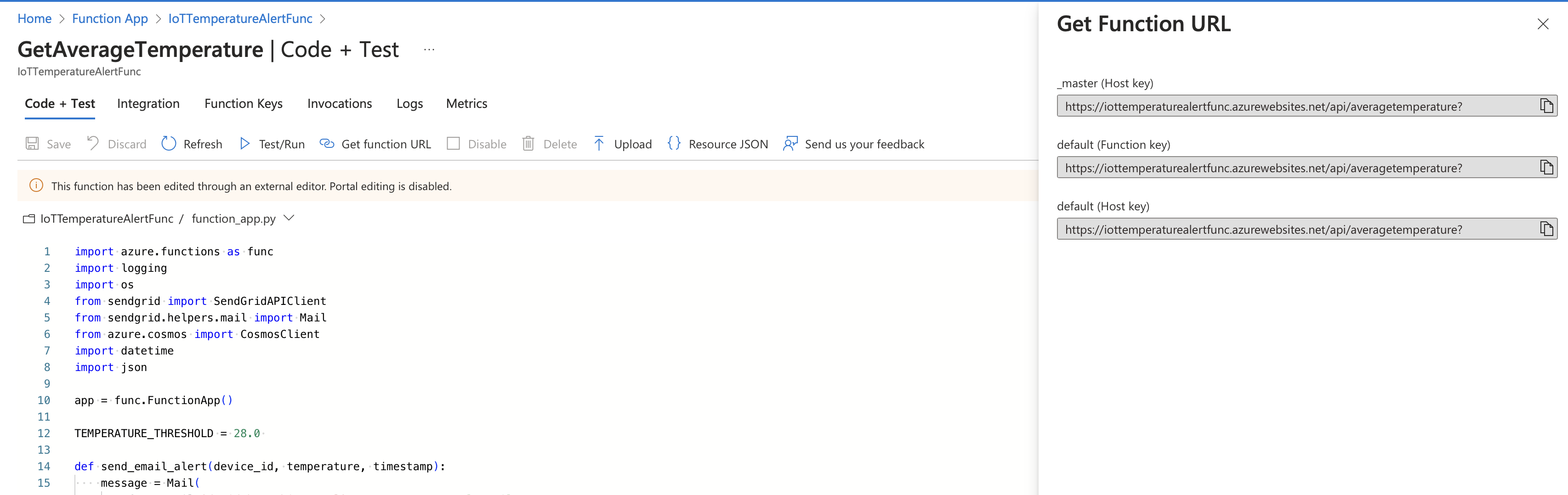

  2. Click on your HTTP-triggered function (GetAverageTemperature).
  3. Click Get function URL and copy the displayed URL (under default): Image Alt Text:img42 alt-text

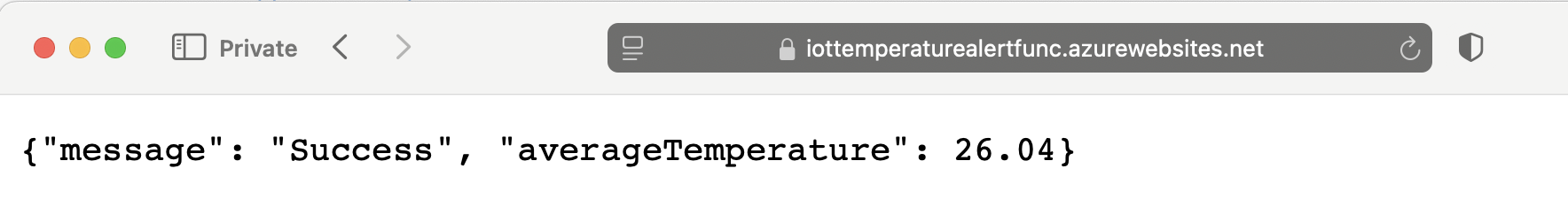

  4. Open this URL in your web browser.
  5. Start your IoT simulator to begin streaming telemetry data to Cosmos DB.
  6. Refresh or access the function URL again, and you should see the calculated average temperature displayed: Image Alt Text:img43 alt-text
This confirms your Azure Function successfully connects to Cosmos DB, retrieves real-time data, and calculates the average temperature as intended
