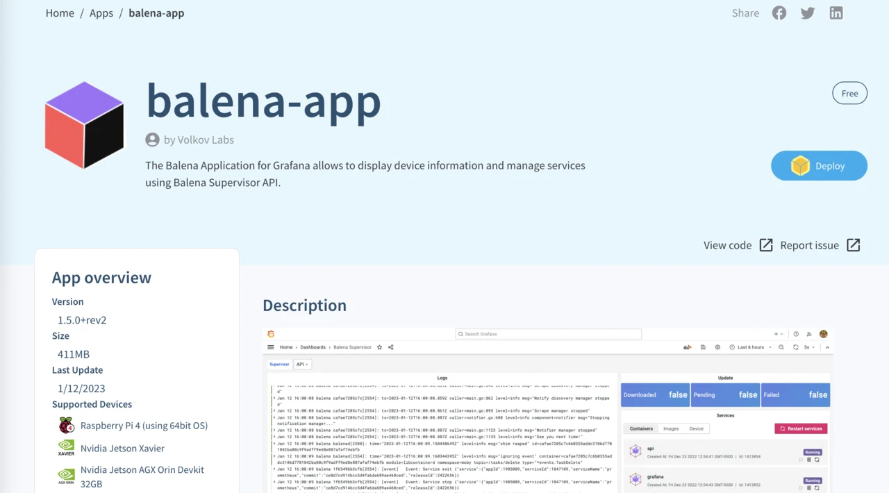

On the Balena Hub, click Apps in the top navigation bar, then search for balena-app. This is a pre-built dashboard backed by Grafana and served by Nginx.
Click on the app to open the details page.
Look for the Deploy button in the upper-right corner of the page.
Clicking this button will take you back to your Balena Cloud dashboard with a dialog to deploy balena-app to a fleet.
Select Use an existing fleet instead and choose the AVH-Testing fleet.
You don’t need to do any advanced configuration for this app. Click the Deploy to fleet button to begin the deployment.

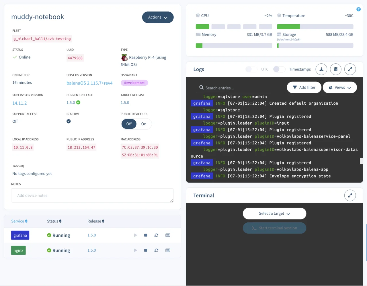

Once the deployment is finished, click on your device in Balena Cloud dashboard to open up the device page. You will see that the Grafana and Nginx services have been deployed to and are running on your device.
You will also be able to see the system logs from your device, and optionally get access to the device’s terminal from this Balena Cloud screen.
Your application is now running, but it’s not accessible from the outside world. In order to view your Grafana dashboard in your browser, you will need to tell Balena to make your device accessible from a public URL.
Toggle the Public Device URL switch to the On position.
A link will appear next to the switch, click on it to open the newly created public URL.
