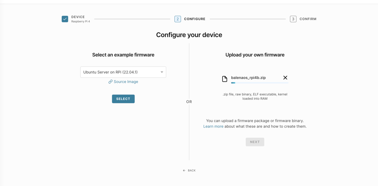

On the next screen you will be asked to configure your device by choosing the firmware to use.
Use the Upload your own firmwware on the right side to drag or browse for the file balenaos_rpi4b.zip.
Image Alt Text:upload custom firmware screen
Uploading the file takes some time.
After the file is uploaded, click NEXT.

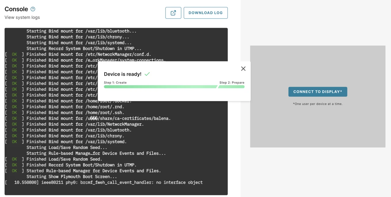

Wait for the device to be created. It is ready to use when you see the ready message:
Image Alt Text:device ready
Verify your device is ready
You now have access to the console and be are presented with a log in prompt.
Log in with the username root. If a password is required, use balena.
