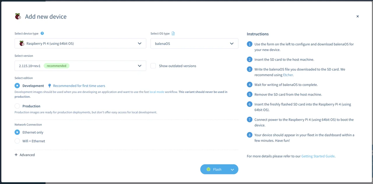

Add a device to your fleet. Navigate to the Devices section of your fleet and click on the Add Device button. This will open a dialog to create a custom device image.
Image Alt Text:Add Device dialog window
You can use the Raspberry Pi 4 device on Arm Virtual Hardware (AVH) as the new device.
Select Raspberry Pi 4 (using 64-bit OS) as the device type.
Select Development for the edition.
Leave the default values for everything else.
Download the image by clicking on the drop-down arrow on the right side of the Flash button and select Download balenaOS.
