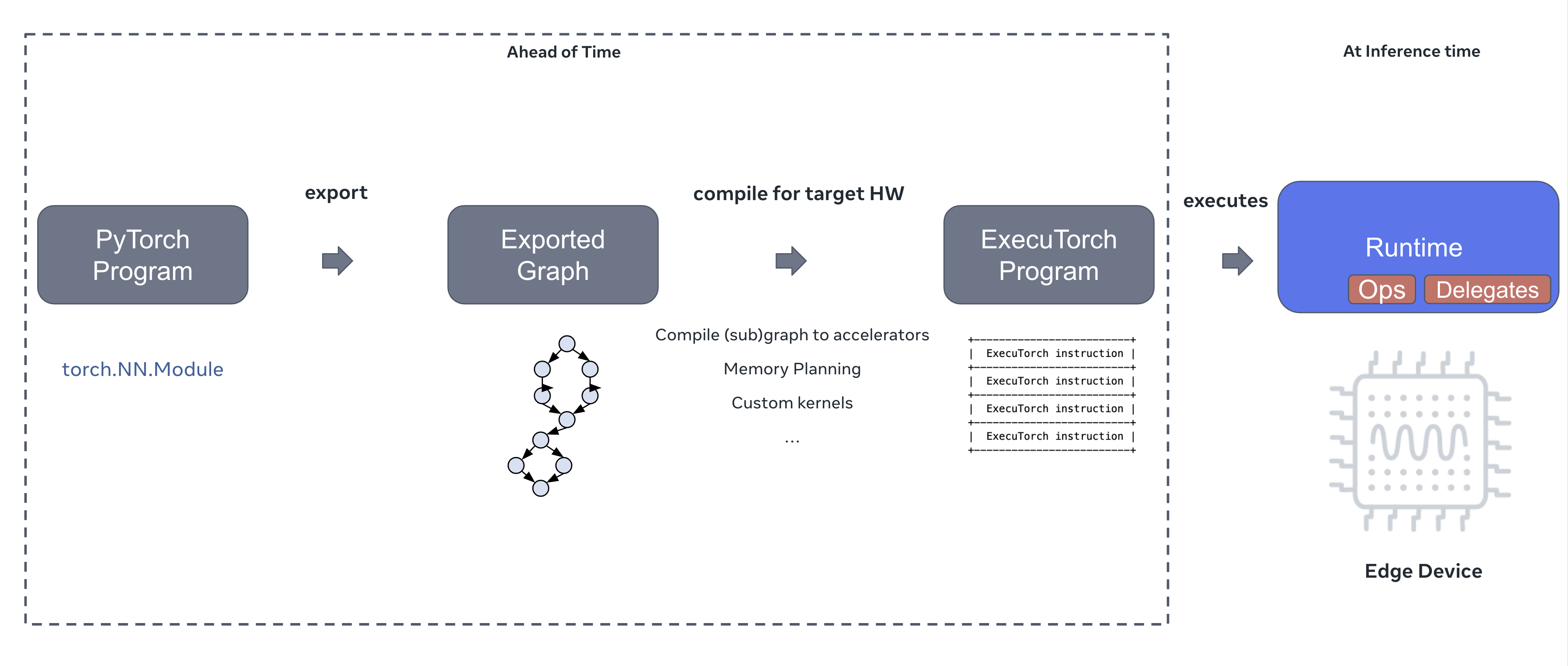

The diagram below summarizes the ExecuTorch workflow from model export to deployment. It shows how a trained PyTorch model is transformed into an optimized, quantized format and deployed to a target system such as an Arm Fixed Virtual Platform (FVP).
.pte file ready for deployment.This three-step workflow ensures your TinyML models are performance-tuned and hardware-aware before deployment—even without access to physical silicon.
The three-step ExecuTorch workflow from model export to deployment
