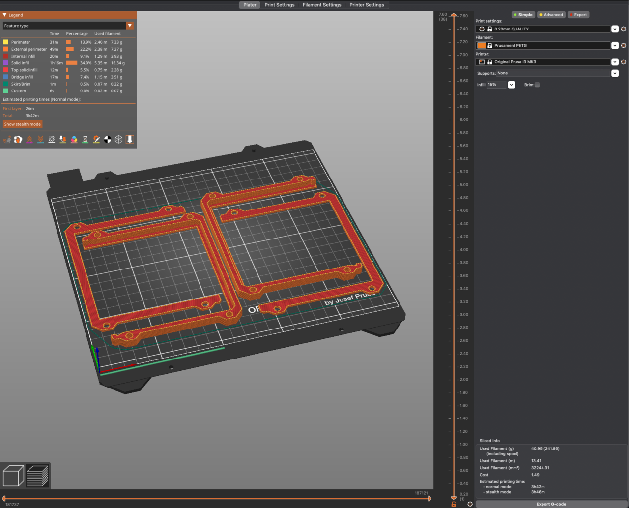

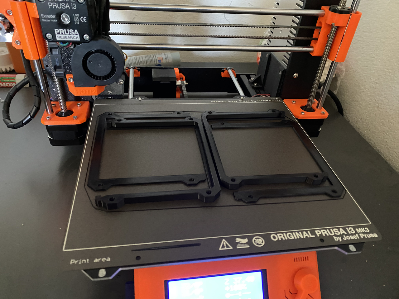

Slice and print
General printing instructions are provided. The exact steps differ based on the printer and slicing software.
You can experiment with the quality settings. The parts are not complex shapes, so you can use thicker layer lines for faster printing.
- Add multiple parts to your build plate
- Rotate and move as necessary to fit as many on the build plate at a time as you can
- Select a quality setting. 0.20mm is a good starting point, but experiment as needed
- Select PETG as your filament
- Slice and export G-code using your slicing software
